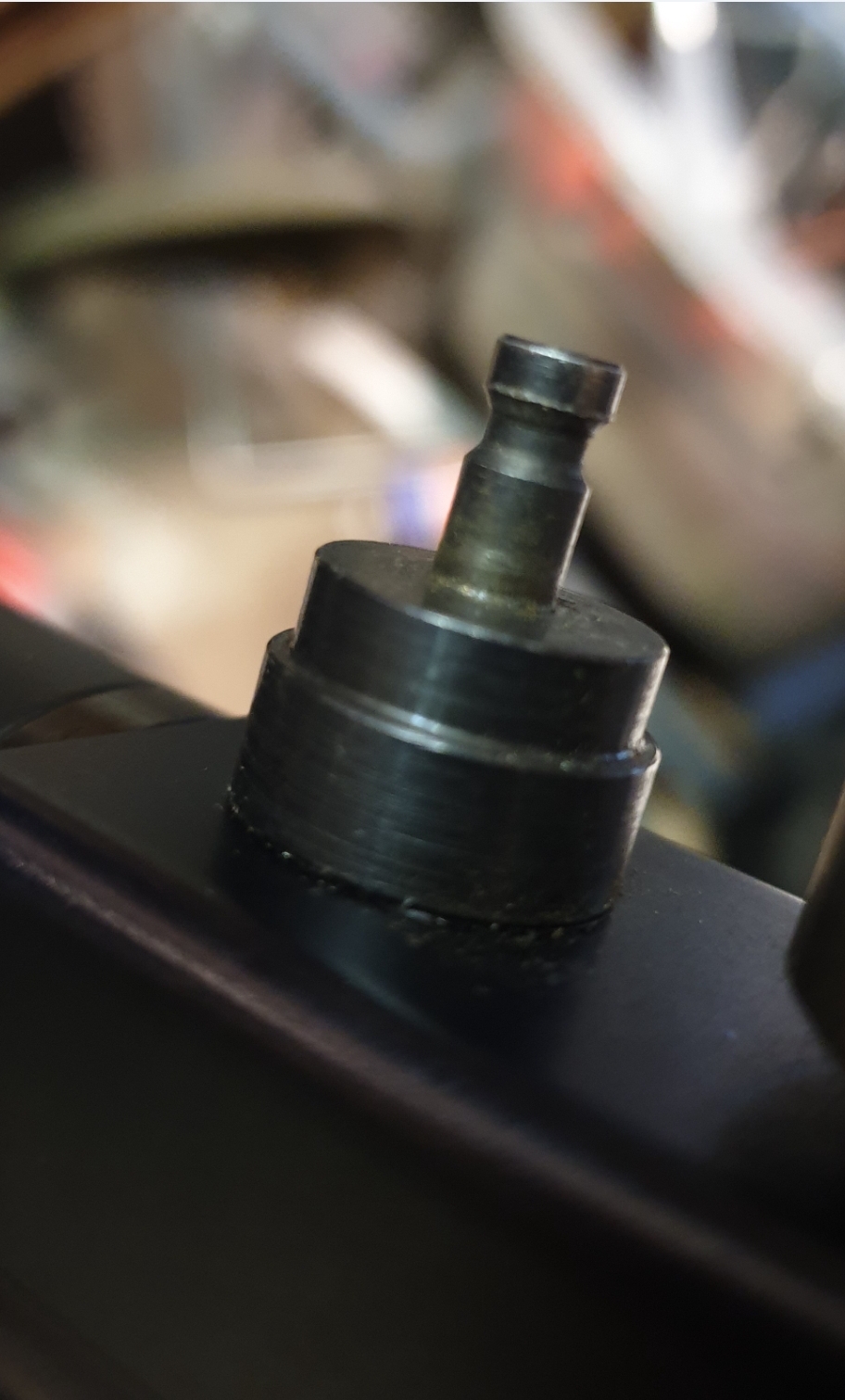

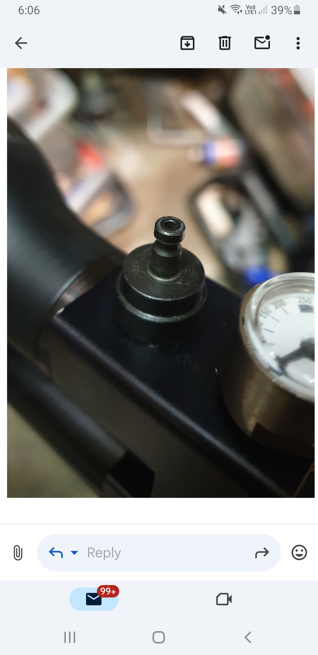

First time PCP owner! Can anyone please advise what kind of fitting is needed to fill this type of air fitting please?

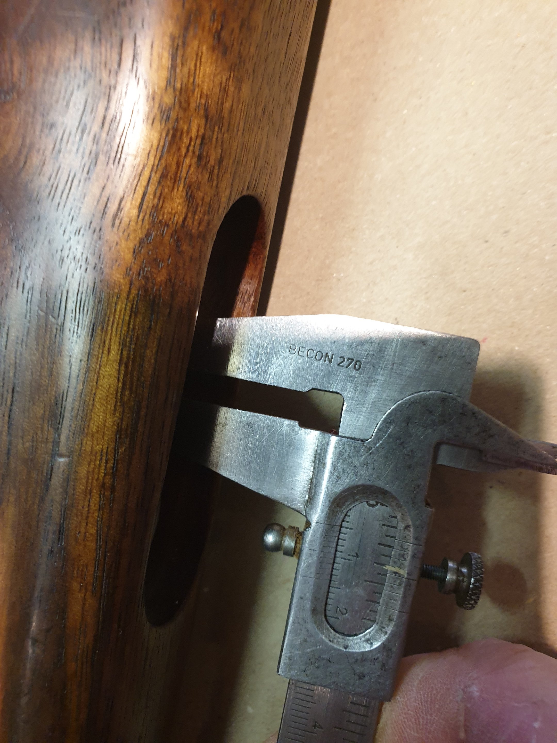

Really appreciate that ! Will run a measurement and let you know Thanks once againExtremely similar to the ones kral copied from evanix when designing their guns. I have several new spares. Happy to send you one to try. Free plus shipping. Measure the diameter of the top section. I'll verify it matches prior to even worrying about getting you one. I tried to make the picture the same size on my screen and when I lay the kral fill nipple it looks like a nearly exact fit.

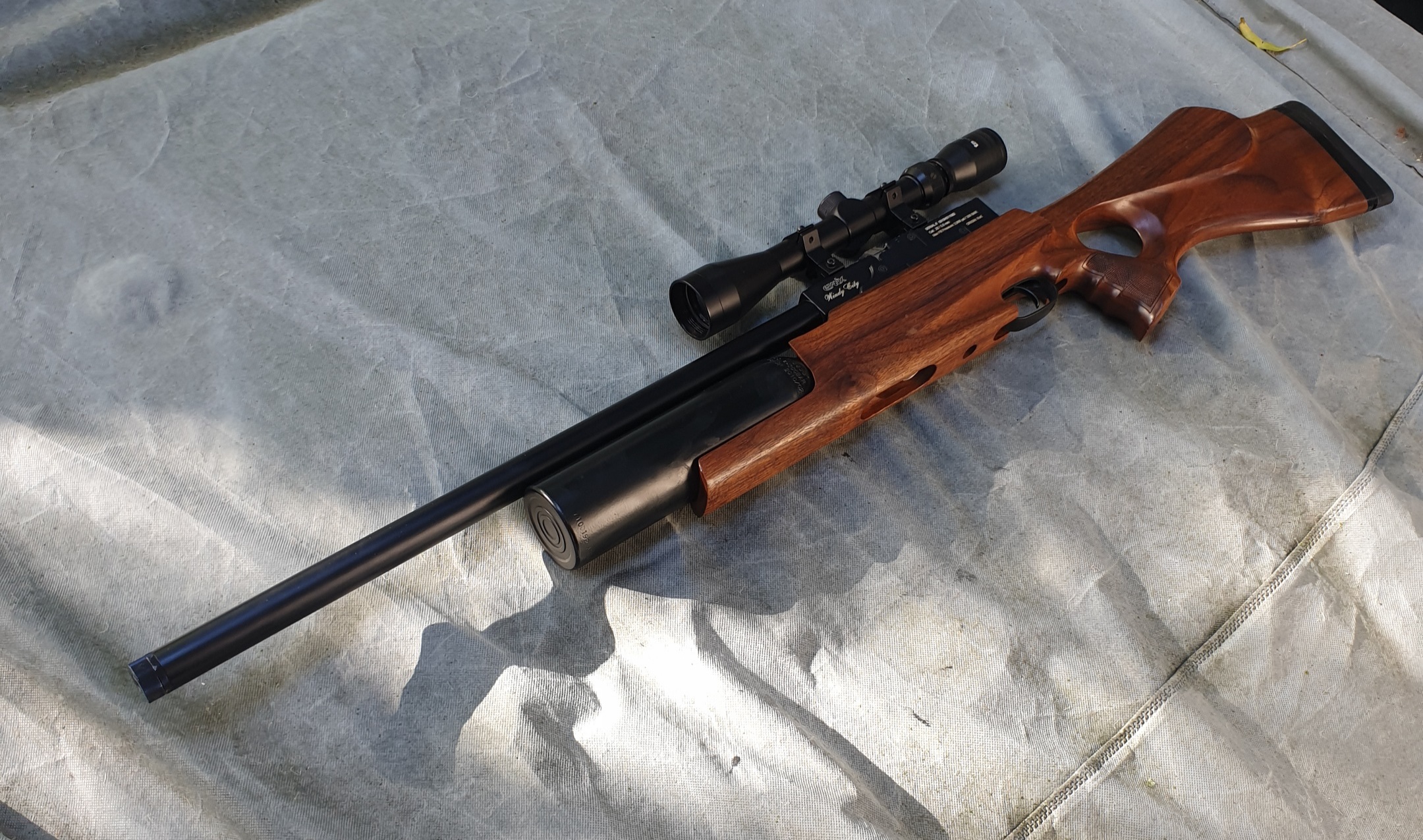

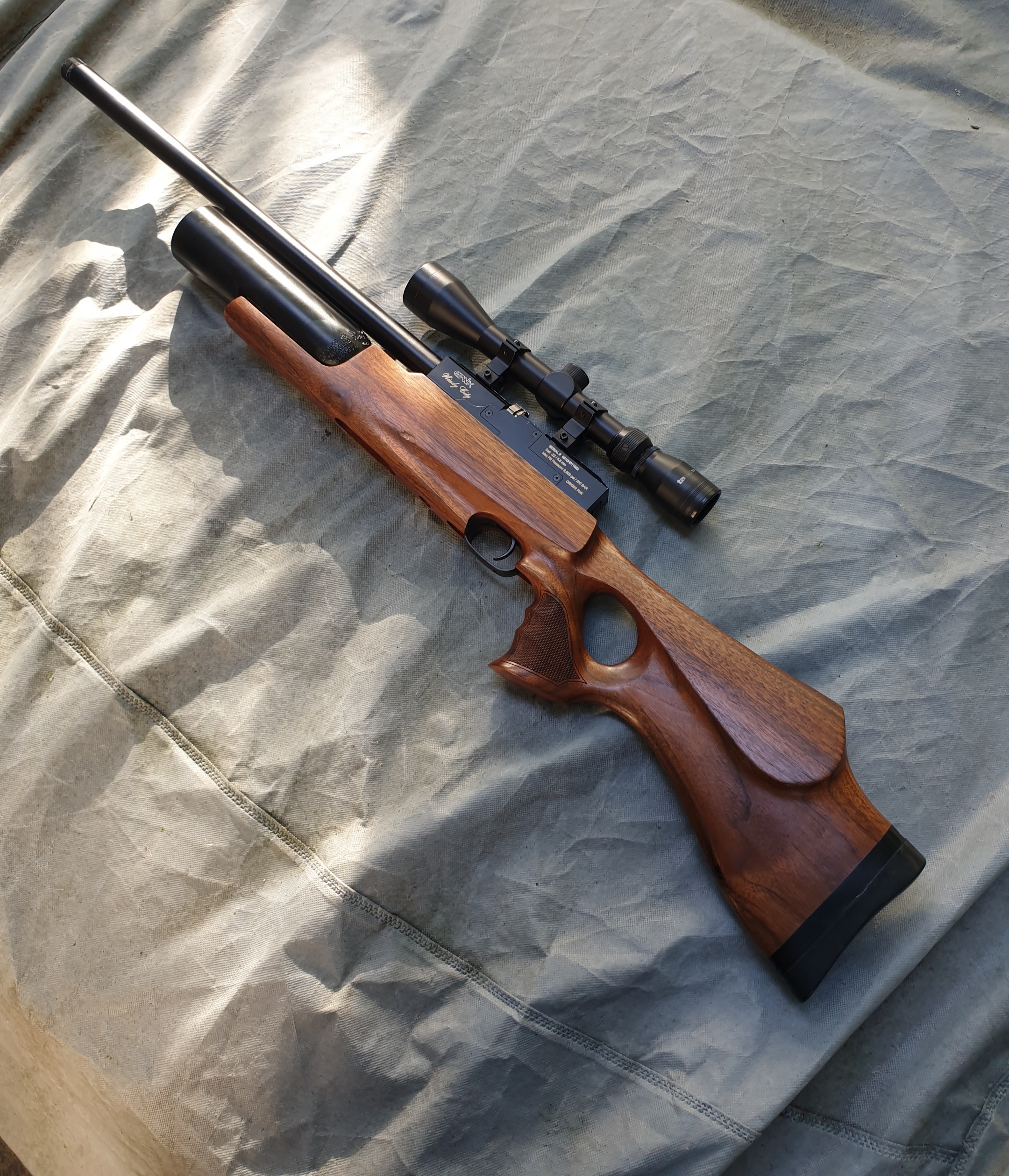

That must be an early model. I would try one of the low cost foster QD fittings from amazon. The odds of you finding an original is very slim. Can you post a pic of the entire rifle? Curious about what version you have.
Manloney LLC Universal 8mm Foster Quick Disconect 1/8 BSPP Male Thread Female PCP HPA Plug Adapter Paintball Charging Fittings: Amazon.com: Industrial & Scientific
Manloney LLC Universal 8mm Foster Quick Disconect 1/8 BSPP Male Thread Female PCP HPA Plug Adapter Paintball Charging Fittings: Amazon.com: Industrial & Scientificwww.amazon.com
Thanks very much! Can I get your advice please! The tank touches the barrel every so slighty Should I put a small piece of felt between the barrel and tank ?Good looking rifle. Had one a few years ago. Sold it off to fund another. They are good shooters , once you get it figured out get yourself some Seneca 28 grain pellets ( assuming it’s .22 caliber) they love them.
I wouldn’t use felt that would more than likely cause inaccuracy. Any chance the barrel shroud is off centre?Thanks very much! Can I get your advice please! The tank touches the barrel every so slighty Should I put a small piece of felt between the barrel and tank ?
BTW Dont think we can get those pellets in Australia Shame
