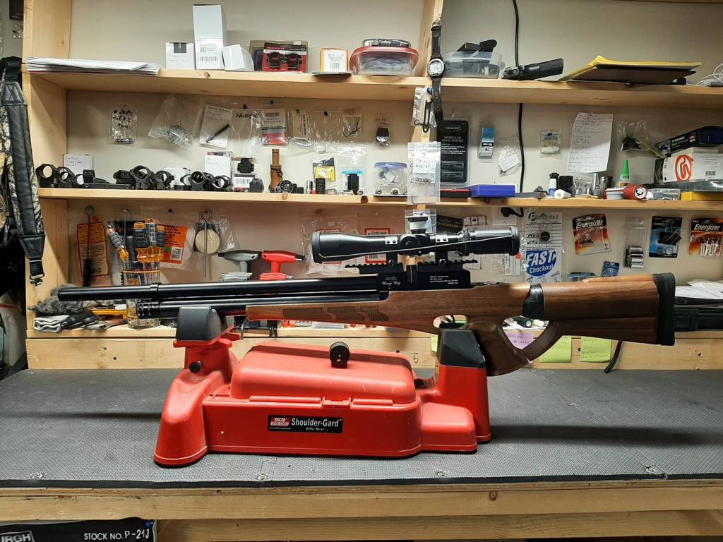

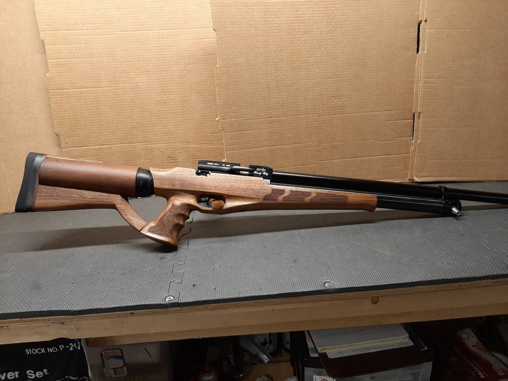

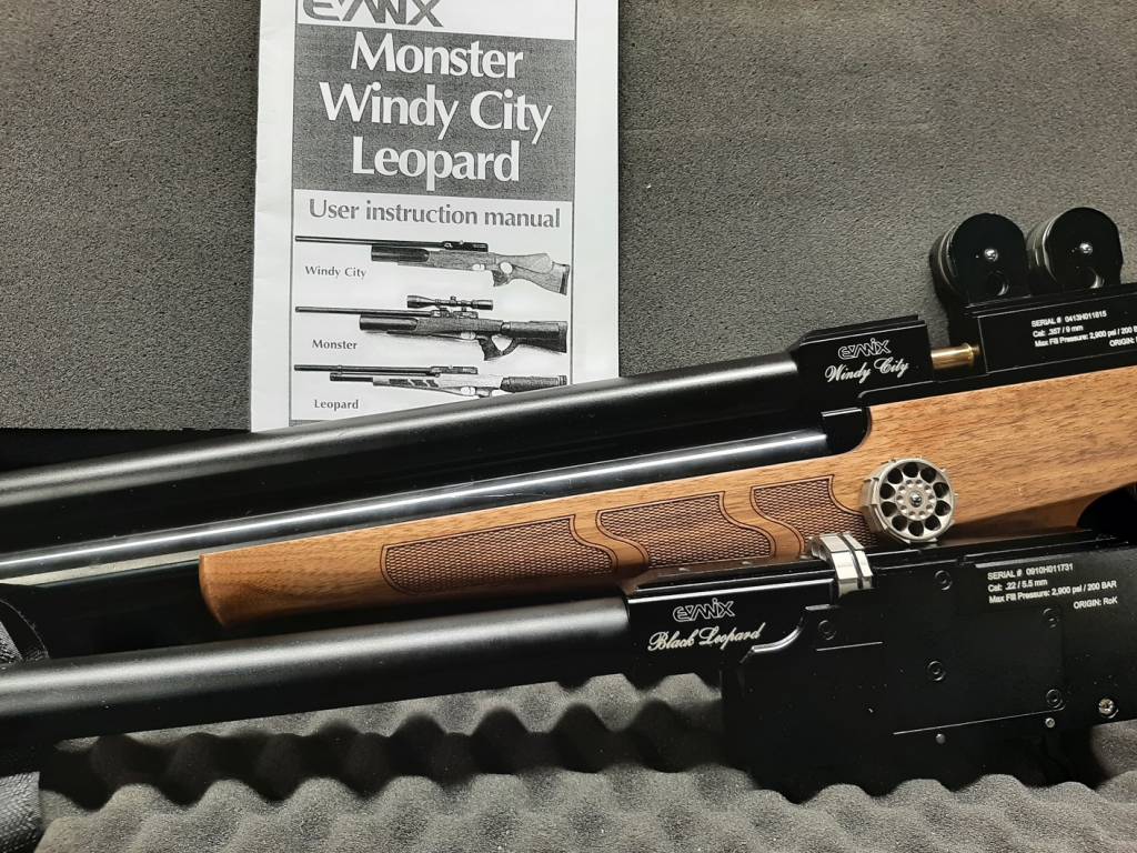

Hello everyone just had to share my new hybrid built by Boris it started as a Black Leopard 22 dual tank and Boris put a Windy City 9mm in it's place but I have the option to change it back if I want, I was able to get it scoped but the weather hasn't been nice enough for me to get it out to shoot so I'll have to get back on here when it does but I just had to share a couple of pics.
Airgun-hobbyists
My thinking is higher shot count because it original came out in .177 and .22, I was talking with Boris about it in 9mm for extra shot count an he told me he could put the windy city 9mm on it, what I've read the 9mm suppose to push a 81gr pellet at 844fps for 123fpe+- maybe I'll try shooting out of my garage door so I can get some chrony data.

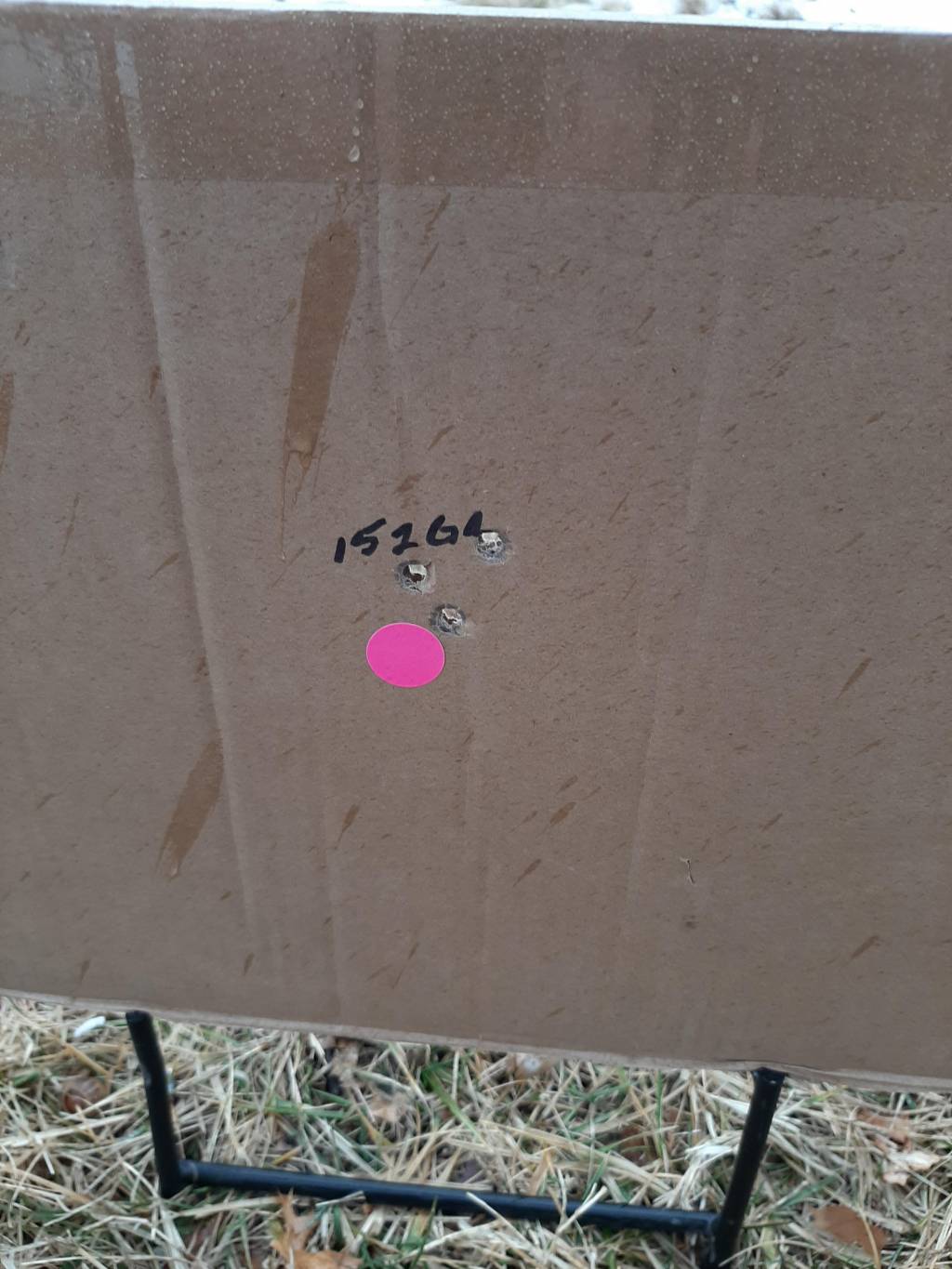

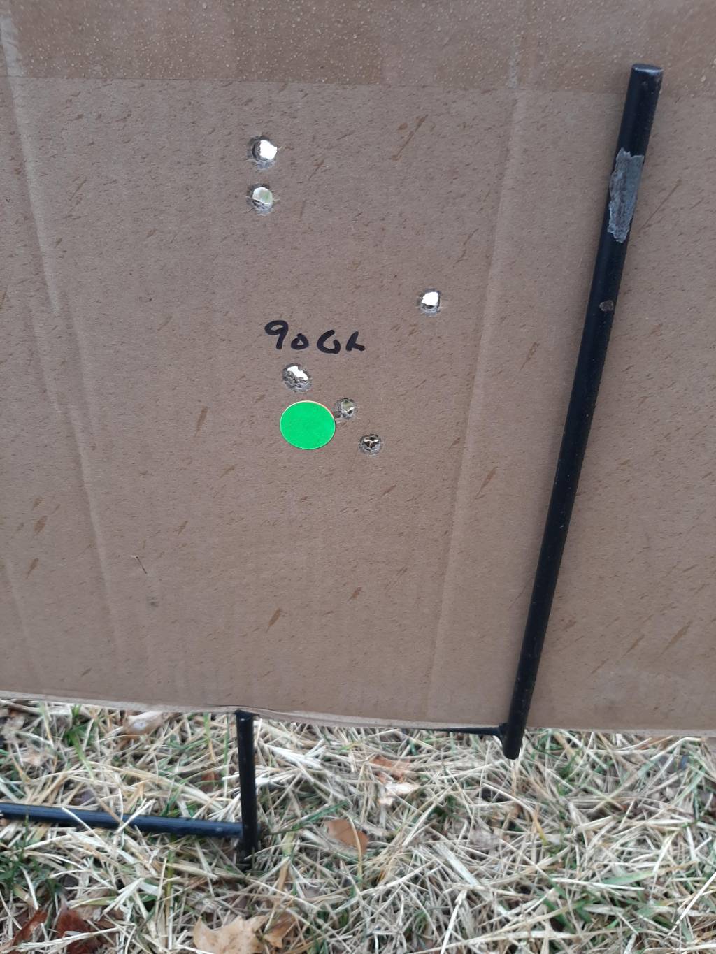

Finally got to do some shooting with this bad boy yesterday the weather had been so crappy so the rifle is at stock factory settings, I plan on trying to turn in the hammer spring today to see if I can get the power level bumped up some, the accuracy was good with JSB 77.62 at 25 yards I tried some 90gr cast and 152gr cast bullets the 90gr did good the first 3 shots I pulled one low right an the next 2 went high and then a high right? the 152gr grouped good but I only got 1 reading from my FX chrony because of low fps, here's what I got.
JSB 77,62 19 shots 90gr cast 7 shots 152gr HP cast 3 shots 160b
H-770 200b 102fpe H-724 200b 102fpe 547fps 101fpe
L-761 150b L-714 160b
Avg-767 Avg-719
Sprd-9.0 Sprd-10.0
StdD-3.0 StdD-3.0
