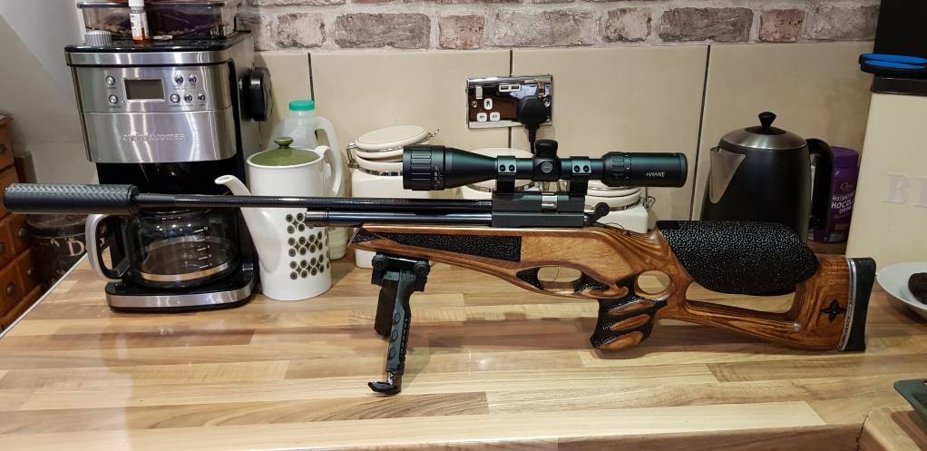

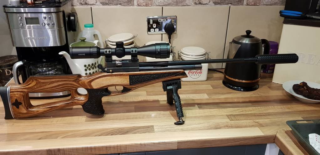

Evanix ar6 modified
Reactions: Scotay42
Hi
No regulator just original tube
I'm going to put a bottle on like crosman conversion as air cylinder is so small so it will be regulated by the bottle as this is the old version ar6 and air tube is an odd ball size
I now have all parts to convert it over and will regulate it around 1300 psi with lighter springs and diy poppet valve Trigger is very stiff in double action and quite sharp edges on the blade itself that need rounding off so when all done it should be easier to fire but keep the power . When it's done I shall put the pics up
Gun is very quiet with hugget silencer and longer barrel and also very light with laminate stock
