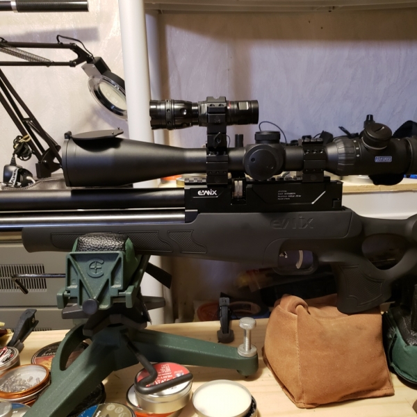

Now for the rifle - Fit and finish are very good just remember this rifle is not distributed by Evanix with a wood stock at this time. JSAR does offer a boyd's sood stock as an add on option for those of us that prefer furniture with our toys. The semi automatic feature is unique and works without a hitch (Travis recommends that you lube the pellets to facilitate the pellets feeding into the breech). After over 500 pellets sent down range all I can say at this point is wow this rifle is fun to shoot and the accuracy is surprising. At 25 yards I am able to drill a single ragged hole the size of a 1/2 dollar in less than 30 seconds. Remember semi automatic feed so no recocking after each shot, this makes for easy follow up shots with no more delay than take the next breath, aim and fire you do not lose your sight picture after each shot so there is no time wasted reacquiring the target. I will post a couple shot strings very soon since I am extremely curious with shot to shot consistency.

Caliber is .25 no LDC yet probably will add a Neil Clague soon. The trigger is a little heavy and but not terrible I will measure the trigger after things have broken inn a little more. The trigger is not gritty just heavier than some of my other PCP's ie; my RS II from Evanix. I am shooting the Air Arms 25.4 gr Diabolo pellets with the best accuracy of all the .25 pellets I have shot so far. Surprisingly the H&N Grizzly shot with good accuracy at 25 yards. When the weather improves I plan to go to the Brookhaven AG range to do some 50 and 75 yard tests. My scope is a Hawke 6x24x50 AirMax with low double strap Weaver rings with Weaver rail on top of the ring to mount my red flashlight
Just took 5 shots with the trigger pull gauge and the average trigger weight for the 5 shots was 3lb 9.1oz For a match rifle this would be excessive but for a pest and plinking rifle it is not terrible . I will put a little dry lube into the action and give it at least 2 more tins of pellets before I open the trigger assembly to polish the contact points
