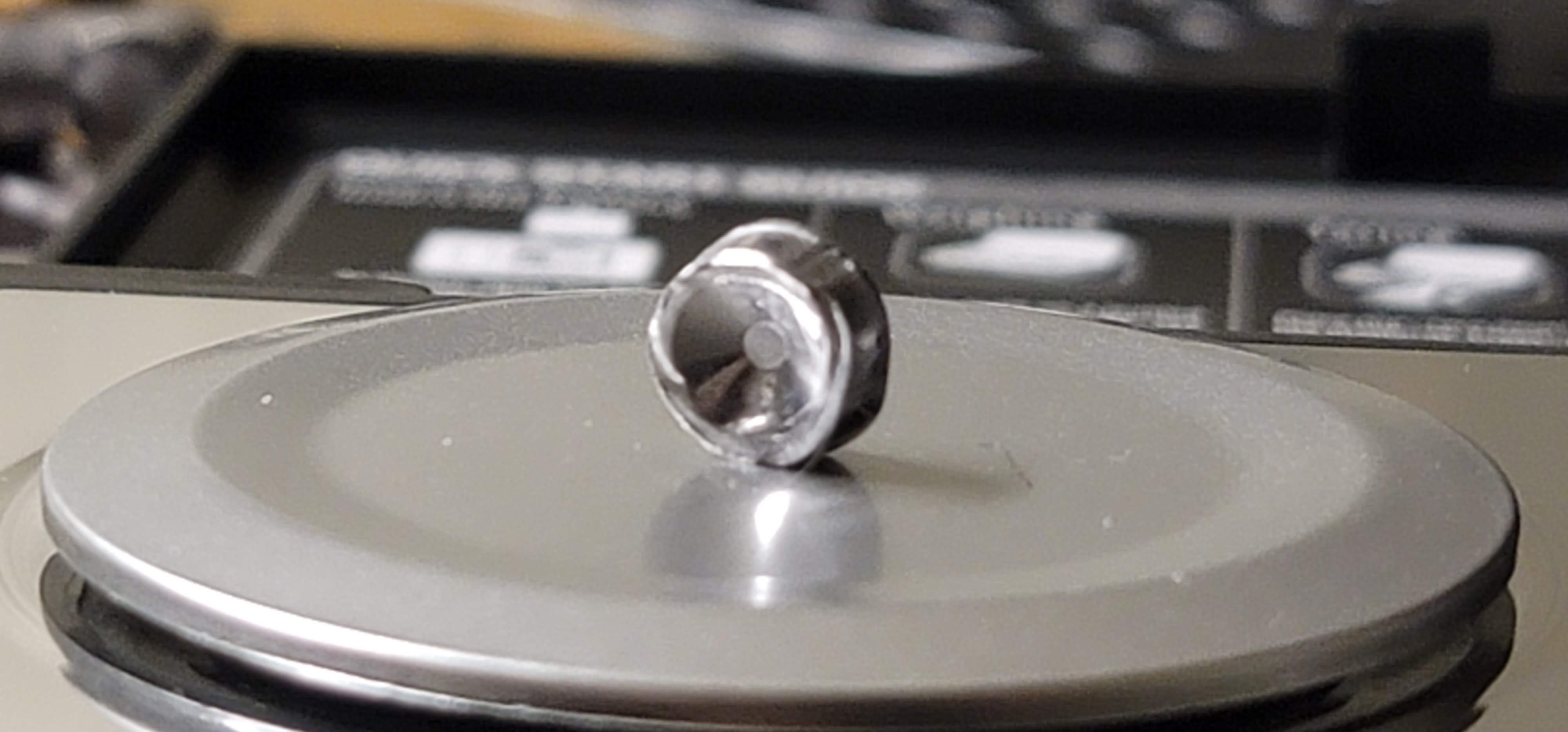

As contrary as this may seem, there is a big difference in penetration due to ammo designs. An ammo with immediate expansion will make a larger wound channel, but it may be too shallow to get to the vitals. Another ammo may have a similar amount of expansion, but it may expand more slowly, allowing deeper penetration and adequate terminal penetration depth. Some ammo may not expand one bit, nevertheless it assures deep penetration to get to the vitals from any angle, including the Texas Heart Shot. As you familiarize yourself with your ammo you will learn where it's limitations are. I am a big fan of FX Hybrid Slugs, but as much as I love them, I don't think they are a good .30cal round in a 100fpe airgun taking a Texas Heart Shot because this is what I pulled from ballistics gel at 8 inches:
View attachment 334394View attachment 334395
The ammo failed to remain in tact, and I'm certain penetration would have been even less if it hit the skeletal system upon entry. This is where I need ammo like the ARG, NSA, Javelin or JSB Knockouts as they would expand, but never separate from itself as it traverses the game. But you know where this ammo excels at, when you want to ensure you don't have excessive over-penetration, like shooting at a farm permission, or in residential areas.

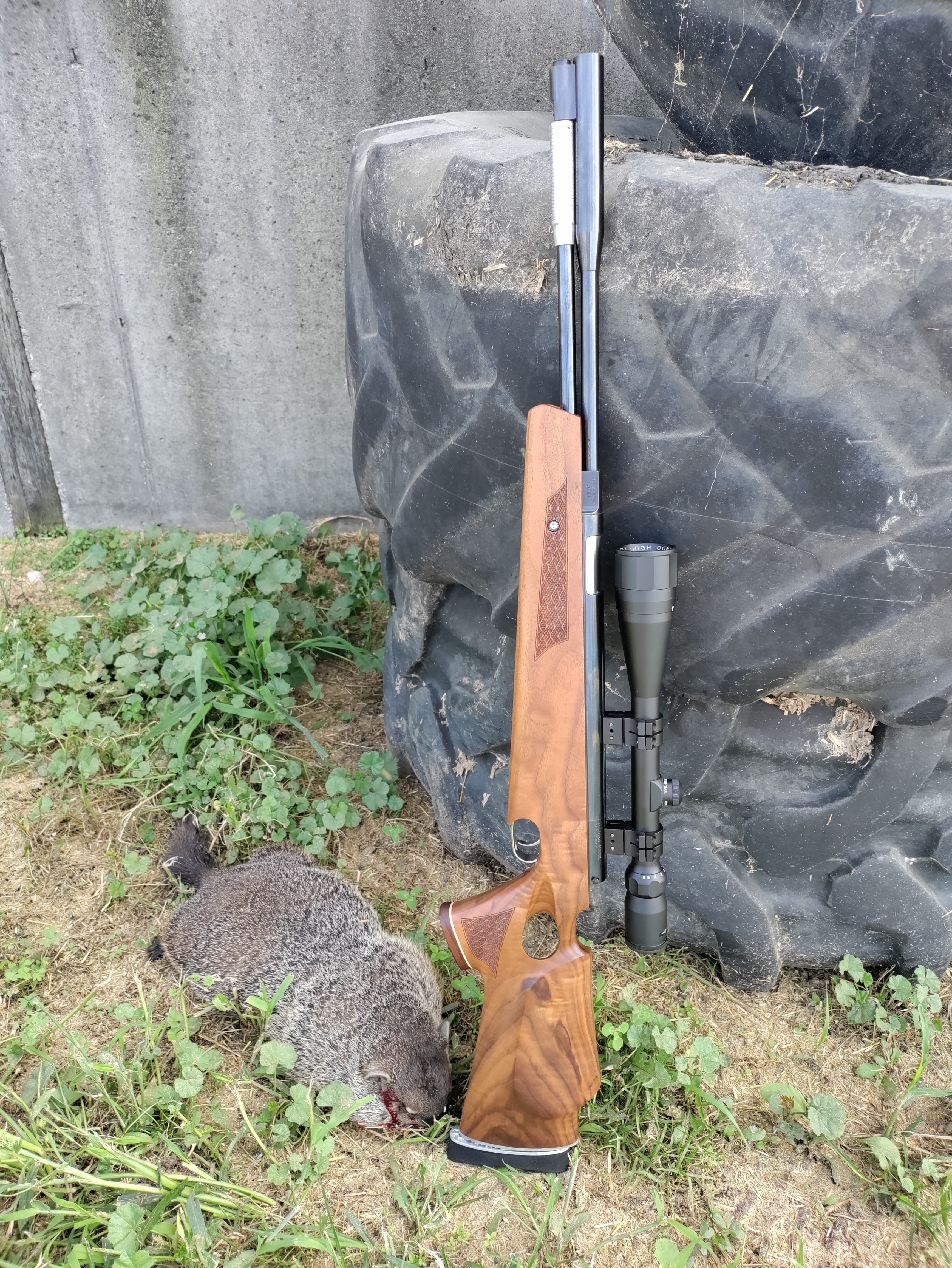

I’ve taken a couple with a 177 TX200HC. Ethically? When you are underpowered, which is in a lot of cases with backyard airguns shooting larger critters with an incredible will to live, ethical lies in the shooter’s abilities and patience to make the proper shot. If the shot isn’t perfect and you squeeze one off anyway, that’s not ethical no matter what gun you’re using. That’s just trying to get lucky at the animal’s expense.
