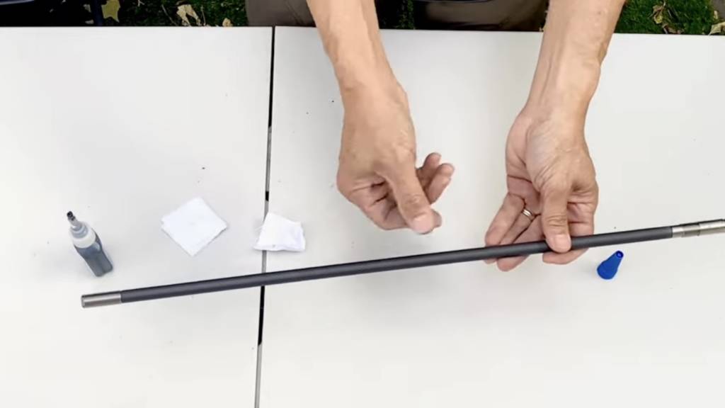

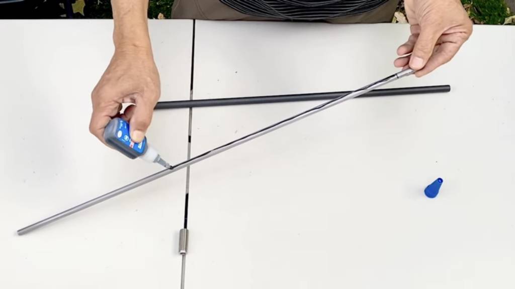

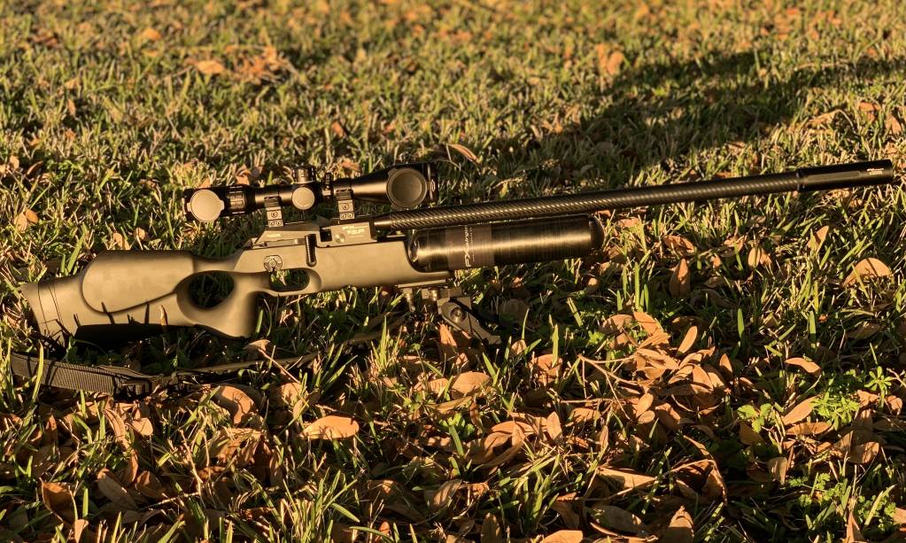

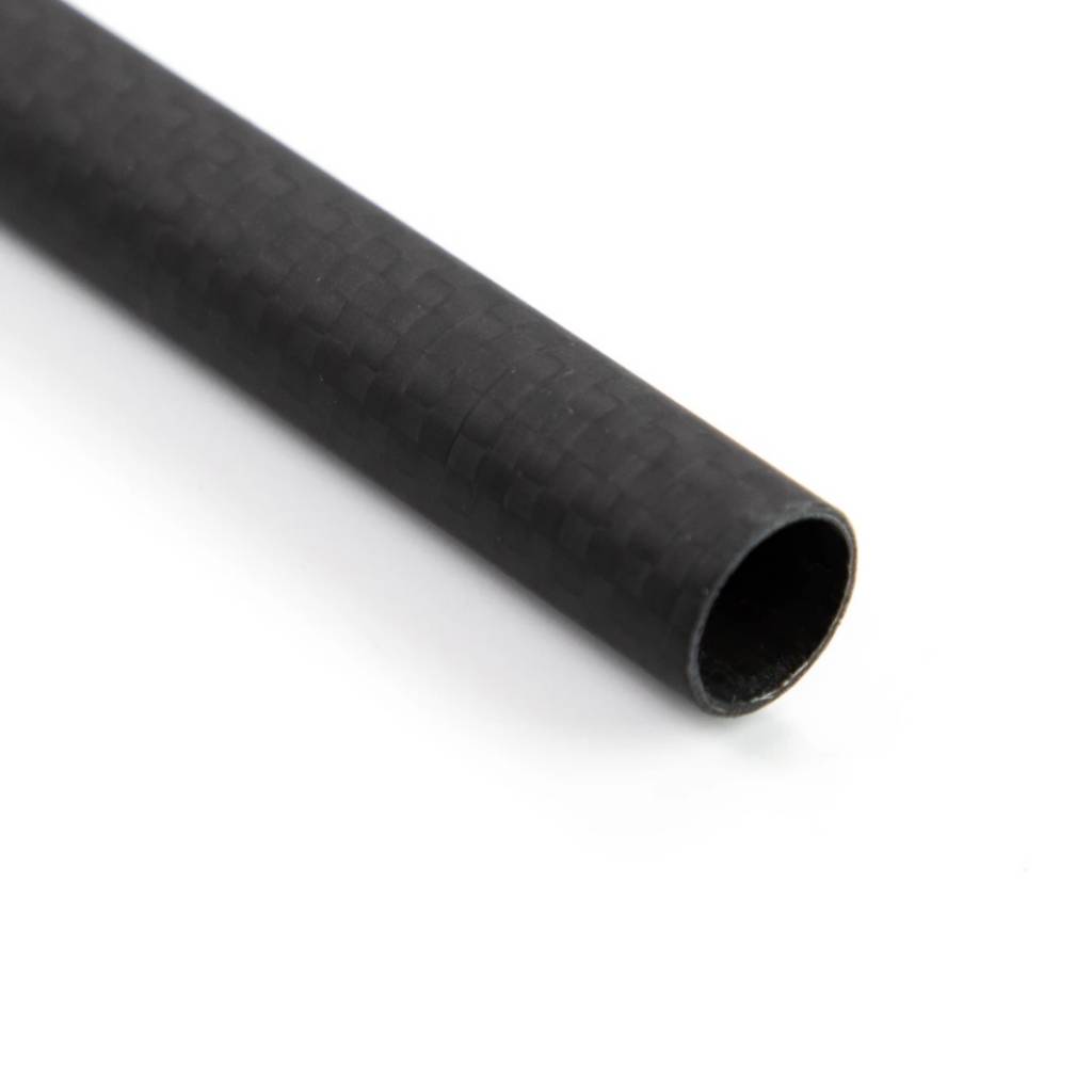

A couple of days ago I installed Ernest Rowe’s Carbon Fiber STX Liner Sleeve on my MKI Gen-2 FX Crown .25 caliber. Following his installation video here:
https://youtu.be/G5eaFA4iqno
Giving the new CF Sleeve 24 hours to cure to my Crown’s 600mm Standard Superior STX Liner after installation. I then re-installed the liner and re-zero’d my Crown @ 25 yards.
My FX Crown .25 when adjusted to these settings power wheel .25/.30 and hammer spring tension on “MAX” is power-tuned to shoot JSB KING HEAVY PELLETS 33.95g @ an average of 954 FPS / 68.62 FT-LBS. The NSA HP 33.5g SLUGS from my Crown shoot @ 944 FPS / 66.30 FT-LBS. on the same settings.

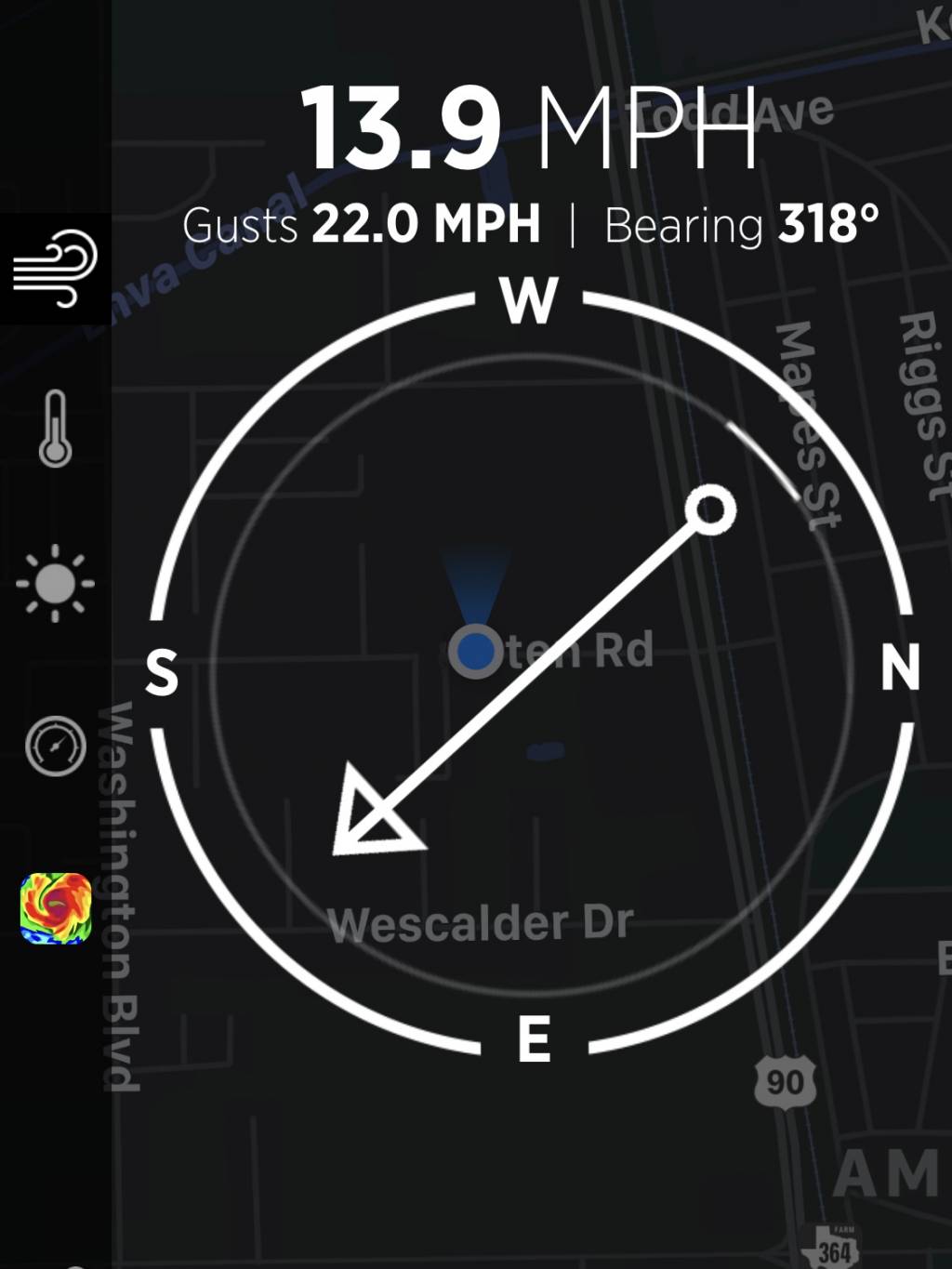

Today was a nice but windy day.
(aka piss-poor and gusty)

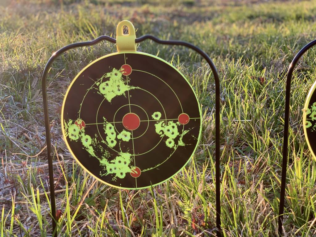

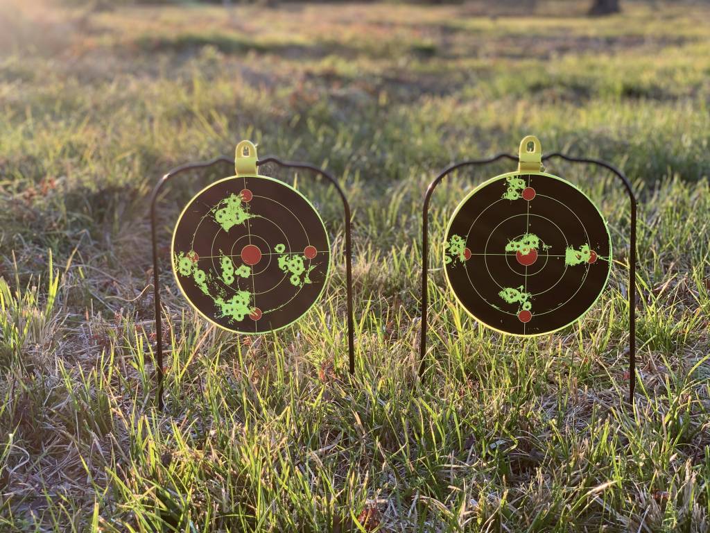

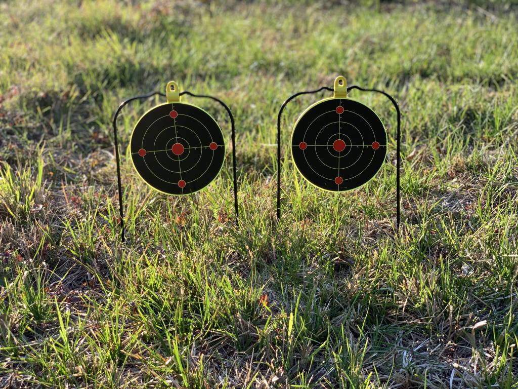

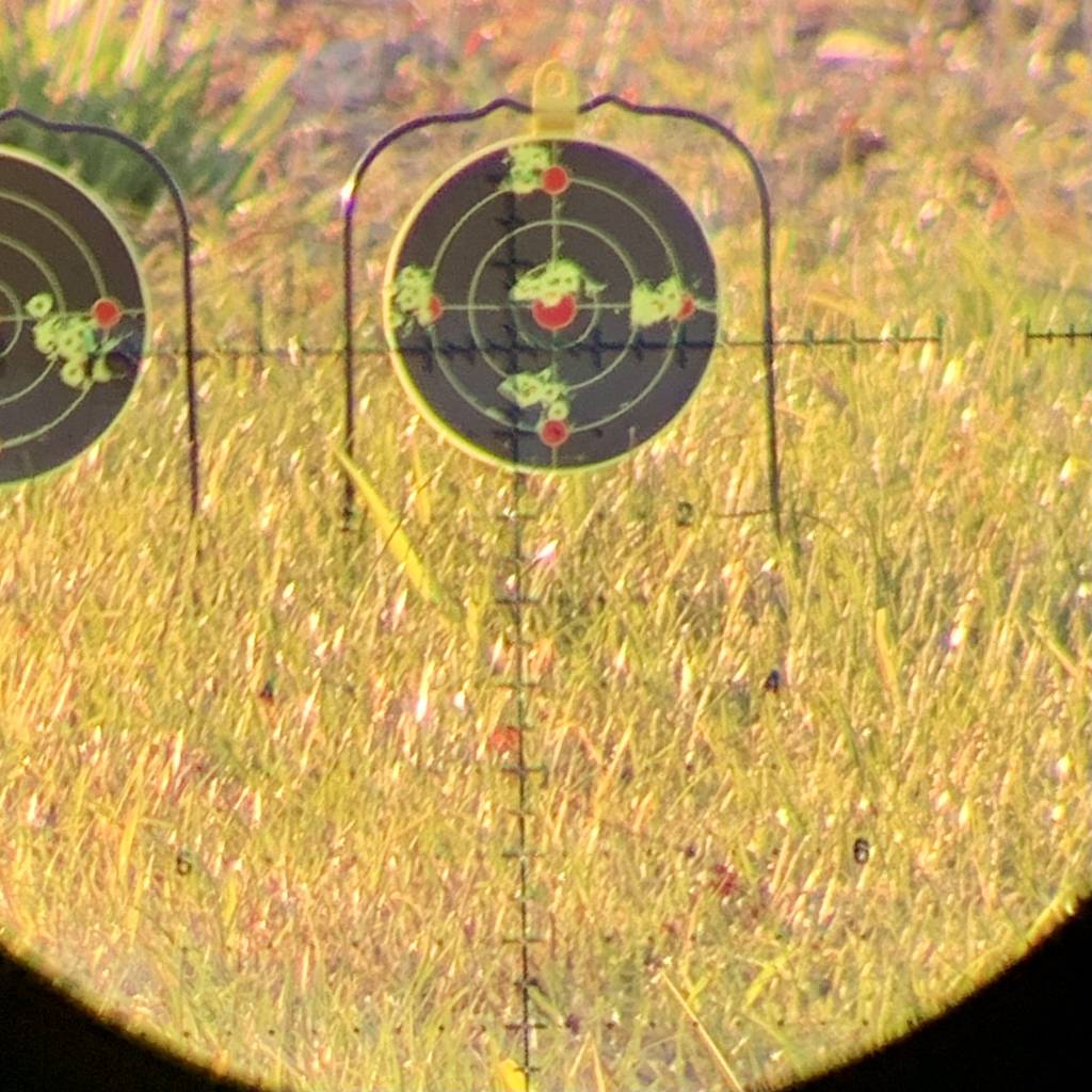

So I came up with a simple POI consistency test for the new more rigid Superior STX barrel configuration now in my Fx Crown .25. From 65 yards I setup a couple of shoot-n-see targets, each having five red bullseyes. Then, shoot 5 shot groups at each bull. One target will be shot with JSB 34.95g pellets and the other target with NSA 33.5g slugs.
Scope view 20x zoomed:
Hawke Frontier FFP 4-20 x 50 Mil-Pro

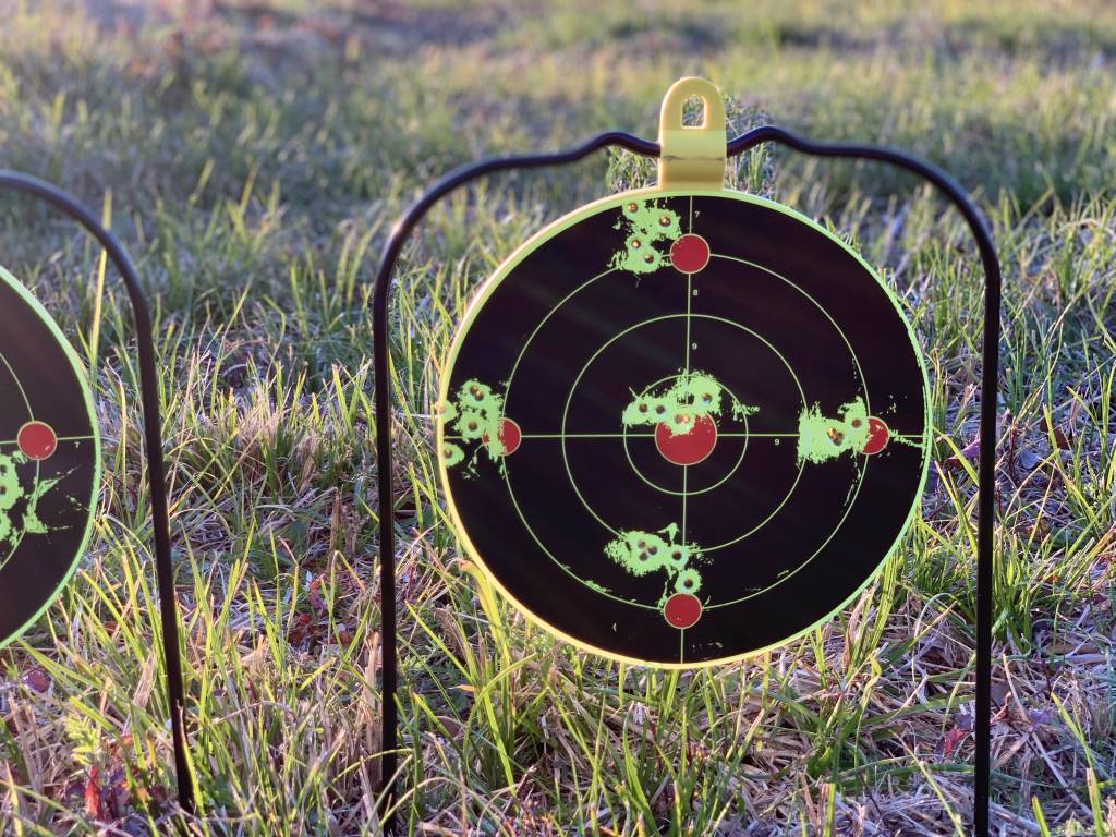

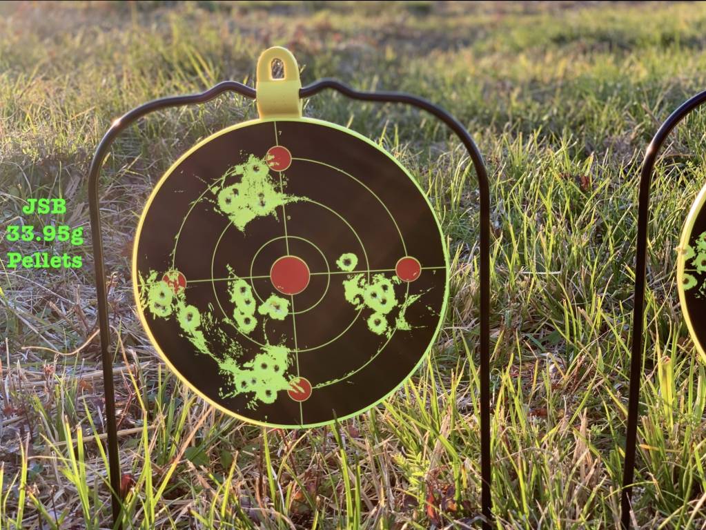

The POI / group placement results from my Crown shooting 5 shot groups on each bull.

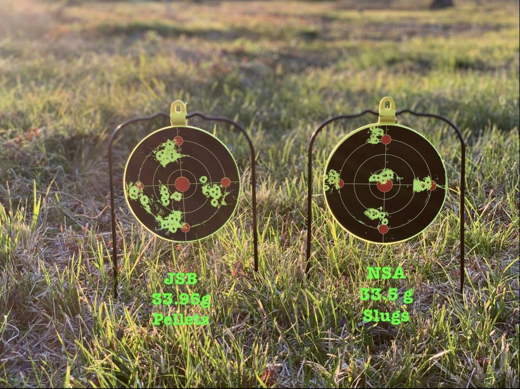

All aim points being @ the center of the bull, each groups with the JSB 33.95g pellets landed low and to the left. Which coincides with the wind direction I had today. The far left JSB group I held half-a-mil to the right to insure it landed on the target. Overall though, all 25 shots taken with the pellets impacted in the same general area.

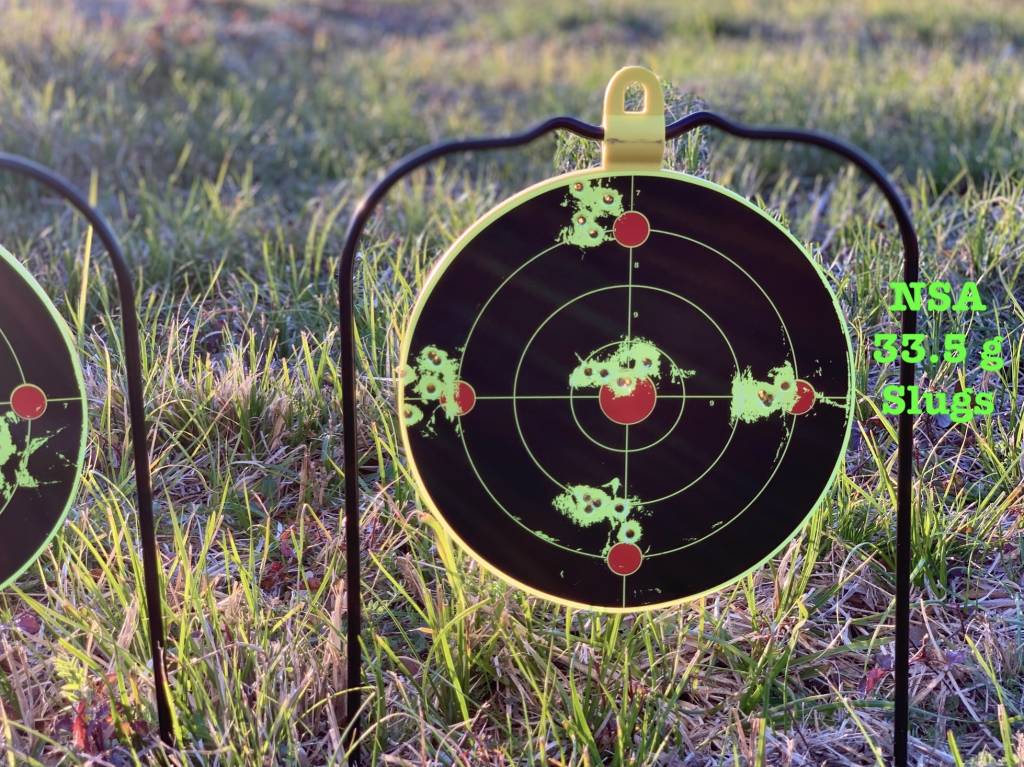

Noticing the Point Of Impact (POI) of the NSA 33.5g slugs, Yet again, from 25 shots worth divided into five 5-shot groups POI proved to be satisfyingly consistent. The wind was not a big factor with the NSA slugs. (**this is why I like slugs in less than ideal wind conditions) These groups were respectably tight and not wandering from any barrel movement.
Once again, let me remind you that this was a test of group placement. I was testing to see if my shot groups would shift from their general area of POI on target. Not so much match winning accuracy. Also, I topped off my FX Crown and moved it around a bit randomly between groups and/or shots.
So, I would have to conclude that Ernest Rowe’s Carbon Fiber STX Liner Sleeve is doing it’s duty in helping reduce point of impact shifts. Also, I am noticing pleasant harmonics, sound, feel, and less vibration to each shot! The barrel is still free floating but has a firmer rigidity about it. It’s gotten my stamp of approval and recommendation for those who have FX’s with similar style free-floating STX barrels like the FX Crown or Dreamline.

I take it these are comparisons of the pellets and slugs with the Ernest CF added. Are there groups without it? This is.... Well...was a huge issue for me, why should top tier guns suffer from POI shifts in the first place? Why do they need a fix?
Great groups at that distance. Glad it’s shooting well for you. I would have been happy with that at 30 yards out of my .177 Wildcat.

For 65 yards these are o.k.groups for shooting with slugs. However a carbon sleeve it is not needed to shoot these kind of groups. With or without carbon sleeve you need harmonic tuning in order to create tight groups. And also with the standard FX construction this is very much feasable. The interaction between hammer, ammunition, regulator, transferport , depth pellet/ slug seating , and barrel make a tune harmonic or not harmonic hence influencing the grouping. When you replace a few outer o-rings from around the liner with a carbon sleeve this gives probably a more constant/ rigid factor in your tuning as the o-rings might “ creep along” your liner when installing but my experience is that by fixing the o-ring. (Tape on both sides so they cannot move) so that you create a constant position on the liner the barrel element in the tune is under control . Maybe a sleeve could straighten crooked liners and give a positive influence. I do not know but that could well be as not all liners are 100%straight when sold. If I were FX I would not be happy with a guy who is telling us that the original product is not top notch in the barrel aspect hence a sleeve has to be added for tighter groups. Also I wondered why FX changed the Wildcat MK3 end cap construction with the result that Ernest could not sell his carefully developed Power Plenums anymore via 910 AIRGUNS. Half a year later now and Ernest did not come up with adapted PP by the way. I do believe that the relationship between FX and Mr Rowe is not what it used to be from what happens in the market and on the web. Just speculation of course but like I said for my taste Ernest is just indicating that a standard FX rifle barrel / liner construction is better of with his improvement offer ( CF sleeve) and that is not good marketing for FX in my pov.
As I see it this sleeve does not per se improve harmonics but changes harmonics . Just an other element in the equation , and for the price of this sleeve I could buy 1000 o-rings . Might be worth experimenting with those ( amount , placement , groups, intersection etc) Anyone did so ?
I want to emphasize that I could be totally wrong as I do not have experience with the CF sleeve but I do have experience with “ harmonizing” my airguns a bit and know that there is a very delicate play amongst the elements I mentioned and a CF sleeve can not change that . I do prefer the liners to be able to be indexed easy as they are rather than more fixed and less “indexable” . Please also be aware that the amount and distribution of the glue/ epoxy will also contribute to the equation ..... “ think before you leap !”
it would be helpful if FX would make a statement about the effectiveness of the Ernest Rowe sleeves or his Power plenums . I really enjoy his WC Mk3 Power plenum on my Wildcat by the way. Perfect product . Interrupted supply by Fx changing construction making Ernest’s offer useless for all current WC buyers.
