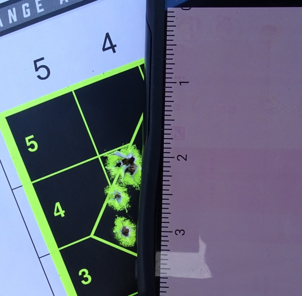

Did my first sub-1" 5-shot group at 100 yds today.
16*F, 5 mph wind from the right.....3" drift. JSB 18gr at 928fps avg at 60*F. One-half mil dialed in for windage.
This is the top left group of the overall target.
View attachment MTU0NzY3NTM1Ml8xMDk0OTM4ODY1YzNmYTZkOGMxMzc4MC41ODE4NTk5Ml9PUkdfRFNDMDM2MjN+Mi5KUEc=

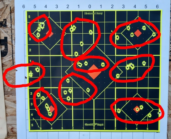

Here's the overall target.
Half of them the shots were strung out by the wind.
The center group was TIGHT but for the one shot when the wind let up.
The top center group was off the reg.
