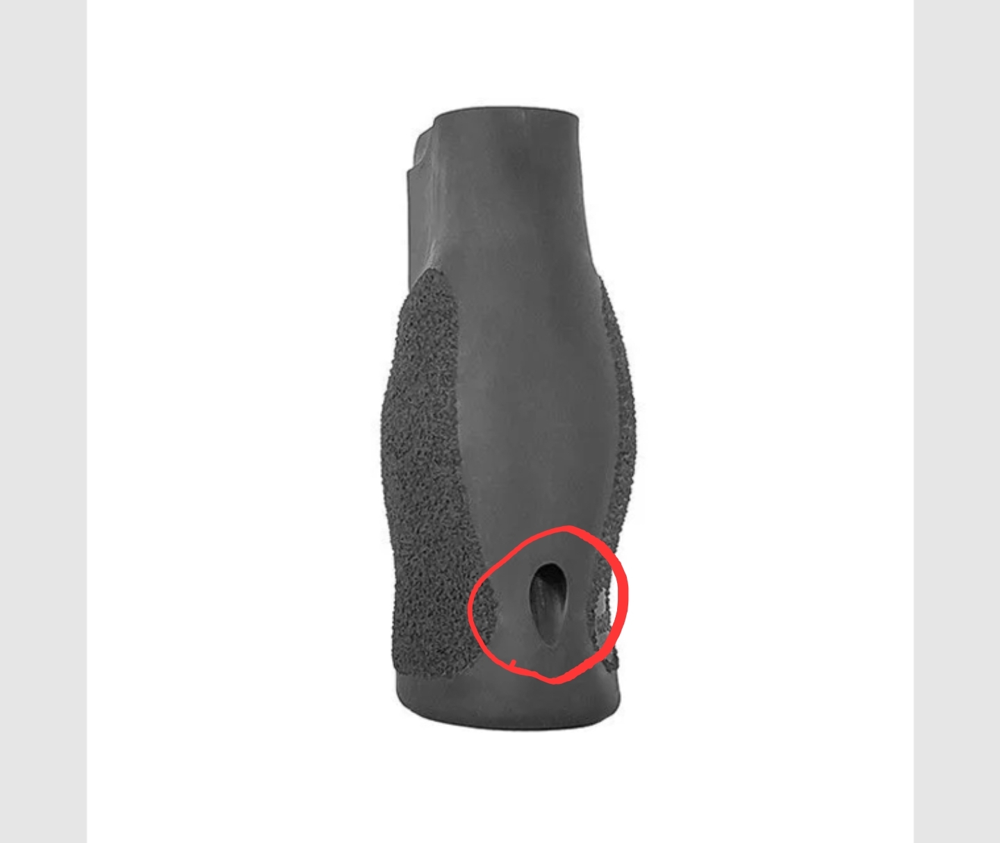

I have an Ergo AIR zero angle FLAT TOP grip (from UA)
I got an Impact M3 in a trade very recently and I decided to put this grip on my Impact and I can't seem to get it fully installed.
I've seen many people have this attached to an M3. But I have also heard from a few that modifications to the grip were needed.
The grip fits the gun perfectly, but the screw I got with the M3 is angled sideways and the hole on the side of the grip is a bit too tight for my allen key to fit in the hole, and the screw won't straighten up enough to tighten it from the grip's open bottom part.
Am I doing something wrong and missing something obvious here? Or is there something specific I need to do to get this to work?

So are you saying that your allen key won't fit in the opening at the back of the grip?
Yeah, it fits, but is very snug and is hard to turn, as this screw requires a larger allen key than I've normally used on other guns with this grip.
I have other allen keys, but the problem is that the screw doesn't line up with that angle, and is sideways, instead of "diagonal" if that makes sense... I am going to go try it again with a skinnier key and try to move the grip screw into a better angle to fit properly.
