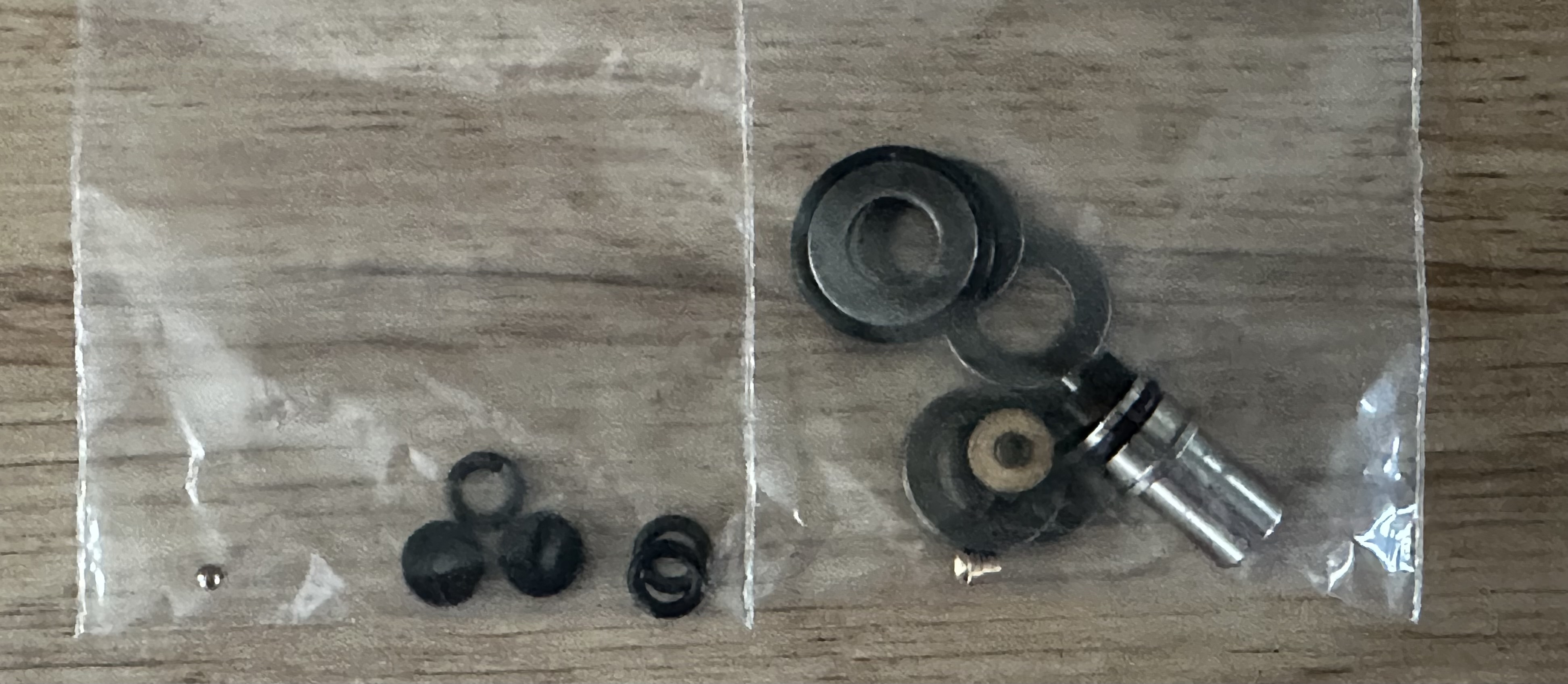

No I didn't ask if it was a known issue but they did say they had seen it on very low reg set pressure as in 40/50 bar, I’ve received my bag of reg parts and awaiting them to do a video now on how best to change it all over, link here to my issue…..

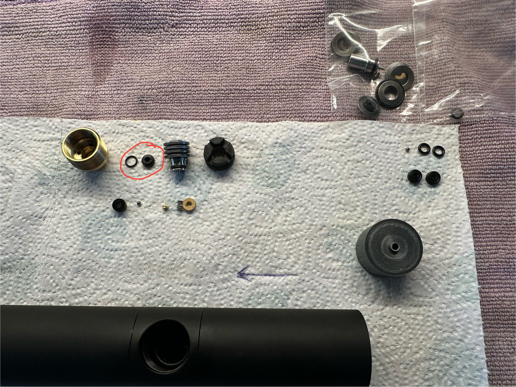

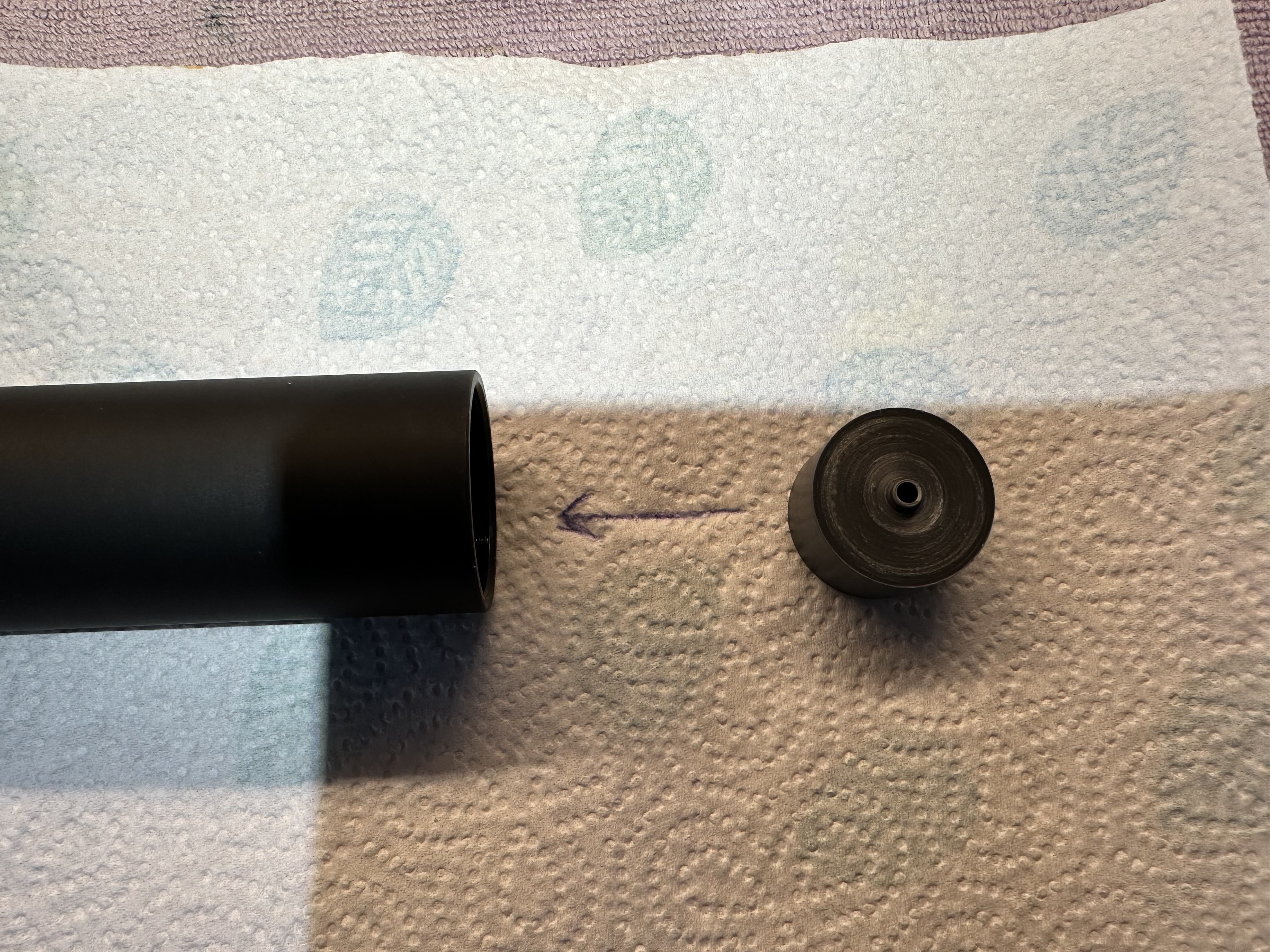

IMG_5160.jpegIMG_5161.jpegIMG_5165.jpegIMG_5166.jpegIMG_5167.jpegIMG_5168.jpegIMG_5170.jpeg

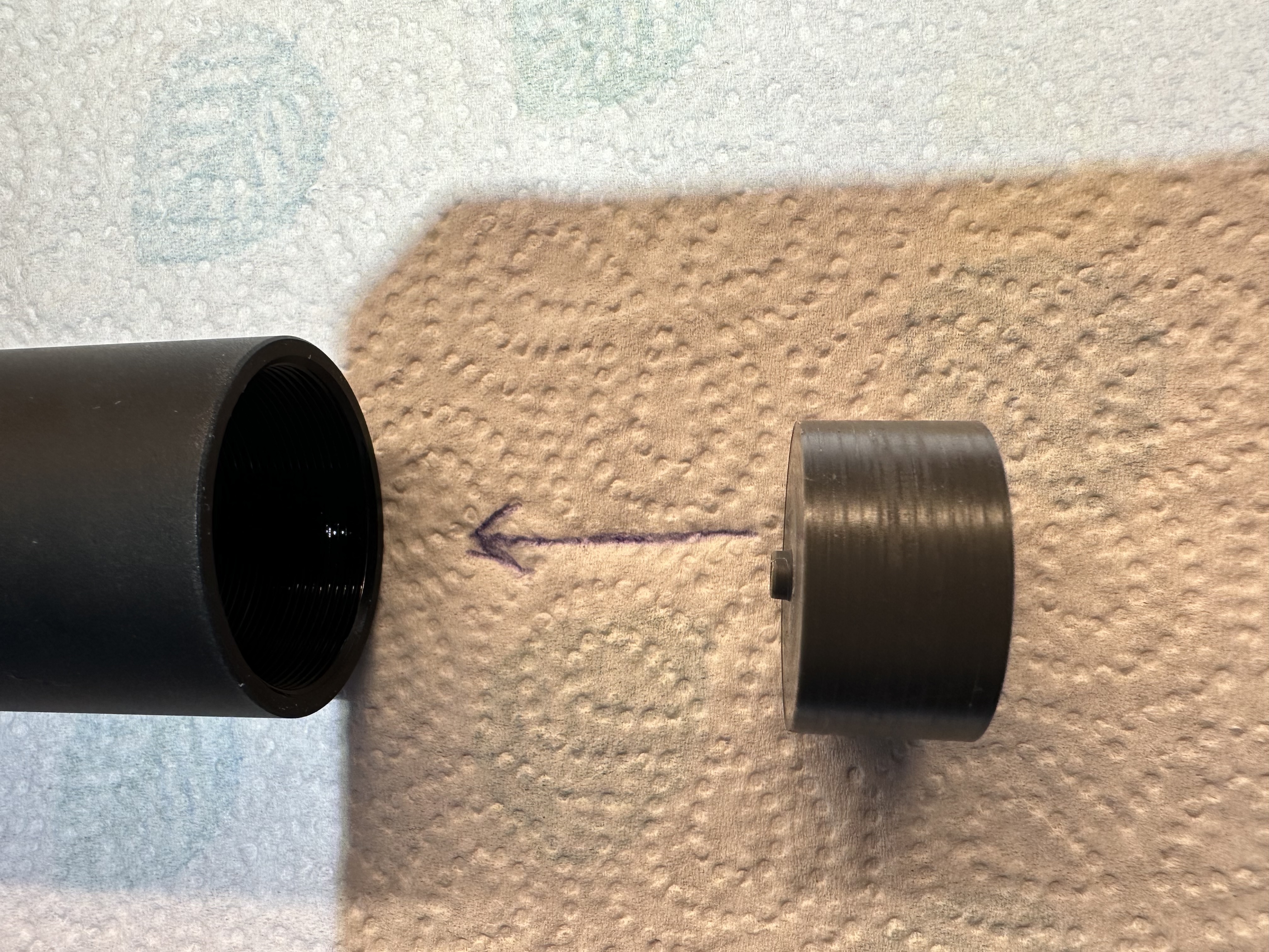

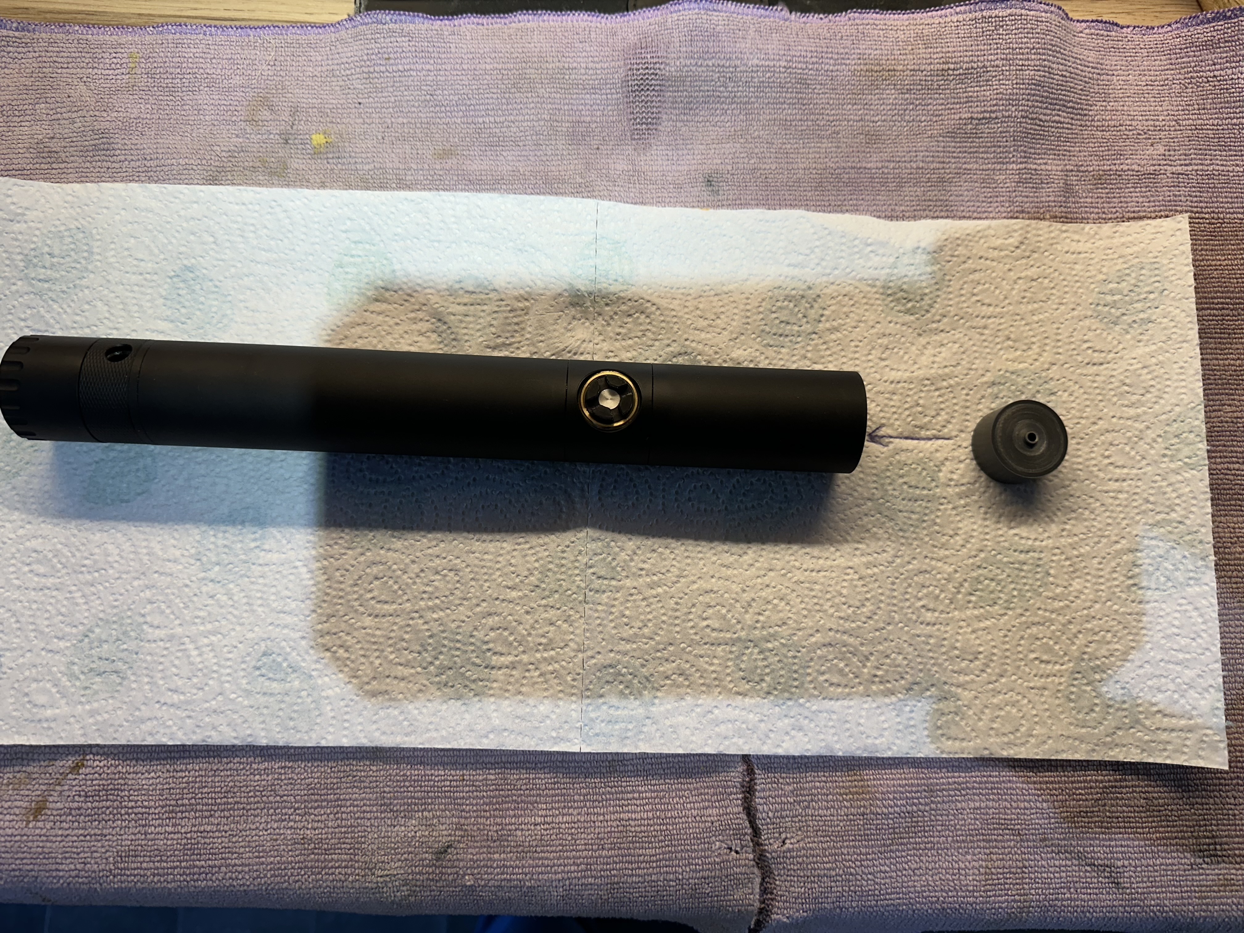

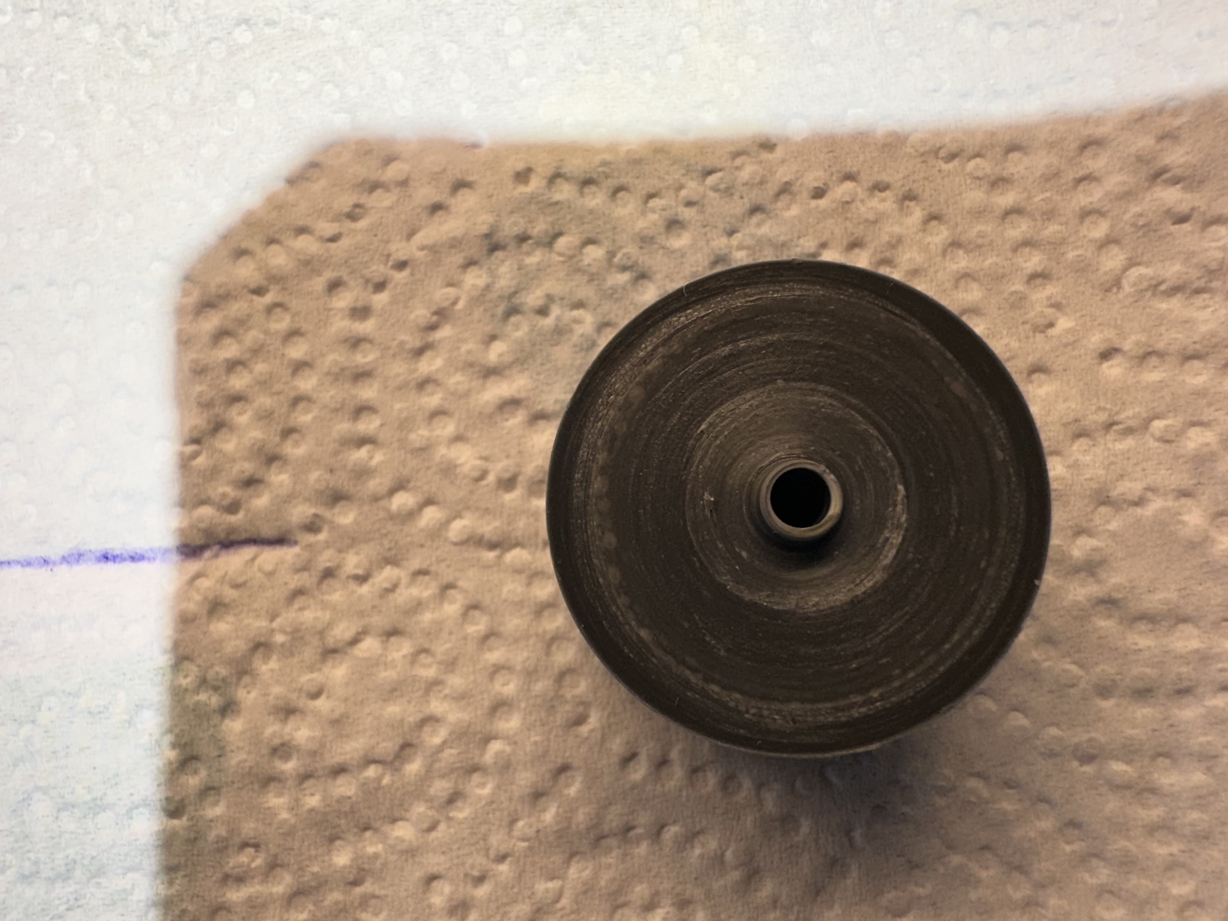

Update on this…Epic sent me a whole new reg as promised and done me a video showing me what to change, turned out just one small part and it’s o ring needed changing and it’s now sat rock solid at 90 bar and has done for 3 days…..so big thanks to Epic for great customer support, the part I changed is circled in red in one of the pics above, I also found and additional piece installed by the U.K. importer 🤦 that didn’t get re installed, not sure if they intended this piece to be a plenum volume reducer (which didn’t make any difference to power levels when removed) or as de-pinger…who knows 🤷‍♂️

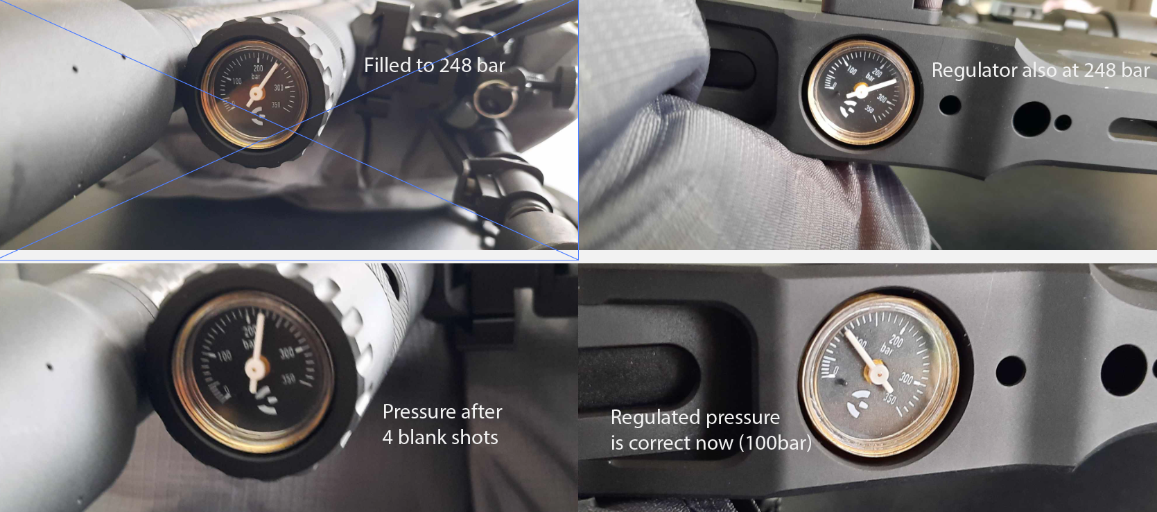

I'm new here. I recently bought the Epic Two (.25) as my first serious PCP. My first rifle with an adjustable/readable regulator. It is currently set at 120bar, but when I fill the airtank to 300bar, the regulator also gets filled to 300bar. It takes 2/3 blank shots to set it back to regulated pressure, but then the airtanks pressure also drops almost a 100bar. I'm wondering if this is normal, I'm doing something wrong or there's also an issue with the regulator? Thanks for the help

Sounds like the regulator is operating in bypass mode. Meaning input pressure = output pressure. There was a similar topic a few weeks back so I'm going to paste in the content:
Your thinking is on the right track. If it is operating in bypass (output pressure = input pressure), the cause may be one of the following:
  1. The stack is squeezing flat before the piston can reach the valve seat.
  2. The piston is reaching the valve seat but the valve seat is damaged (e.g. badly worn) and therefore will not seal to halt the flow of air.
  3. The O-ring on the adjuster is bad, allowing air to bypass the valve seat.
Number 3 is pretty common so I would say look there first. But also inspect the condition of the plastic seal of the valve seat. If it is badly indented, the regulator likely will not work well after you’ve replaced the adjuster O-ring. Note that if indeed the adjuster O-ring was the culprit, the seat is likely to have experienced a brutal squeeze resulting from the overpressure condition, in which case it will need to be either replaced or wet sanded flat and smooth.

Thank for the quick reply’s! I’ve tested Emu’s suggestion filling only to 248bar and the result was the same. Both gauges run parallel to each other and only after 5 blank shots the regulators pressure is decompressed to its correct value. (the pressure in the air tube decreased 25 bar).
After that I emptied the rifle below 50bar and did a second fill to 300 bar. Same result, but it took only 2 bank shots to get the correct pressure on the regulator. (the pressure in the air tube lost only 10 bar).
(Once it's filled and the regulators set, I didn't noticing any creep overnight)
So, I’m wondering (and I know this is a newbie question), shouldn’t the regulator stop at it’s set value (100bar) during a new fill. Or is it normal it runs parallel to the maintank and you have to decompress it manually?

Not normal. I would contact Epic about that. The regs job is to keep pressure at setpoint not rise to tank pressure and then have to shoot it down to reg pressure.
