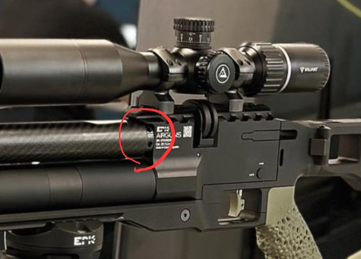

It will be interesting to see how these guns sell. They are bringing a lot to the table. I don't think they will really cut into Evol sales at all because they are at a higher level of complexity and don't use as good of materials. The IWA video had them saying the receiver is machined from 6xxx series aluminum and that can't touch the 7xxx series the Evol uses. The Evol also uses a titanium air cylinder. Tom also has a video on the Evol thread on why he chose the material he did for the shroud, and not carbon fiber, which made sense to me. Opinions, wants, and needs, will vary, but the Evol is just made purposely to be simple, tough, and consistent. Balanced valves are awesome, in theory, and I hope Epic's works out, but they have proven time and again to be problematic and I wouldn't choose to be an early adopter of any. Looking at all the features of this gun though, if you are looking for an adjustable well thought out platform that doesn't necessarily have to survive the apocalypse, and you are an early adopter type, it looks pretty sweet to me!
Because the of difference in the materials you mention and the barrel tensioning differences between the EVOL and the EPIC, this gun is going to have to come in way undercutting the EVOL in price, IMHBAO. They are definitely crafty manufacturers and have a long history of quality fire arms manufacturing and barrels, so lets see how good they are at penetrating the U.S. market. Curiously awaiting.
