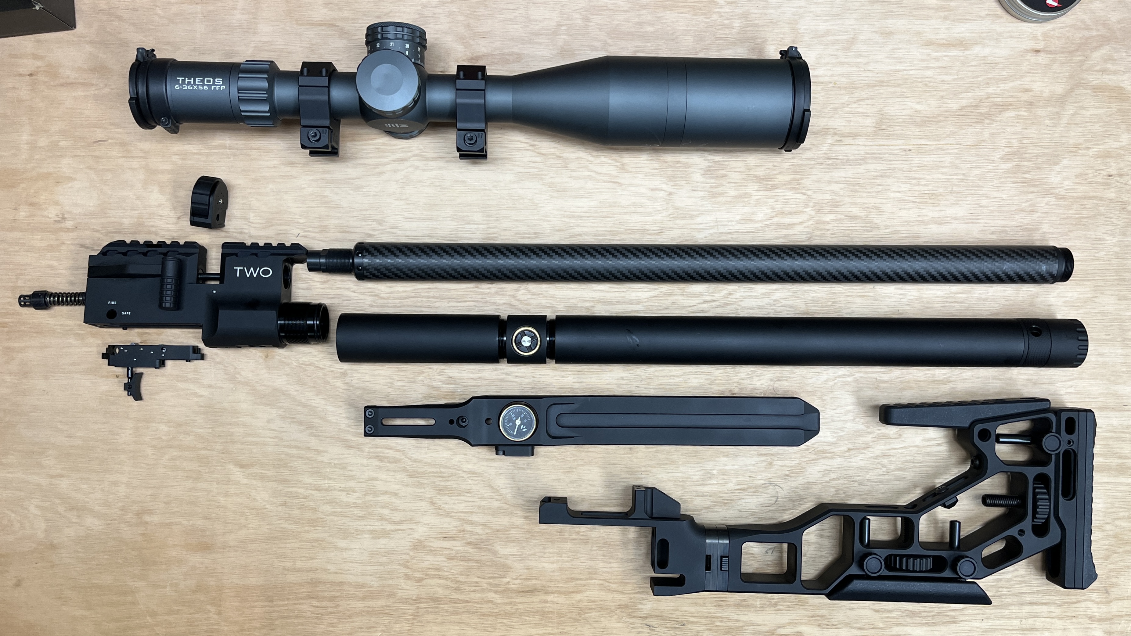

Mine fell apart today ;)

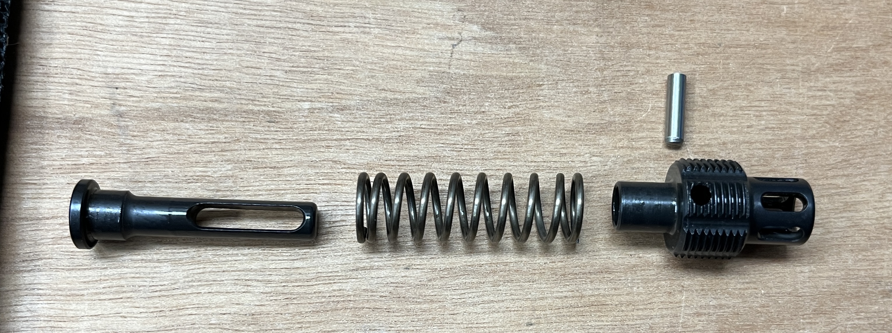

What I can see at first glance is that it is a really well built and robust design! For the once owning one and hearing a ping during a shot: it is the hammer spring system that is resonating. A solution is being worked on :) One way to do it now already is to pull out the stainless steel pin that is holding the hammer spring assembly together, that way it still functions the same but then without the pre-tension. Other temporary solution is putting a small piece of silicone or rubber hose around the spring to dampen it's resonance.
How does the machining look on the rifle? Any marks or sharp edges?
Really interesting breakdown as well
Thanks for the pictures
The overall machining looks good! Haven't really found a sharp edge luckily.
How did you remove the barrel?
The barrel assembly is threaded into the receiver but mine was pretty tight. There is a nut with 4mm holes drilled into it on the barrel that sits agains the receiver, I've placed a 4mm drillbit in one of the holes and used a hammer strike too help it come loose. Now I can easily loosen and thighten the barrel

Barrel threaded into breech block = what all airguns should be.

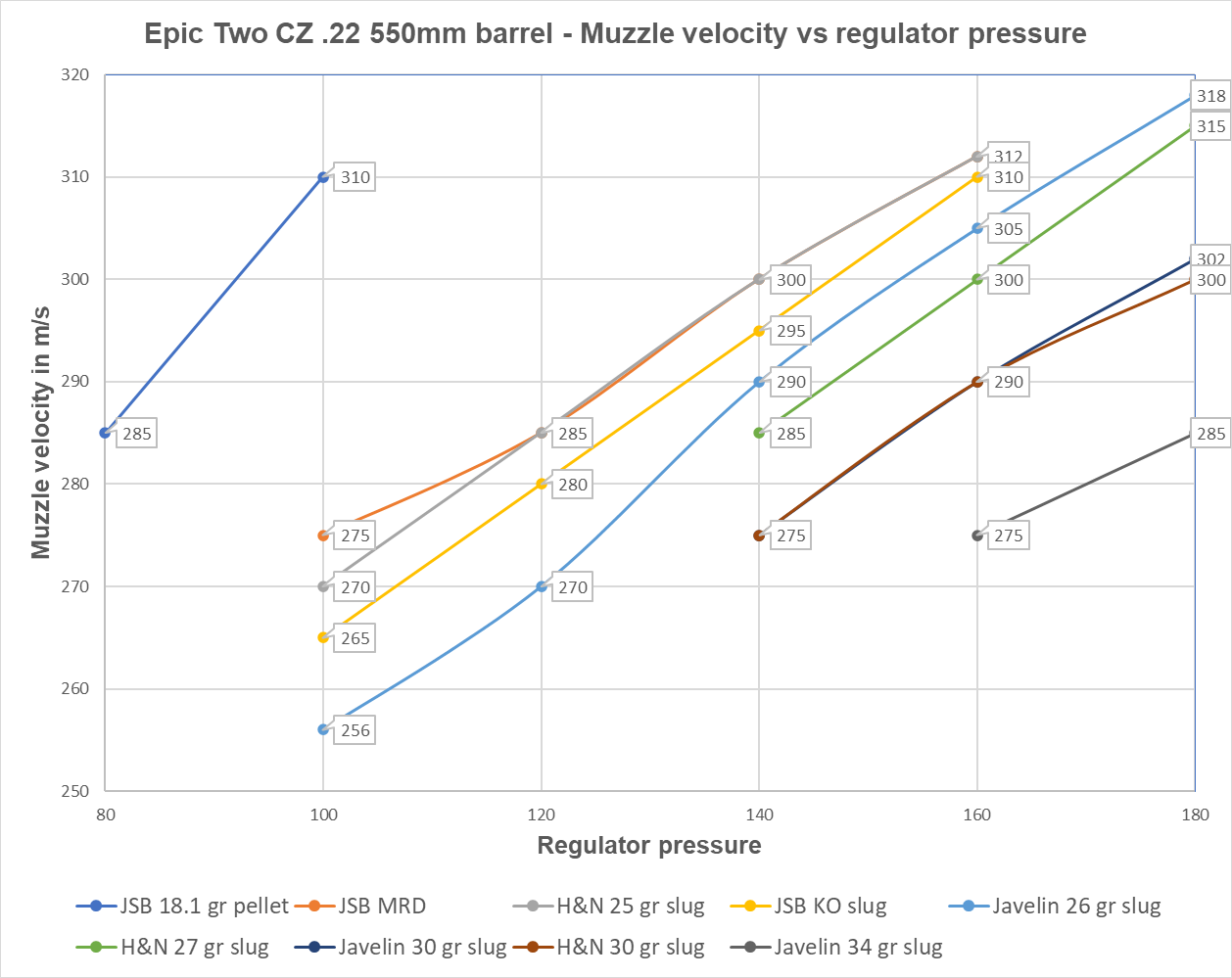

Been testing yesterday (in my garage) and today (at the 100 meter range). The following data is now available for the 550mm CZ barrel of what the maximum velocity is for a certain slug weight at a certain regulated pressure:
in readable units:

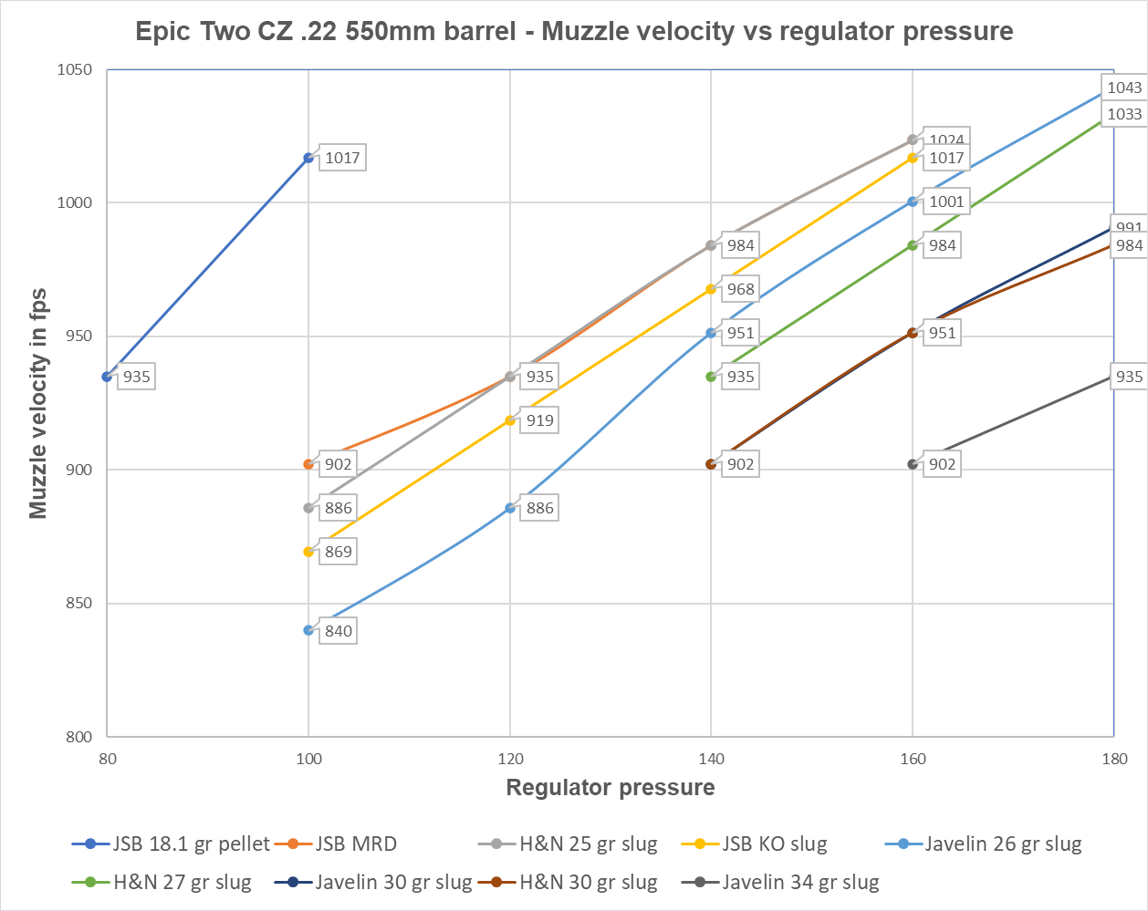

and in murica units of velocity :geek:

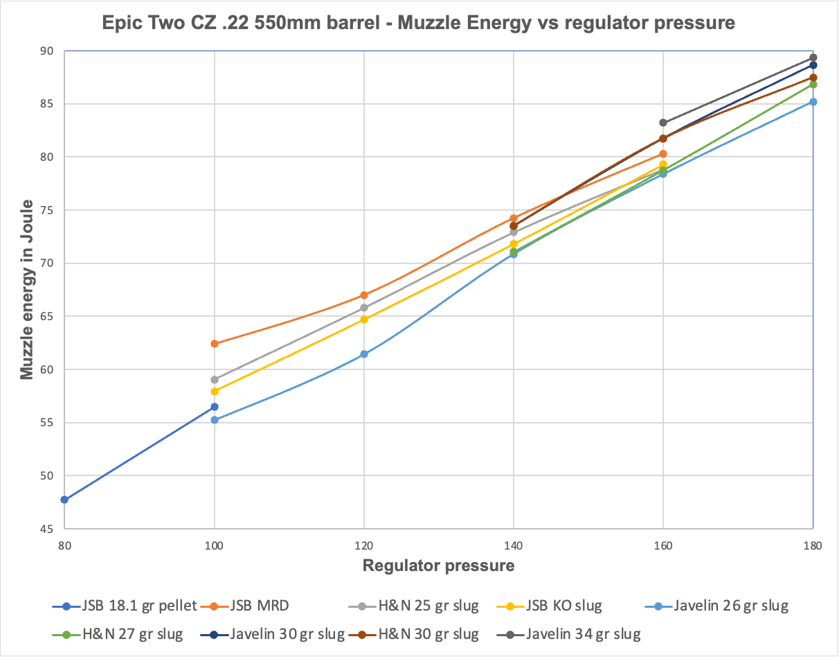

Translated to energy:

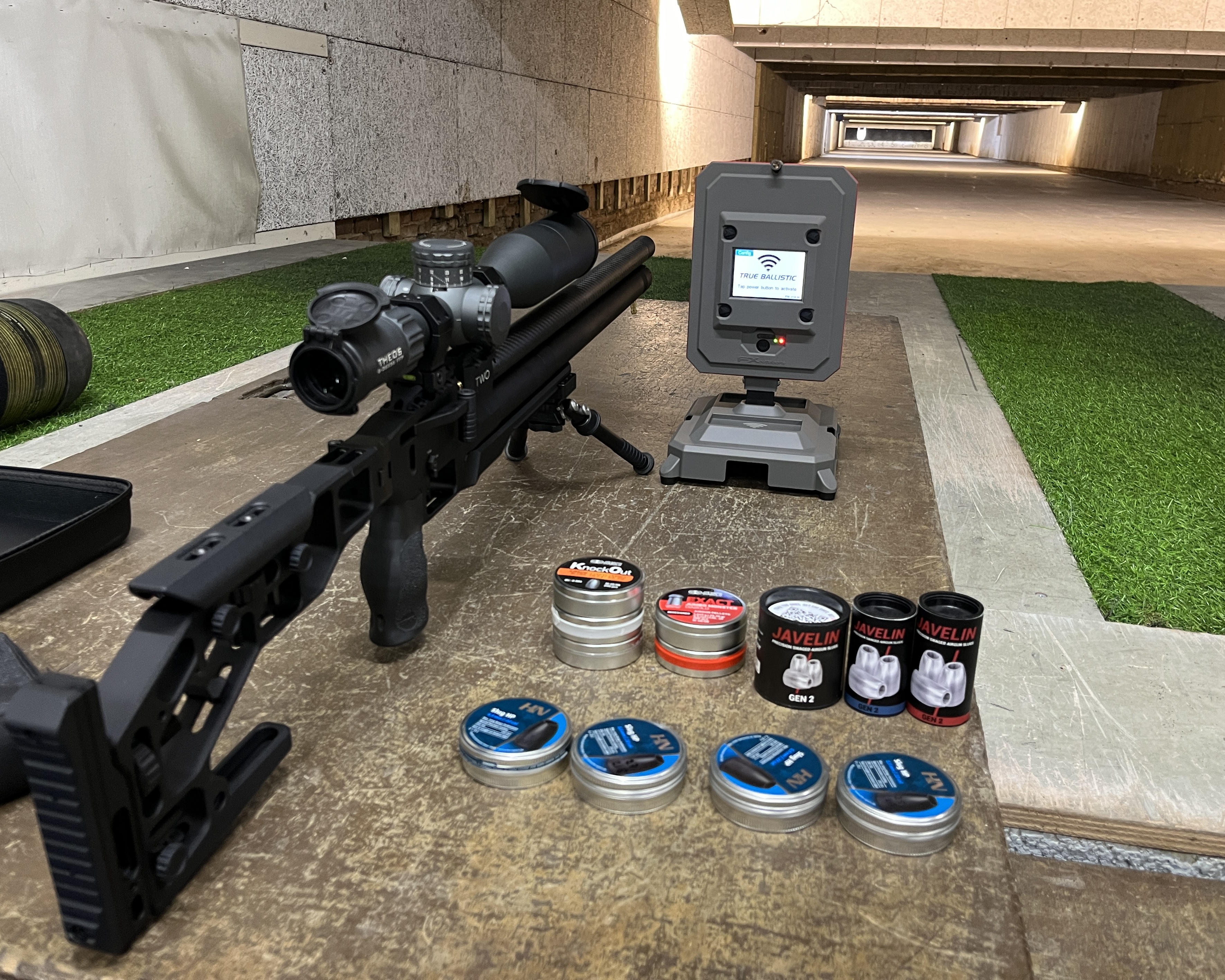

And on the range today just to see what slug diameter and weight I needed to look for.
Got good results with the H&N and Javelin slugs in .218 and already had groups of approximately >50mm at 100 meter (0.5MRAD = 1.6 MOA) without any proper tuning. Several weights had groups of 40mm and smaller. The JSB KOs weren't showing any form of grouping, the Monster redesign showed good groups but as always a poop load of flyers as well. Pictures of the groups are on my instagram
Plenty of power. But how is the shot spread? Say over 10 shot what is the extreme spread?
If you're 'in tune' it's about 1-2 m/s or 3-6 fps max. When I was pushing too hard with the hammer it became incosistent but I can't imagine why you would use that tune on purpose since there was no velocity gain anymore.
I expect the values to go up a little with the LW polygonal barrel of the same length. Should get that delivered soon so I'll update this thread then

statistically my groups are not saying much at the moment but it was just a quick test to find where I should look for in slugs. After this I'll start testing more thoroughly to find accuracy nodes and then with 50 - 100 shots per tune to find the right setting.
