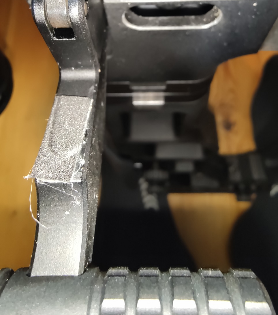

So today i had to mod the Two a little.
When you " throw " the cocking lever forward it stop by " slamming " into the main body, the sound of metal on metal like that just do not do it for me.
So i dove into my bucket of little stuff and came out with a little sticky pad with EVA foam on it, this was meant for install on a dashcam mount as there can develop a rattle if the mounting become a little loose over time, the EVA pad would then fill up the space and kill the rattle.
Anyway back to the Two, i cut out a little piece and put it on the cocking lever where it collide with the body, resulting in a more nice " thud " sound VS the factory clank sound.
The EVA pad are 1 mm or so thick so should not matter on the operation of the rifle.
FYI I dont see why you couldent use something even thicker if you want to moderate your cocking experience like i have just done.

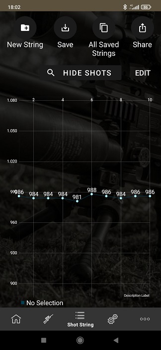

Anyways, threw on the new barrel, and did a short living room chrono session with pellets, so now i am ready for the range and fine adjustment with slugs.
