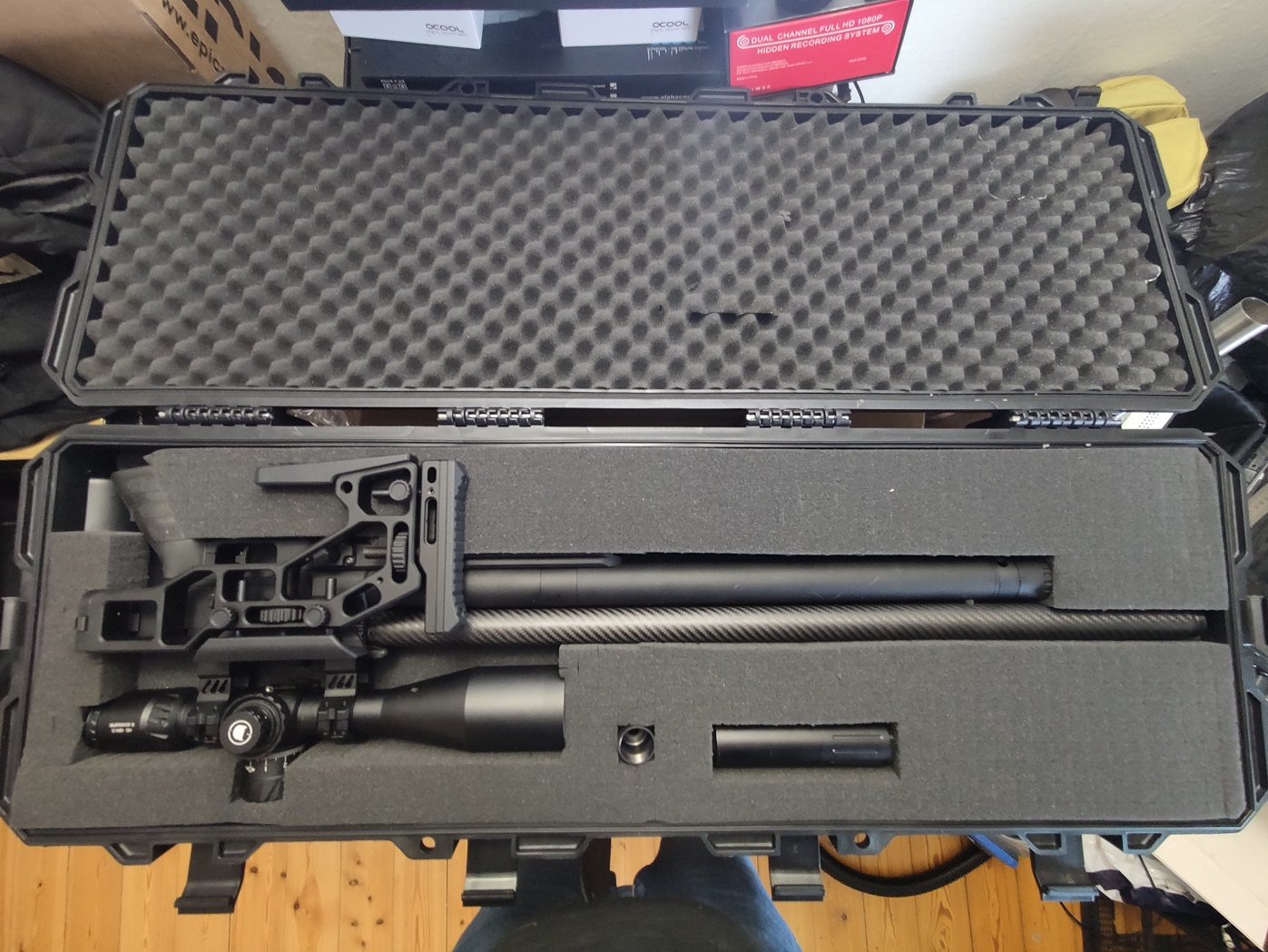

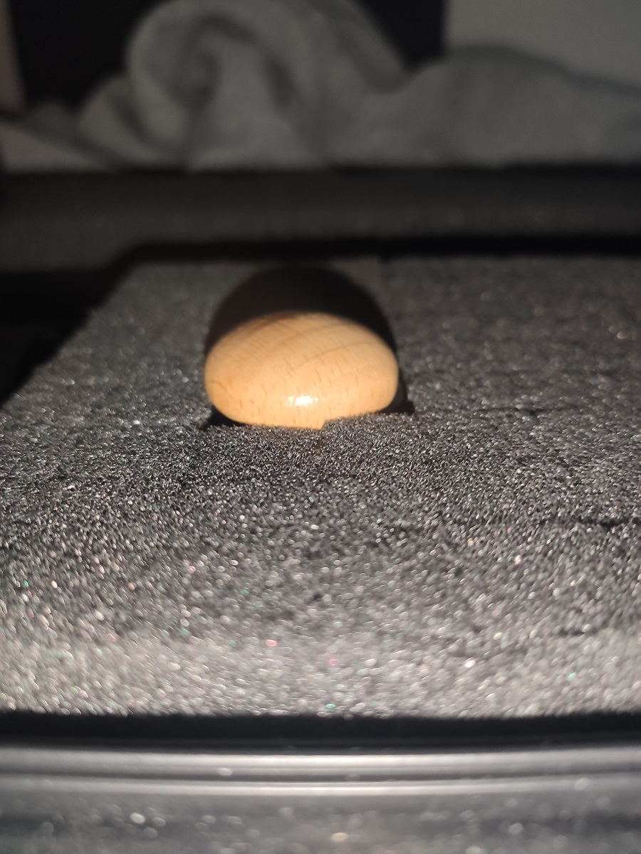

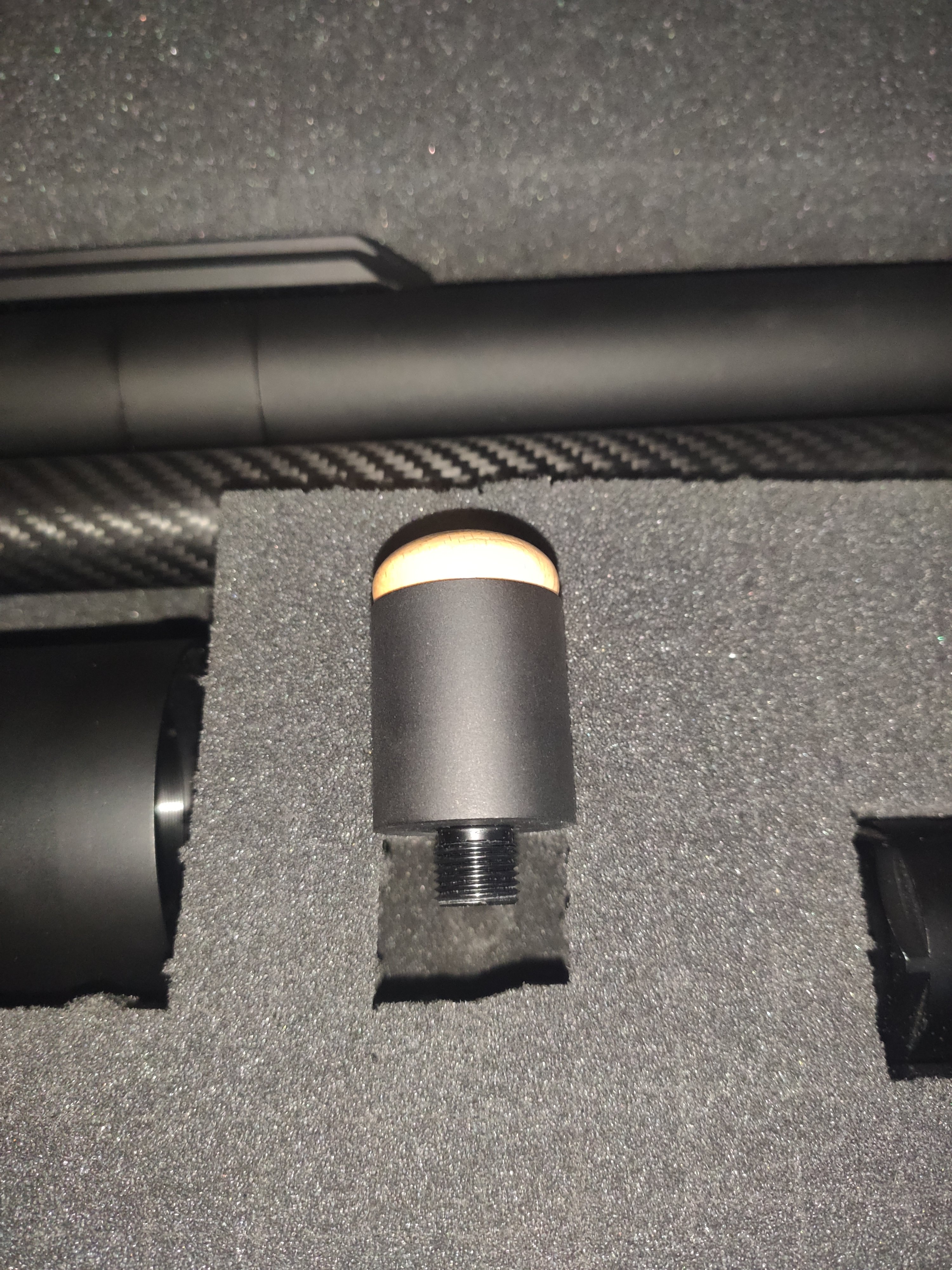

Okay so i got a little burned on the case i ordered for the Two, the listed measurements are the very outer most measurements and not the size of the compartment of the case.
So the one i ordered are barely able to do the job, for sure not have the adapter for the moderator installed on the barrel.
But i still made it work, just not as planned, but for transport to / from range it will be fine, but i would not ship my rifle anywhere like this, for that to work i would need at least 50 mm / 2 " foam all around to be able to feel good.
As i have cut so much into the form, well i will have to glue it into the case CUZ it have a tendency to want to follow the rifle out of the case when you take it out of there.

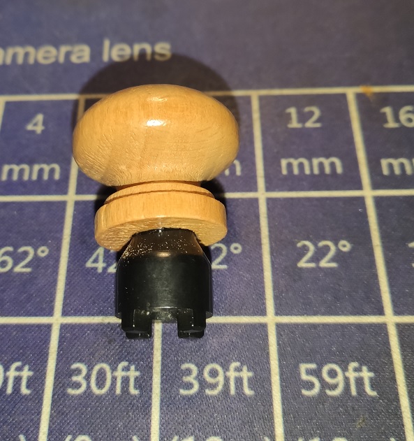

The two come with a little tool for you to be able to work the regulator, this is just a ring like for keys on your key chain, and it is not really working for me or others.
So ! well i went a little knobby on the problem. :)
Another solution i fell across, though a bit more expensive was 4 mm chain with elongated links, in my case the links was about 40 mm on the long end.
So you could cut these where they are welded together on the one long side, slide the 2 ends apart so you can put on the REG tool, and then you can slide the 2 ends back so they allign and you can slide the REG tool to where it cover the cut, and you should probably give it a whack with a hammer to close the gap the cut made, or clamp down on it in a vice if you have that.
For now i carry on with this knob solution, but if it fail me, i will change to the chain link solution to get a solid handle on the tool CUZ these Two regulators well a lot tighter to turn than i am used to from FX.
I was a little worried i would not be able to grip this knob enough to adjust the REG, but i have just tried it and it was alright.
Maybe wet hands would be problematic, but then again i do not shoot with wet hands.
FYI the REG adjuster tool is 10 mm at the end, and the hole in it for the original key chain ring is a little over 4 mm

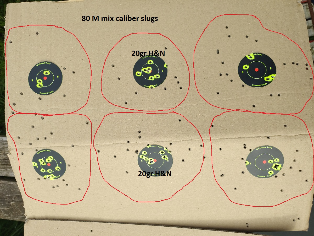

I then went on to try 20 gr H&N and Zan, and actually here shooting 80 M the H&N looked the best, though not far from as bad as all the other weights.

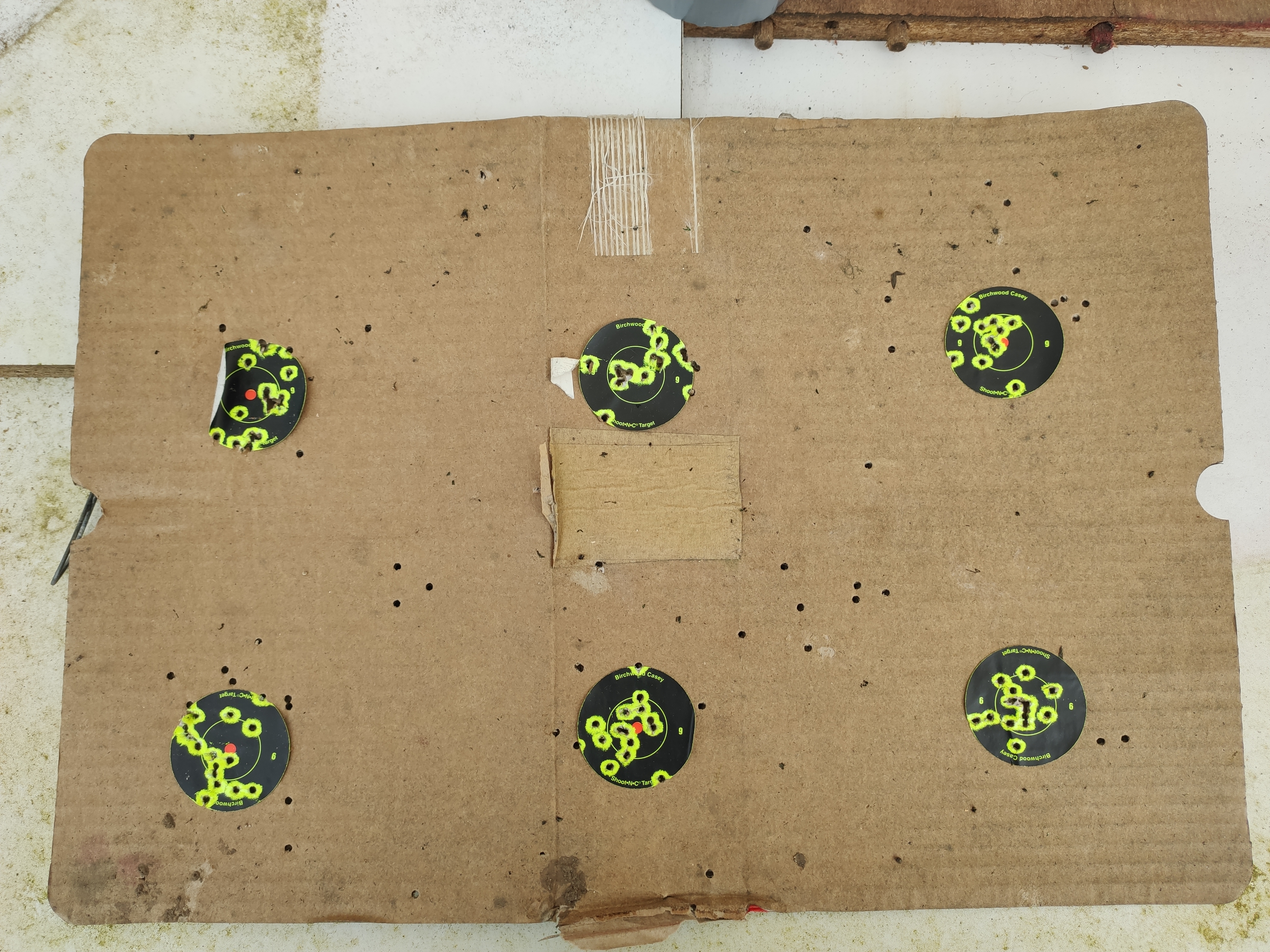

So at 80 M shooting at my usual 2" shoot N see splatter targets, well where my Maverick would fill those with holes and maybe 2 just outside the splatter target, but the Two, OMG it is very close to pure luck if i can get 2 on the target in a row, actually that only happened once today, otherwise it was just scatter gun.
So i was shooting at other stuff to gauge / zero, and i would get like 3-4-5 shots that was " okay time to shoot a splatter target " and then change aim 2 M to the right where those was, and BAM rifle no longer grouping and sure as hell not 3-4-5 shots, and a lot of shots just OMG off target.
So back and forth back and forth for hours, trying other speeds ASO, hell at one time after taking the 20 gr to 960 FPS i put in 13 gr and went super sonic sending cracks along my lead across the field.
Also tried Beasts again at 25 M and Sure it was not worse than day #1 so very far in between okay 5 shot groups,,,,, many fliers.
That was also the same with the MRD pellets i also tried.
80 M slug paper, one big mess.

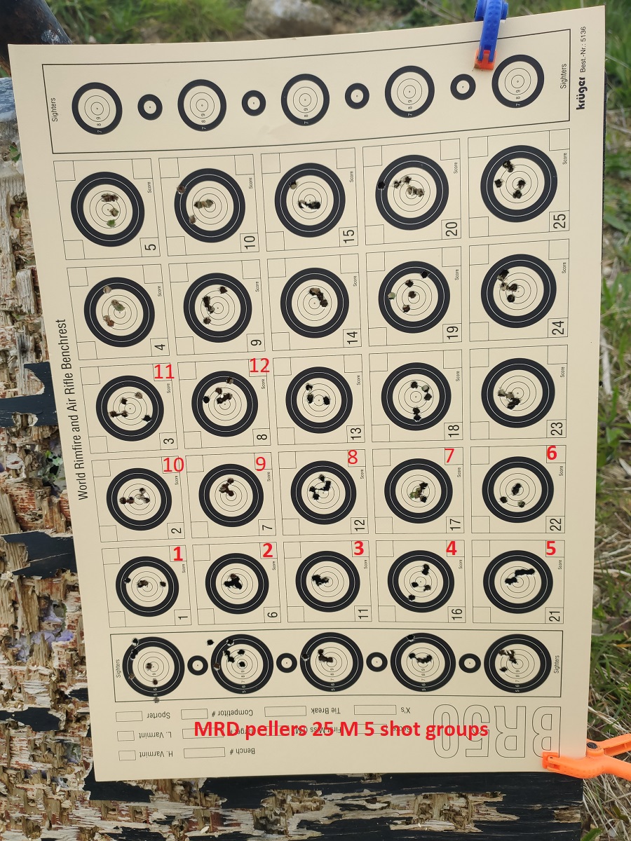

The BR50 paper i used to shoot 5 shot groups with the MRD pellets at 25 M, speed a little up / down here trying to find sweet spot, which seemed to be 860 FPS.
Really i would have expected more on this short distance, even if the wind was picking up at this time ( around 6 in the evening )

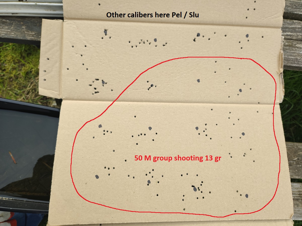

Finally my 50 M cardboard with ink dots on, the plan was to shoot 5 shot groups, but everything sucked no matter what i tried, slugs at different speds and pellets too, but this is also just a big mess as you can see ( i swear i am a better shooter than that )
highlighted the groups shot wit increasing speeds on Zan and JSB slugs, nothing made any sense to me.
That one group sort of looking alright, well it also collapsed shooting something else.
