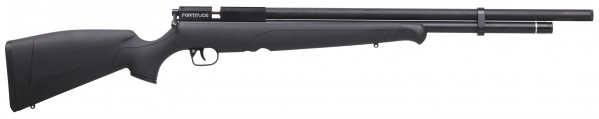

Many $300 PCP's that shoot good are available. The Fortitude is one (once you break in the regulator). The new Fortitude is power adjustable with a lighter trigger.

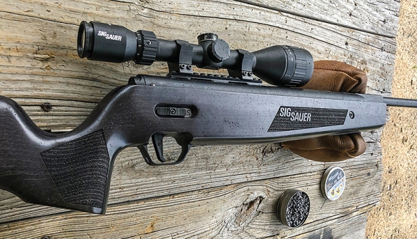

The New SIG ASP20 is supposed to be the best springer yet. Just ordered one. ($349-$429)

....but a Fortitude vs ASP20 (with a practiced spring shooter) would be a good battle.
