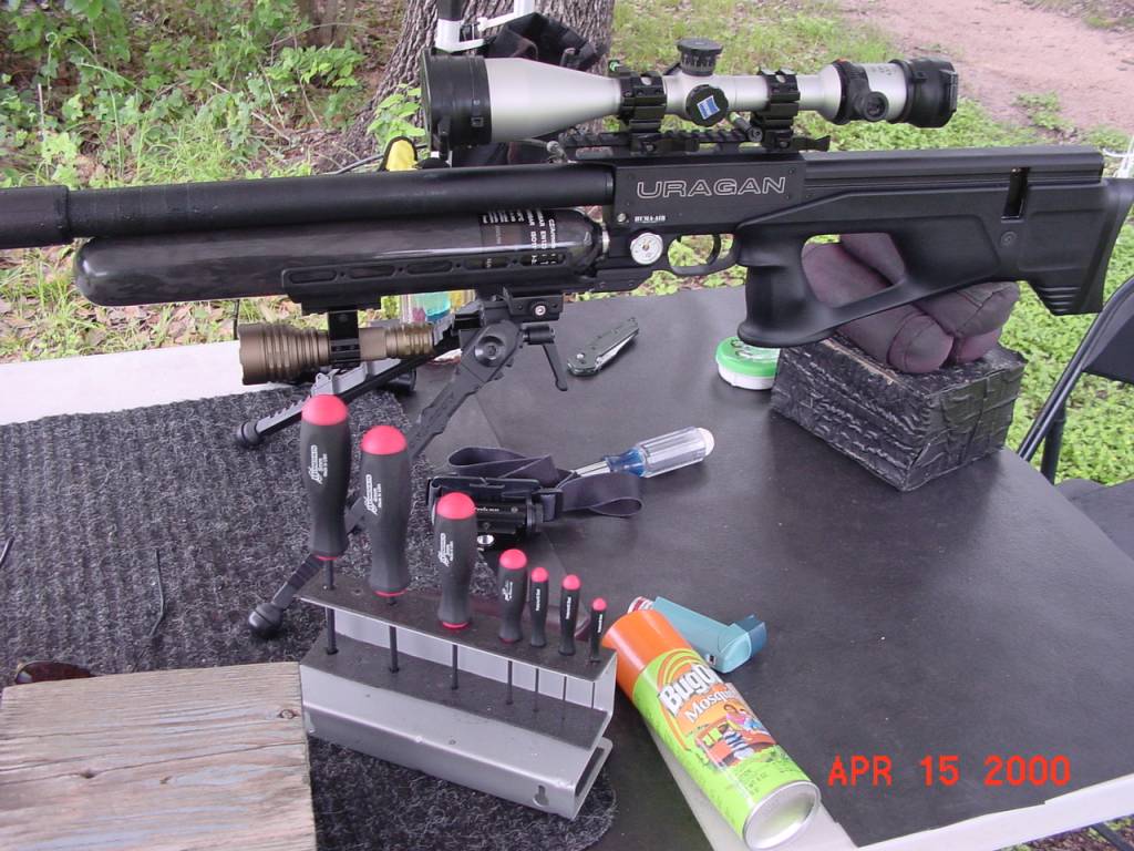

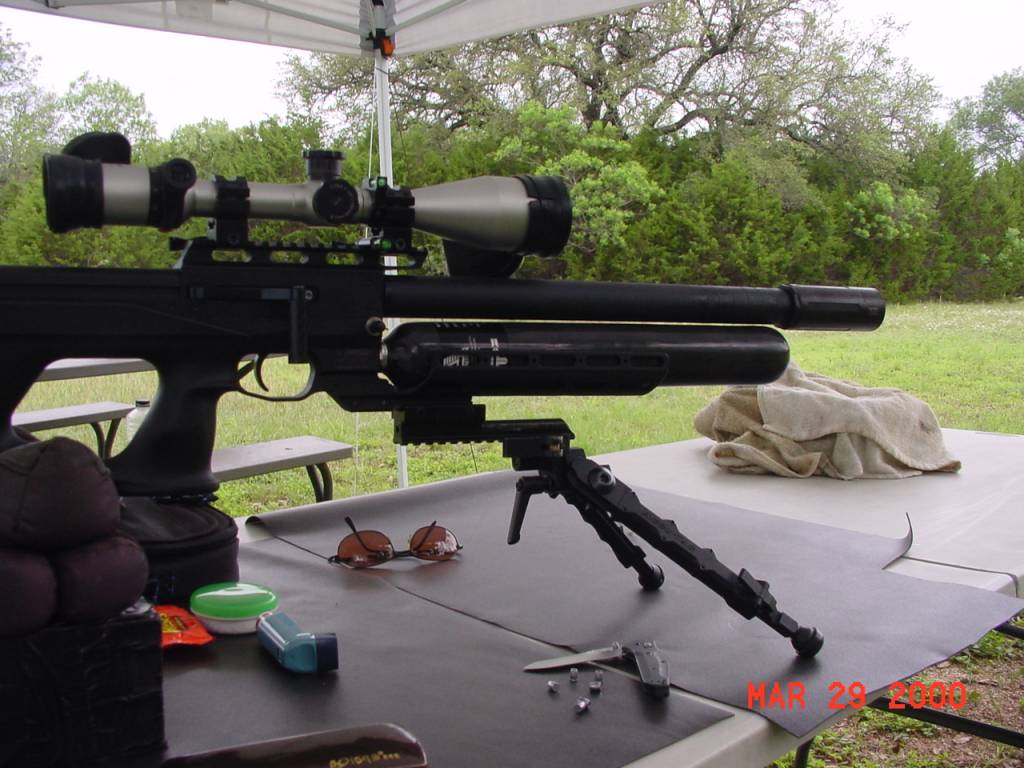

enjoying the new addition, the Uragan .25 with Slugs

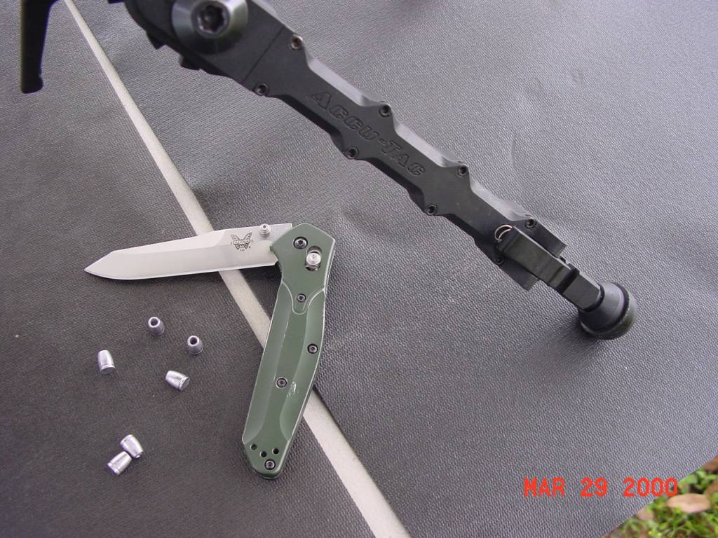

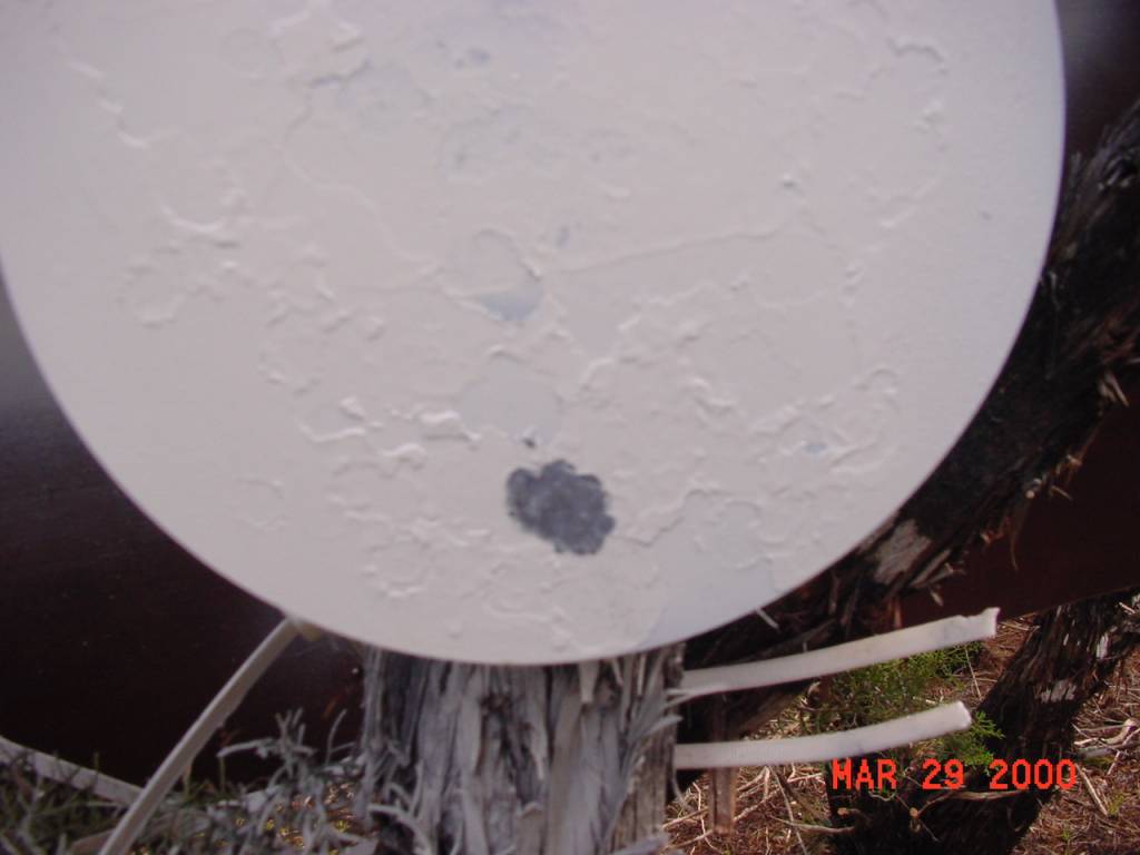

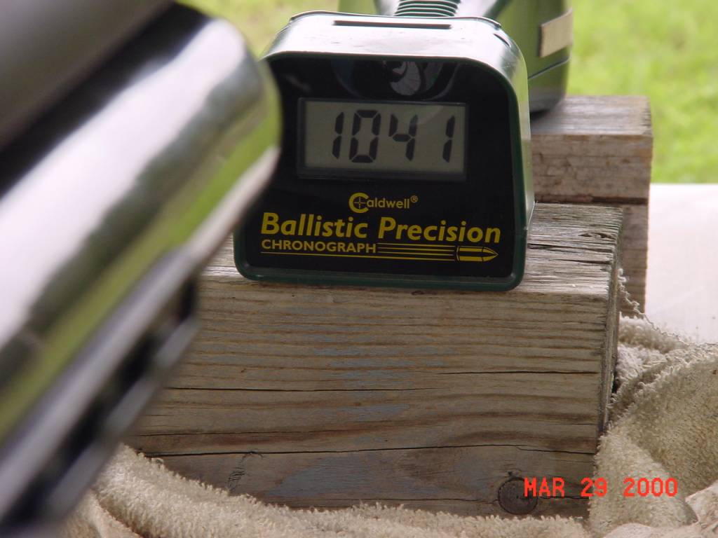

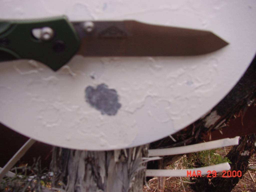

Testing this morning with the Uragan and my hand cast slugs in the rain. Hard to take pics! Steel plate is 96 yards, 5 shots. Lots of splash, but actual hits the size of a U.S. Dime. Every thing was crystal clear thru the Zeiss. Just not so much when trying to take pics. Knife Edit, Slugs are HP 38 gr at 990's. M
I was told that the Uragan .25 had a choked barrel and could not shoot slugs only pellets. Is this not true I was told only the Uragan .30 didn't have a choked barrel and could use slugs. I see you got an awesome group there with your slugs but are you doing any damage to the barrel? I like the looks of your slugs they look like they would perform well getting great expansion from that huge hallow point.
Nice group. I lost my Osborne 940 a couple of years ago bird hunting in Oregon; haven’t used a pocket clip since. That was always my son’s favorite knife of mine when he was growing up and he asked if he could take it when he deployed overseas. I hadn’t told him I lost it, but when I did he ordered the green aluminum handle for himself and the carbon fiber one for me. Great knife, great kid!
Thanks Guy's! Slug was 38 grs. Further modded the mold to cast at 34 grs. No, shooting slugs won't harm a barrel. LOL! I have tested NSA, Air Velocity Sport and D-Rig's and all shoot well.
