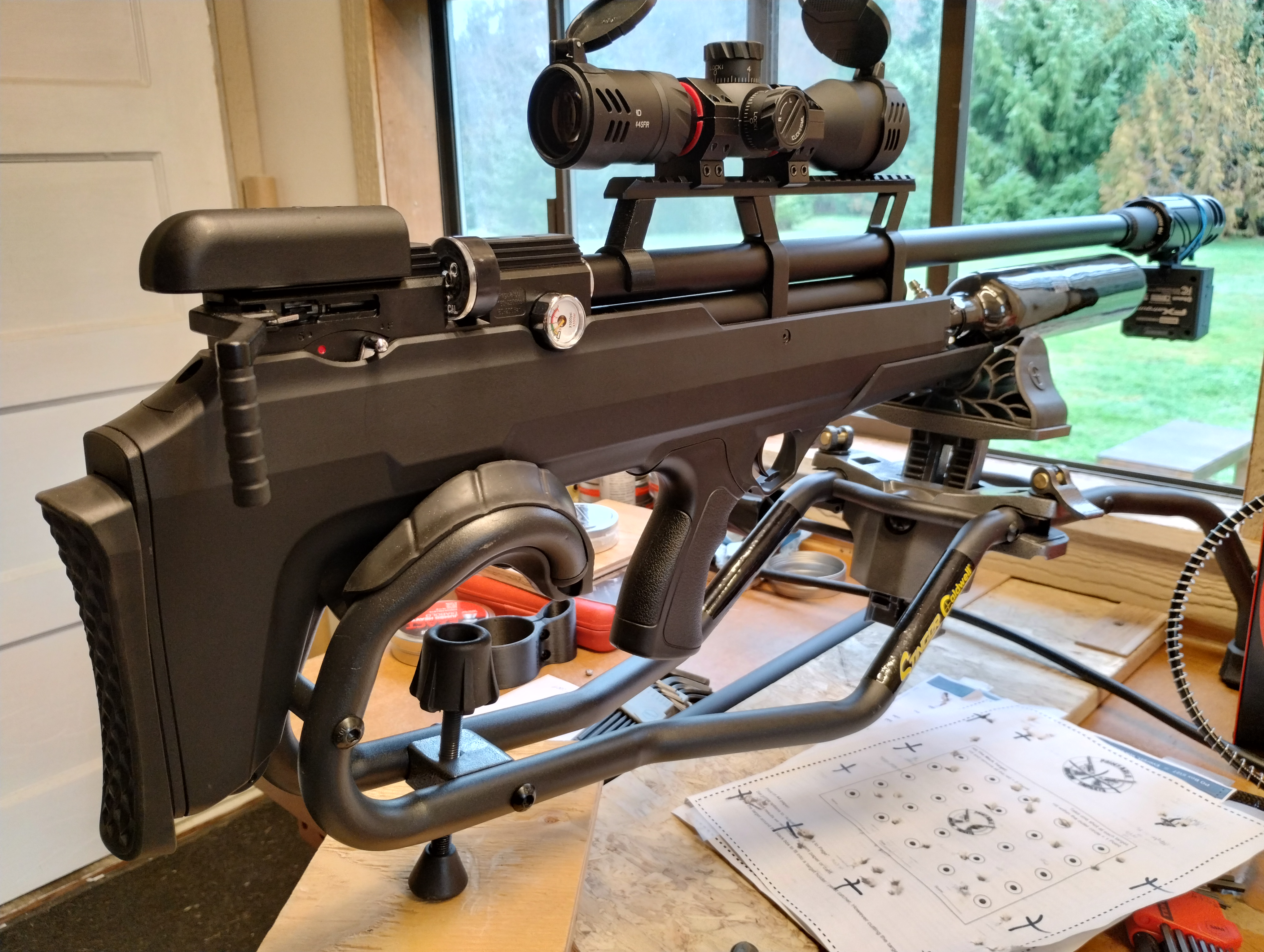

I'm enjoying the AV avenger bullpup. Nice short gun, pretty dern accurate at 50 yds and soo many shots. On a very low wind day it is surprisingly accurate. The gun seems to prefer the FX 15.9 pellets.
I started shooting today at ~4100 psi (should have filled it to 4350 but wanted to get started). After 230 rounds I was down to 2000 psi (my regulated pressure). Shooting the 15.9's at 895ish fps slowing just a tad at by 2000. I kept going:
20 more shots at ~878fps (ended at 1800 psi)
10 more shots at ~870 (ended at 1750 psi)
10 more shots at ~865 (ended at slightly less than 1700)
10 more shots at ~862 (ended at 1600)
20 more shots at ~835 (ended at 1500) even these shots were surprisingly consistent
One more shot at 817, this is where I quit.
15.9 Tune:
Regulated pressure: 2000
Hammer: 1 turn
Oh...I've also modified it a little. Fun stuff.
I think I enjoy this as much as my crown II. Going to make the Crown my slug gun.
