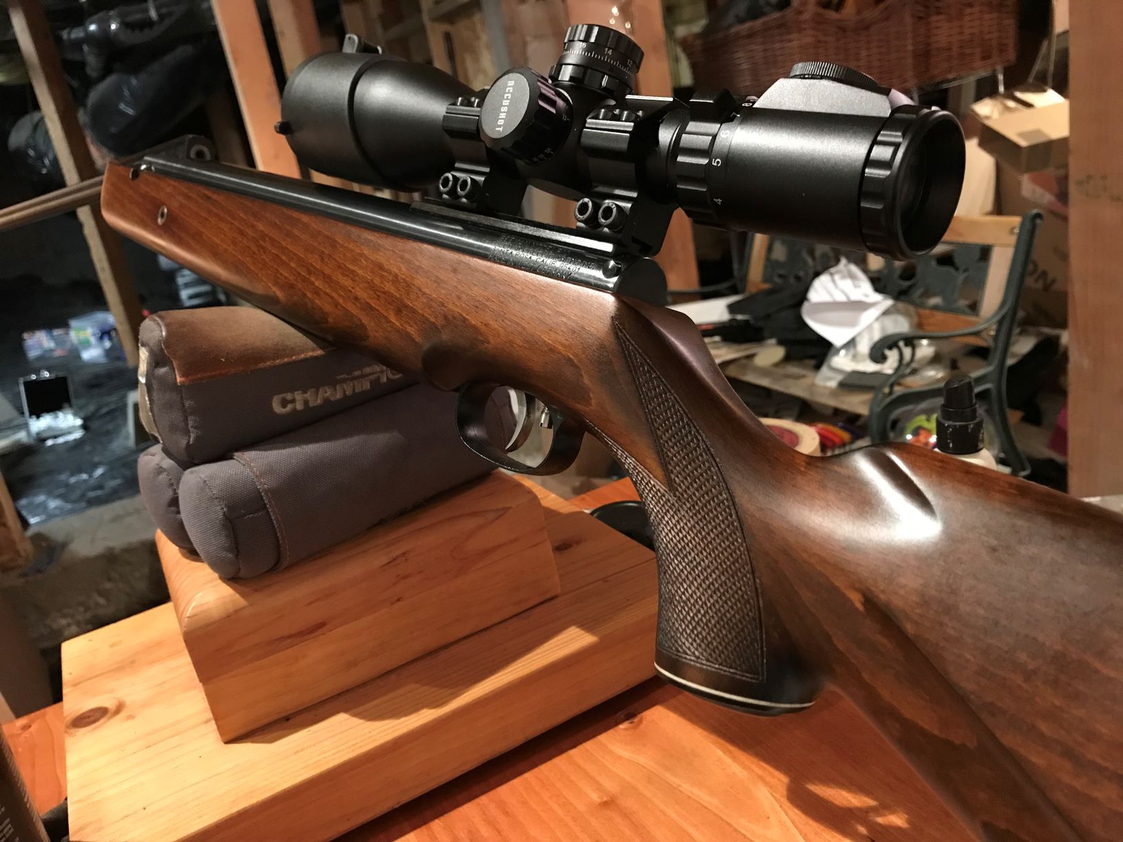

Surely this picture is not the refinish. Looking forward to see how this goes.
No Bear :) - I wish! ....... Factory R10 finish from 1988.
Hoping/praying the fuming could look somewhat close :unsure: ?
It’s a similar process to the oxidation method. No two pieces of wood come out the same. I think this was the process used when Beeman imported the Goudy stocks. I have always wanted to try it. Good luck. Please keep us updated with each step.

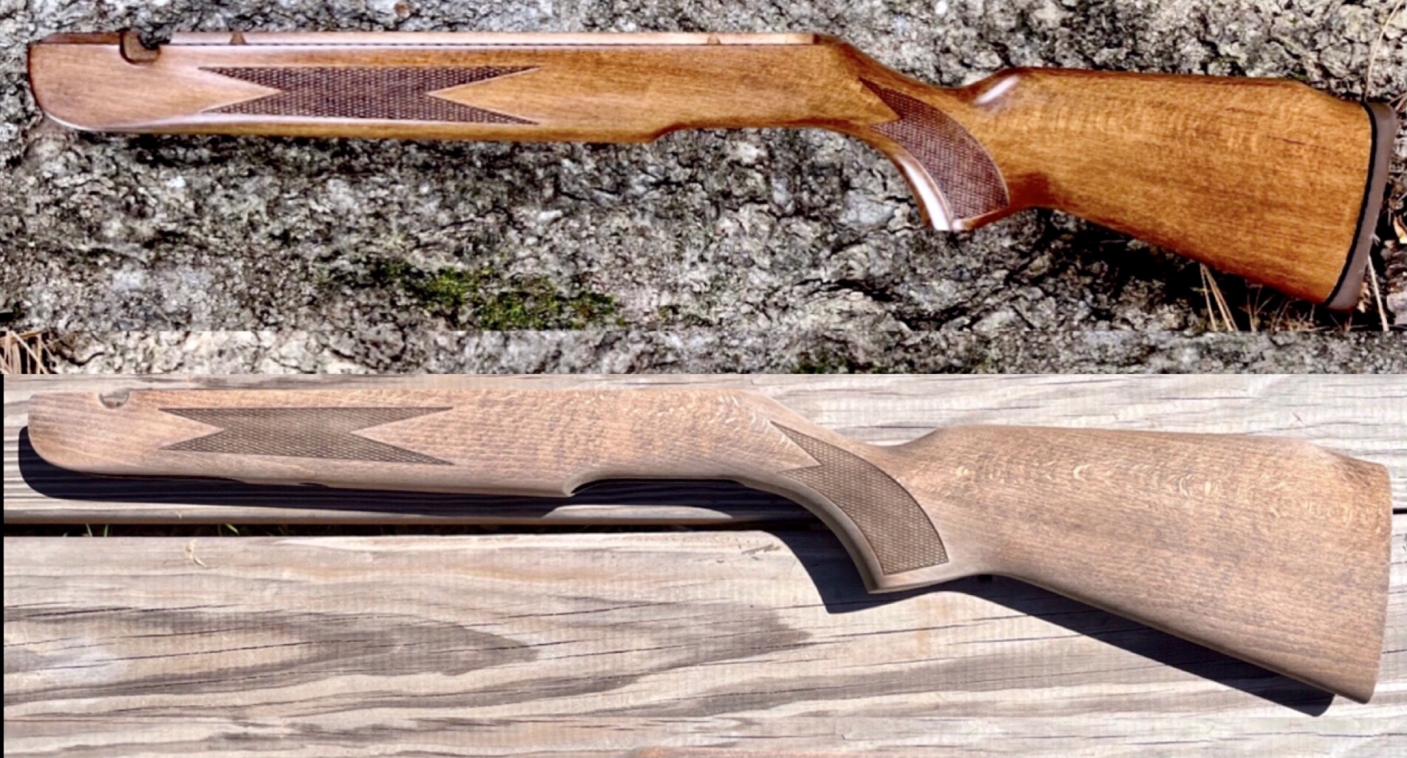

Beechwood is not my favorite choice for a gun stock. Most springers these days come with one however. Also, most come with colored spray on finish. Not very exciting to say the least. This is a HW30 with the deluxe stock. Plain Beechwood with a spray on finish, checkering and all.
This is the third refinish in the past three weeks. First one, I didn’t like the color. Second one, didn’t like the clear coat. This one I did the slow way. Stripped, sanded, flame striped, stained, stained again and then oiled 4 coats with three more to go. Allowing 24 hours dry time between every coat. This was my first attempt at flame striping to add some character. Might do more next time. Different stock though. This one is done. Third time is a charm. Also added an adjustable butt pad because with a diopter the stock was to straight. First picture is the original stock. Then stripped and oxidized. (wood was to white) Then the completed project.
Before and After.........
That looks great, I'll have to try the flame marking sometime. A well done job.
