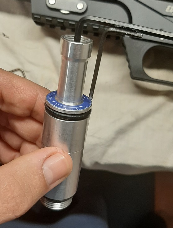

Ok, maybe its a language barrier. Remembering the reg now. There are no marking on it, right? So really no way to verify what your supplier told you. What markings did you use to change it 15 bar? Which way did you turn the inner screw? CW or CCW?
No harm meant by saying maybe it was done the wrong way. Was just a thought trying to help figure out your issue. Like BTB has stated there's no way in knowing if it was at 120 bar exactly from the supplier. Could have been higher. Gauge could also be off. Hard to tell exactly. What I remember on mine it did have a sticker on the top saying which direction to turn to lower and raise and marked like a clock with 12 points and every hour or so I believe was about 5 bar.

Now, regarding my reg, it's exactly like yours with the blue markings (photo bellow).
I turned it CW to decrease the 15bar, and following the marking in the blue sticker.
If I want to keep this velocity I may have to lower the reg, because If I just increase the HST velocity will raise but I don't know if accuracy will maintain.
I had a 1st gen and my reg did not have that blue dial on it. To "fix" your problem just follow what I said in my 1st reply. More HS to keep velocity at 270m/s, or less reg pressure to keep the velocity at 240m/s.
