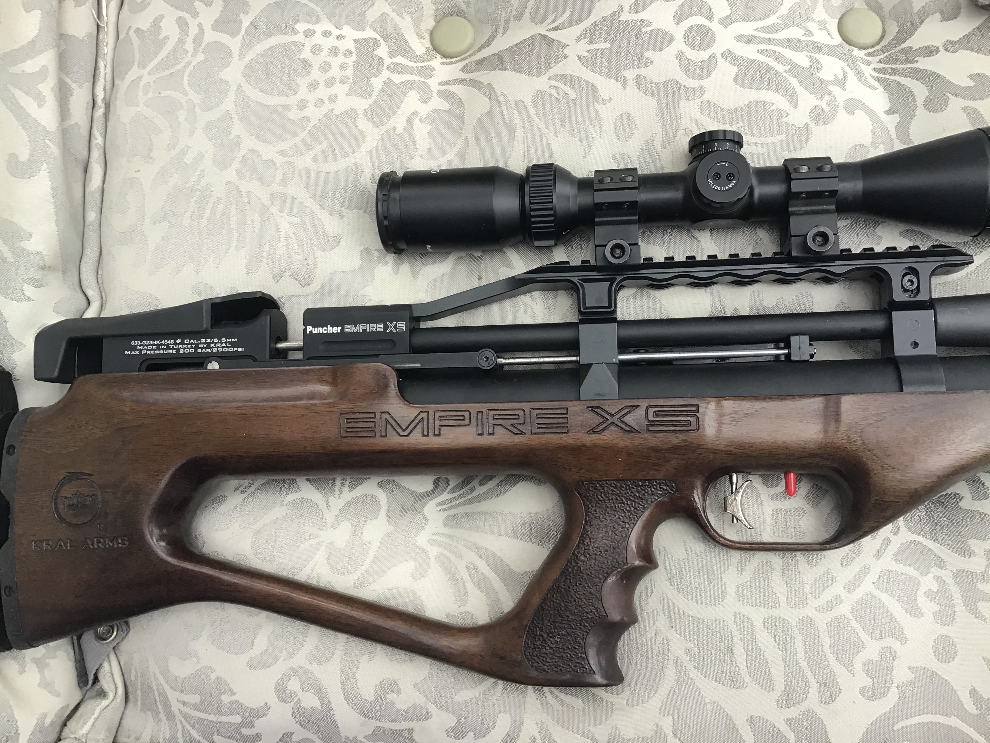

Ok, got it out for some pellet sampling and what not, couple observations if anyone cares...
First off, it’s a porky little bugger. Comes in at about 9.5 pounds. The big carrying handle is helpful.
It’s an air hog. Goes through air like pappy’s ’74 Impala wagon went through gasoline. Getting two mags per fill, but I swear I can hear the hammer dancing after every shot. Saw Troy’s mod, looks like something to try down the road.
Pellet fussy; I tried a bunch at about 10 yards to get it sighted and see what groups looked like. Some cheap wad cutters were a joke, didn’t inspire much confidence. JSB’s were ok, seemed to like Hades the best, not so much the Monsters. I was developing some buyers remorse at that point. Then tried some H&N Barracudas. It loved them, so much so that I went out to 25 yards to see what they’d do. Picking off sweet gum seed pods was a snap. Pretty happy with that accuracy.
Wasn’t thrilled with the grip, my middle finger wanted to be lower on the handle, below the indent, making it a little uncomfortable. Nothing some rasp work can‘t remedy.
Pretty loud, even with the moderator. An air cannon without it.
The shortness is handy, yes, bullpups are different...

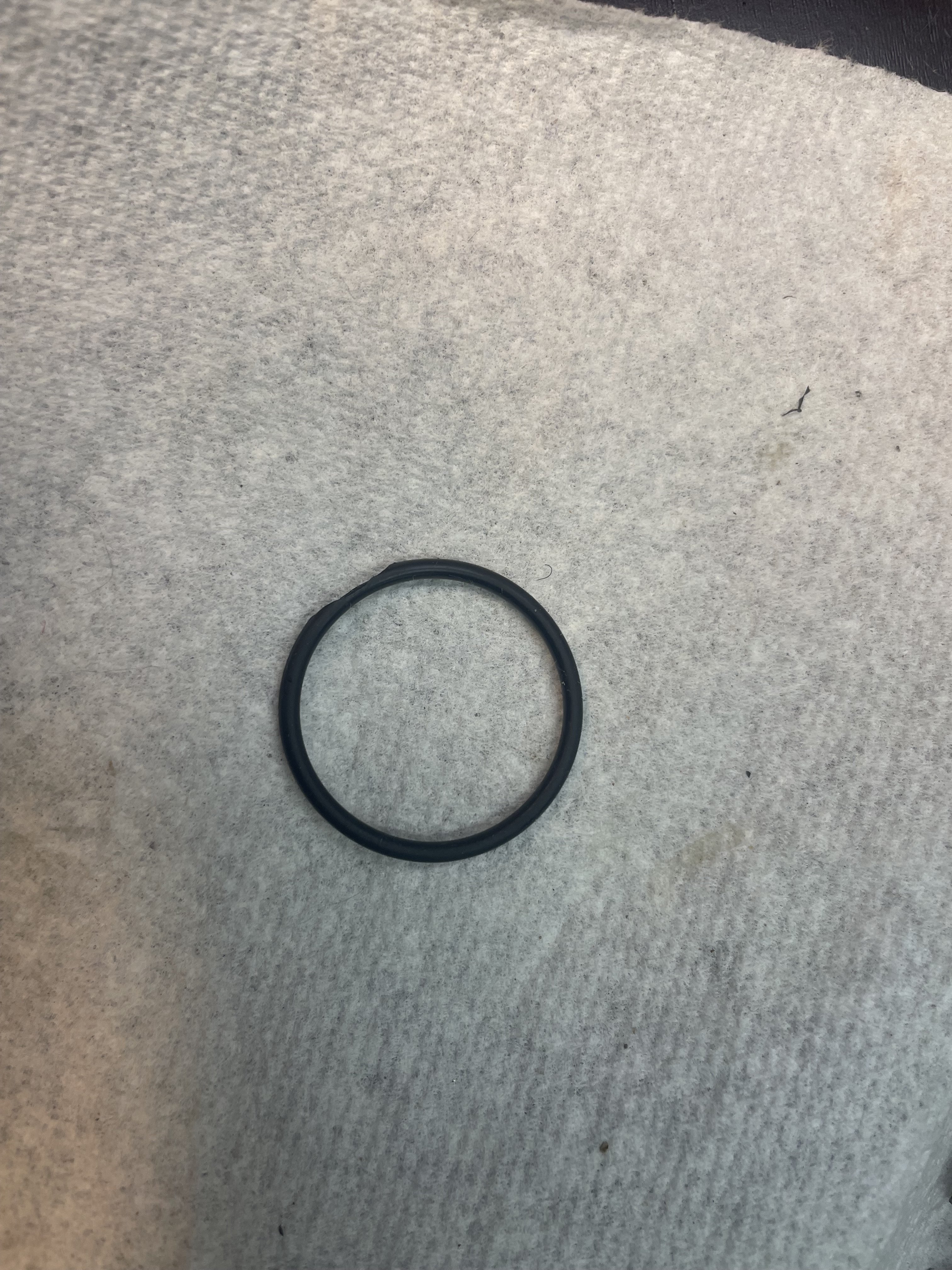

So a week in, it developed a leak. Noticed it yesterday when a shot sounded really weak, it was down to halfway in the yellow zone. Took the tube out, and a quick water test showed it was leaking at the fill port. Degassed it by tapping the valve a bunch of times with a soft hammer.
Turned out to be a little piece of Oring got stuck between the fill valve and the tube cap. The factory rings are junk. When I went to remove them they just broke.
Also, one of the the Orings on the tube cap was buggered, but I‘m not sure what it does. Replaced it anyway

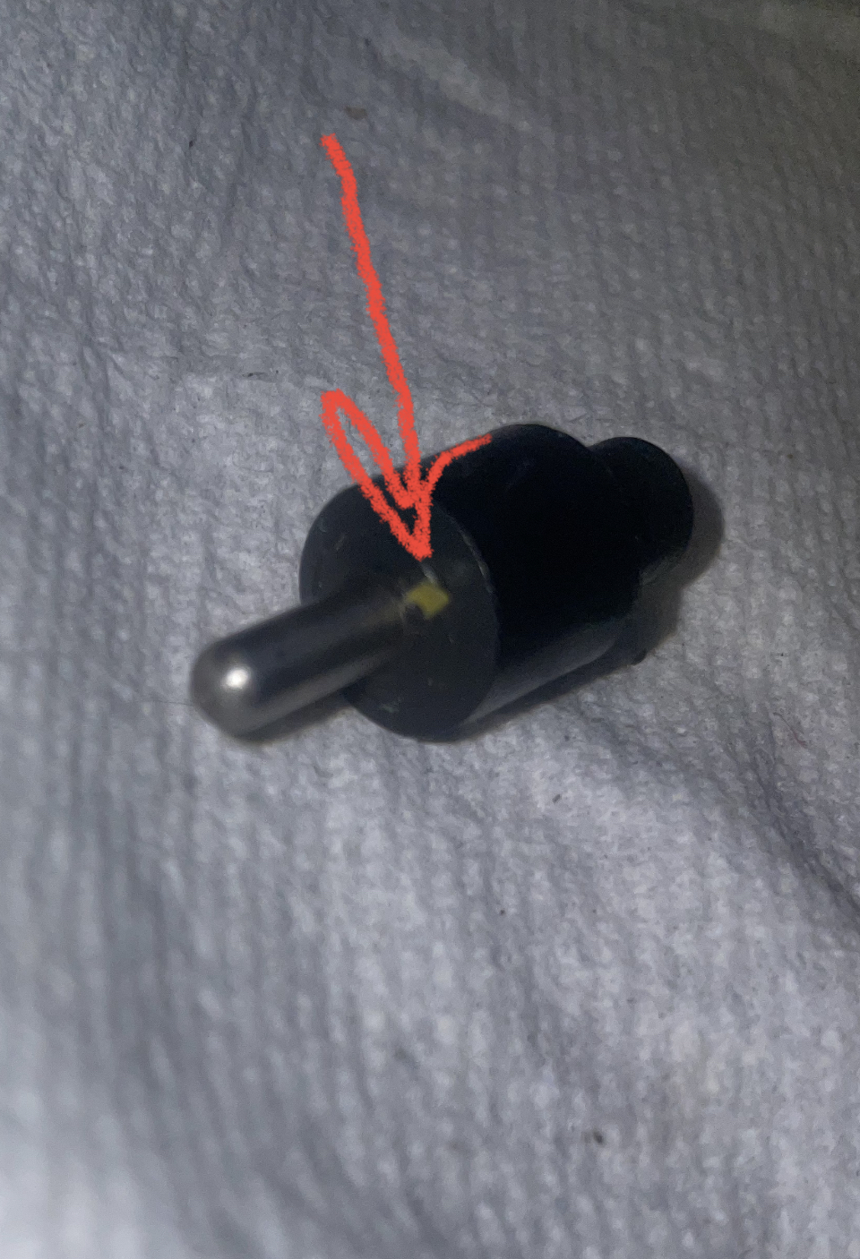

Mike, I agree about the large O-ring, but the yellow ones on the fill probe really are garbage. Very soft, one had a small tag hanging on it, and that may have been what got inhaled and caused the leak. The P5’s are a little stiffer and need a bit more of a push to get in there but a little silicone grease helped.
The video on YouTube regarding disassembly is very helpful. He mentions the burst disc as another possible leak point, I forgot to mention that it also was letting a little bubble out every 20 seconds or so. Snugged it down with a 4mm Allen wrench, it also stopped leaking.
