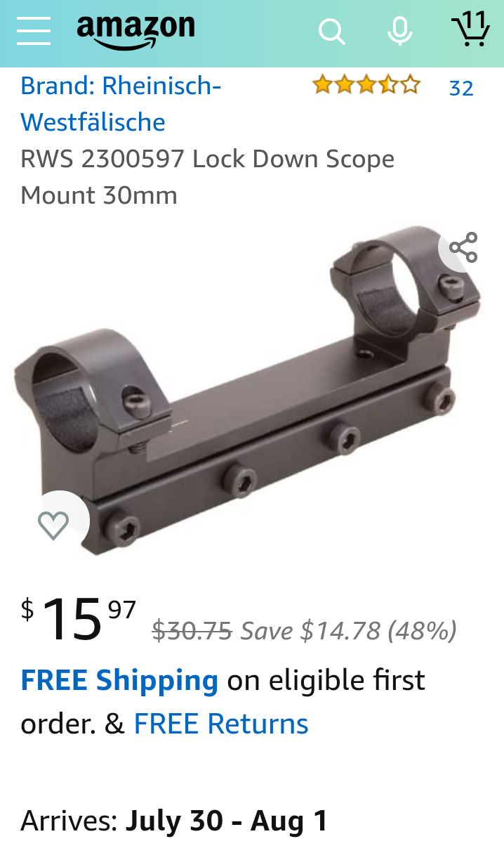

Buy a cheap $15.97 shipped (Retails over $30) droop compensating mount and be done. Or bend your barrel up.
You MAY have to Dremel it a little if that Vector Scope's belly is too fat. No big deal.
This
