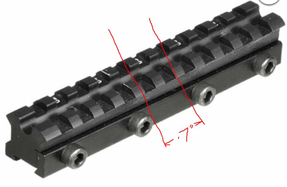

I've got my Dreamline out on loan right now or I'd post a picture. I had the same problem. I picked-up a DNT06 UTG drooper rail, 11mm to Picatinny mount. It gives you 10" extra elevation @ 30 yards. (Mine needed it!) I then cut the center out of the mount (.7") to clear the magazine. With the drooper rail on the gun I could use lower rings ('cause the thickness of the rail). If you go this route for about $20 you pick up about 30" @ 100 yards
. It is important to keep the over all length of the drooper rail the same as it was when it didn't have the middle removed to prevent an "S" bend in your scope tube :) The sketch indicates the middle section I removed from the UTG mount.
