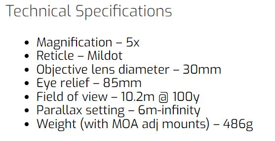

The 5x30 Pro is the longer eye relief model and it is available in the UK. I emailed Wes at Airgun Archery Fun to see if he'll be getting any.
Here are the specs.
