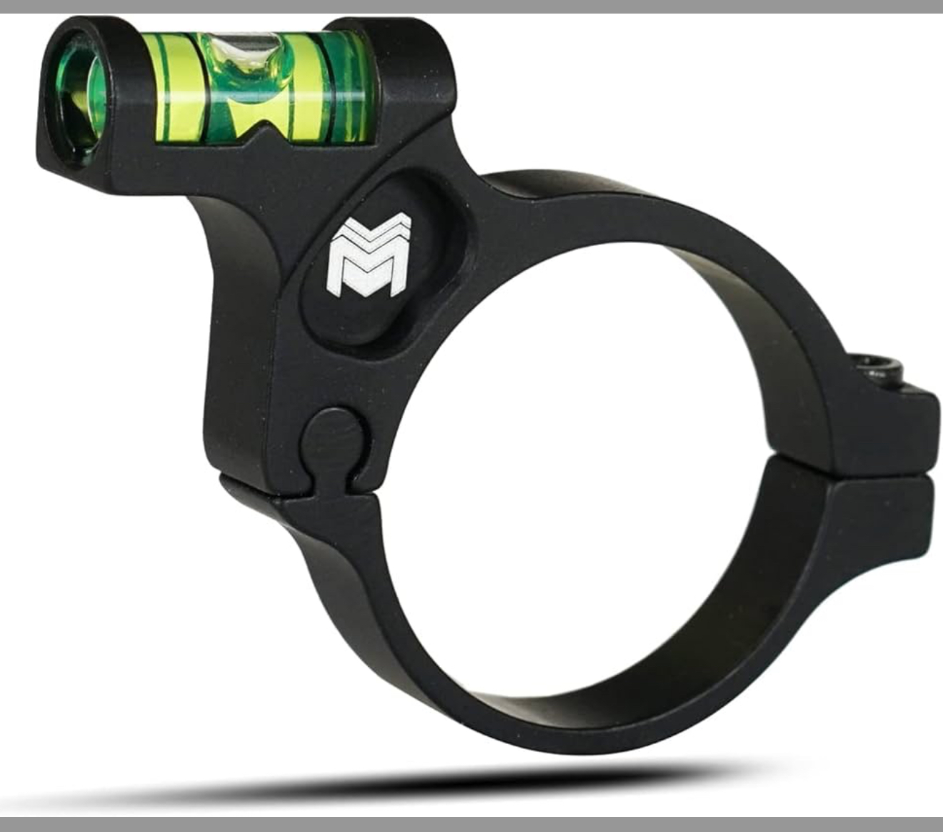

I have a couple Long-Shot Products LTD Micro Level levels and they rock. Its the original eyepiece mounted scope level with leds to show you where you need to go. The MDT fiber optic add on does something similar but it is on the outside instead of the inside. Probably impossible to find unless someone has one they want to let go. There was a modified version that ran upside down like it was right side up. No issues with re-levelling or it being off, the thing is solid and I trusted it in high level competition situations 100%. Has two settings for sensitivity (bench and field) and is easy to see when looking through the scope. Can't believe it took so many years for this item to be duplicated (and it really hasn't been).
