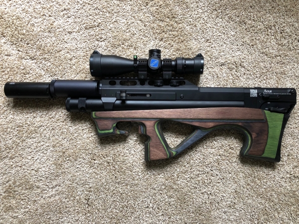

I got this today to try on my Lelya, which is the one I'd consider using it for since the R5M I have in .25 is pretty quiet in stock form. The Lelya 2.0 in .25 that I have has a bigger sound signature compared to the R5M, mostly due to a shorter expansion chamber past the barrel.

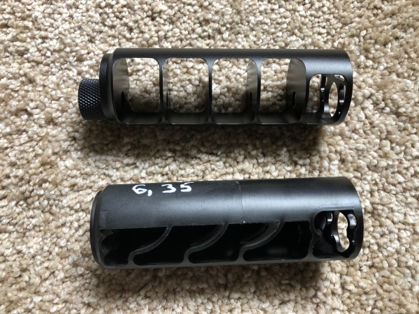

Below you can see that the adapter is anodized aluminum. The stock baffle system as supplied with the gun is a polymer compound and slightly a little lighter. Main difference you'll notice is that the baffle system itself is different.

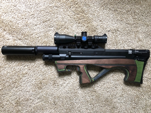

Below is the Lelya with the DonnyFL Tatsu attached.
Below is the Lelya with the DonnyFL Ronin attached.

1. The aftermarket adapter baffle system has a higher pitch on its own vs the stock polymer adapter so to my ears it sounds louder. I'd recommend using the aftermarket adapter WITH a moderator, otherwise it's not nearly as effective as the included polymer baffle system.
2. There is very little difference in sound between the Tatsu and Ronin, but the Ronin just edges out the Tatsu by a bit.
Personally I'd rather use the Tatsu which is smaller and lighter vs the Ronin unless I REALLY was worried about noise output.
3. The Ronin and Tatsu produce a lower pitch to the sound, which in turn makes the shot sound quieter to my ears.

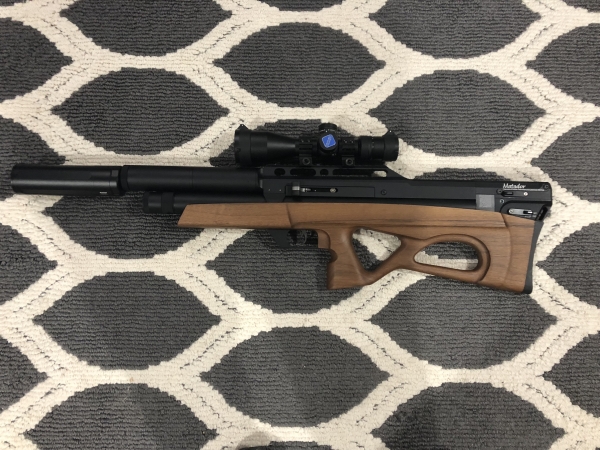

I put one on my R5M standard .25 cal. and I used a Ronin like NoLand above. It's pretty quiet stock to begin with, and this does make it more quiet.
I agree with NoLand on the stock baffles vs this one with just the baffle in. There is a different sound to the metal one. I'll be messing more with mine this weekend, and will give a better update.
