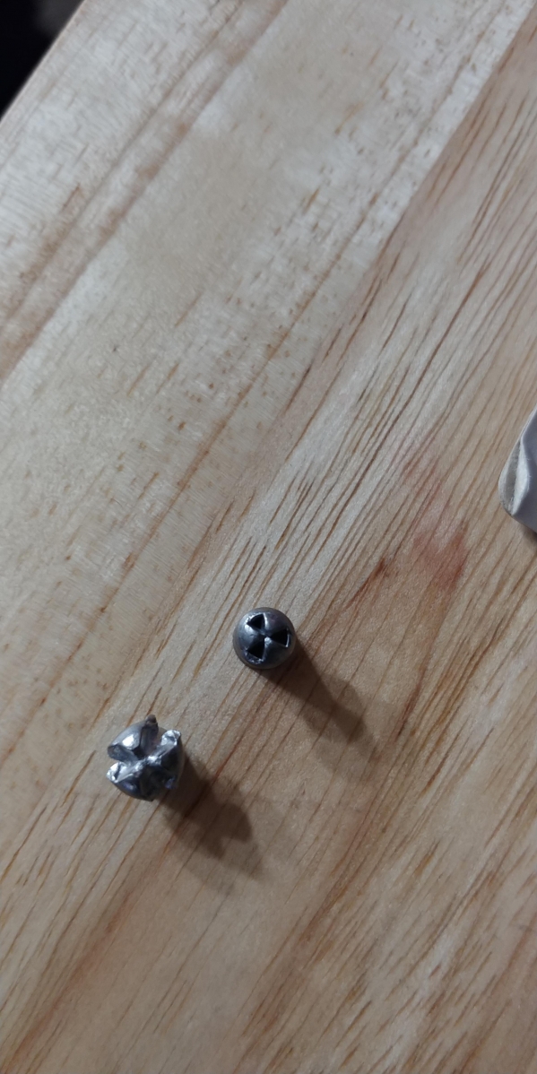

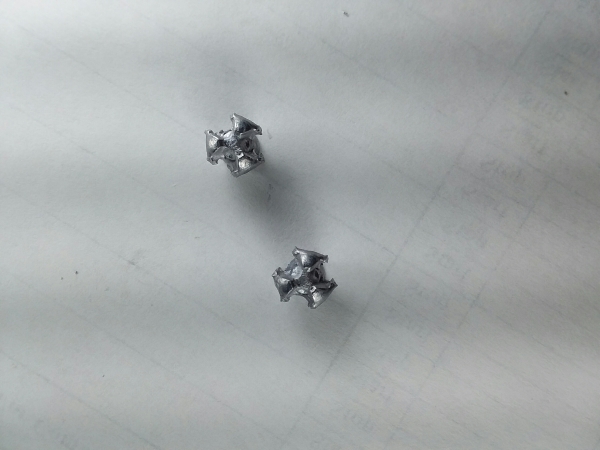

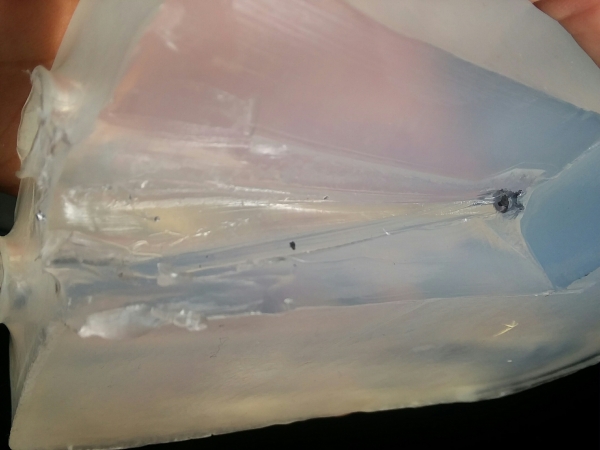

The Hades are performers. They don't fragment, they do open up. I spined a squirrel yesterday, no pass thru. Doing 727fps/18.65fpe. They act more like a mechanical broadhead. Below are pics of the recovered pellet from the squirrel and an intact pellet. Also ballistic test from Tofazfou shooting them into glycerin soap.

So awesome, thanks for that!
