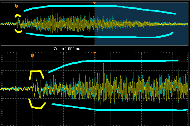

So a while back I was working on a moderator design for the American Air Arms Slayer, and stumbled across something very interesting about air tube ping. You see, the Slayer is a worst case scenario for tube ping in certain respects, because aside from dumping a "big bore" amount of air with every shot (200FPE) it uses a balanced valve which should produce more of a square waveform opening event, where the valve both opens and closes much more rapidly. This should in turn create more severe ping.
You can see the uncorking event (pellet exiting the mod, presumed) highlighted in yellow, and the ping highlighted in teal. What was unexpected, but actually entirely logical once I thought about it a bit, is that the ping doesn't start at peak amplitude, in fact it starts nowhere close! This is because air is removed asymmetrically, but progressively, from the tube. Put more simply, the air in the tube all shifts in one direct but the air closer to the valve shifts more than the air furthest from the valve. This pressure discrepancy takes time, a couple bounces back and forth, to coalesce into a uniform wavefront which is the really loud and obnoxious ping we all know and hate.
So that is great and all, but what does this mean for you? Two things I think. First it means the people who hear substantially less ping with their Huma regs may not be crazy at all, the Huma design may, by accident or intent, act to prevent that air movement from coalescing into a wavefront and thereby prevent the ping from occurring. Crazier things have happened. The other thing it means though is that, because you have a reg and so the air movement in the high pressure side of the tube is not particularly violent, it should be pretty easy to design a depinger which increases the acoustic impedance from one end of the tube to the other so much that the wavefront never really forms and ping never really gets going.
Just my 2c. :)

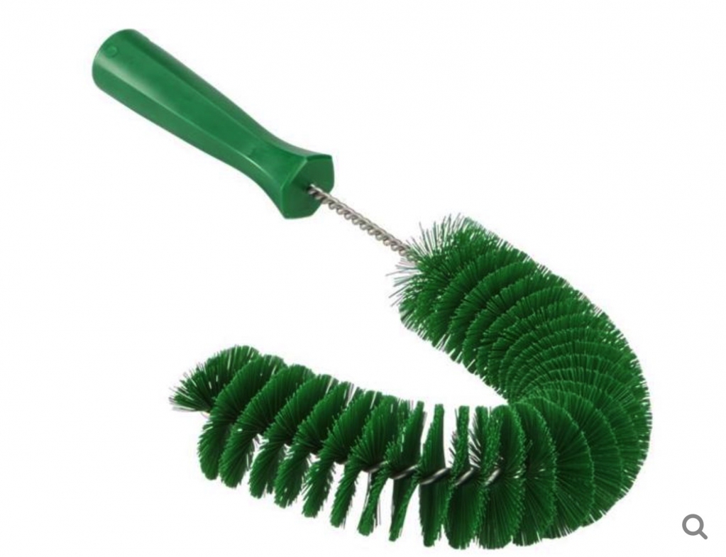

I already tried different things to get rid of the ping but this morning i got rid of the ping completely by the good old brush in tube solution, i was confident since it worked with my Hatsan at44 before ;-)
What's left is the slamming hammer and the pellet hitting the target, that's all since the Bat silencer takes care of the rest.
Shorten the brush to around 10cm.
Brush diameter 35mm
Huma setting on 110 Bar, Energy 34 Joule
Easy peasy lemon squeezy.
The ping is from hammer, not the tube vibrations. The brush does not work. If it was the cylinder vibrating, use a soft vinyl pipe to stop the cylinder form vibrating. This brush thing is a joke.
