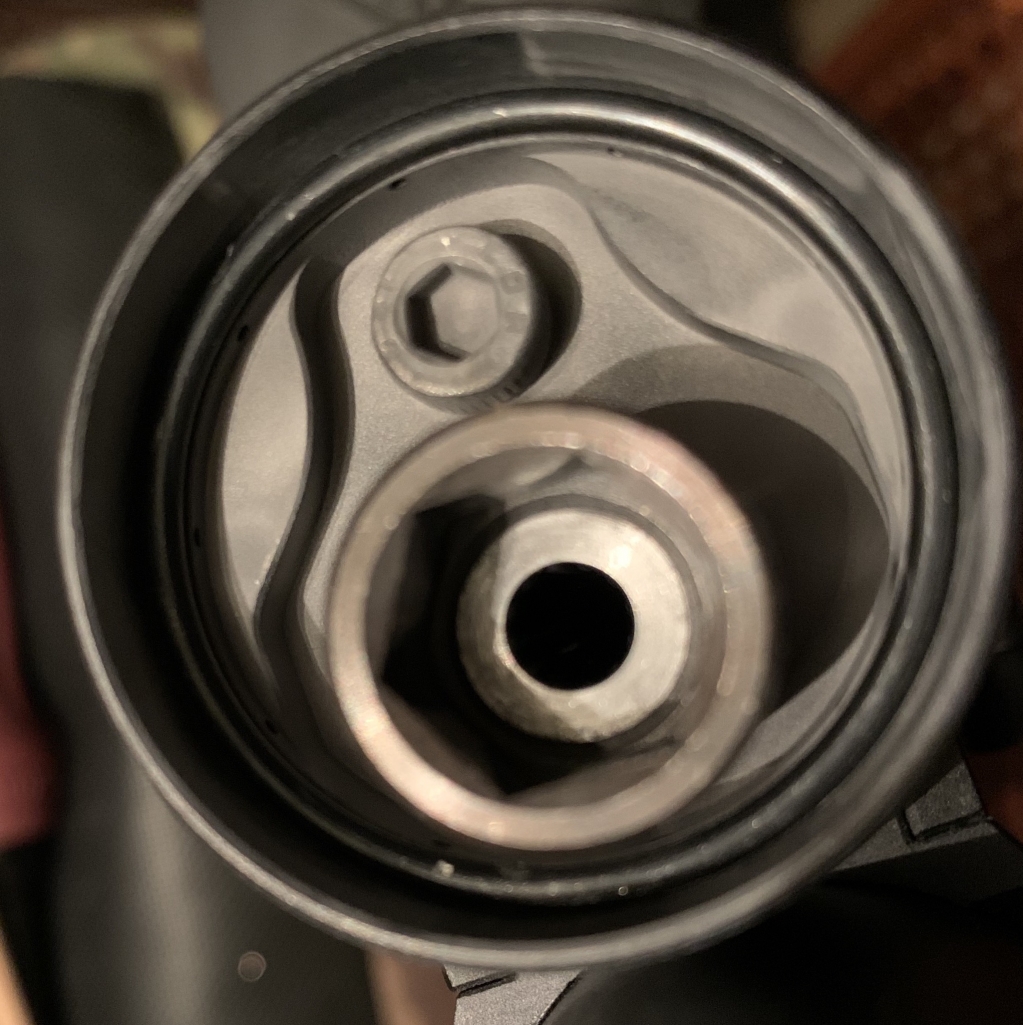

Front view of the Bat core insert:
Backside of the core:
Sideview:

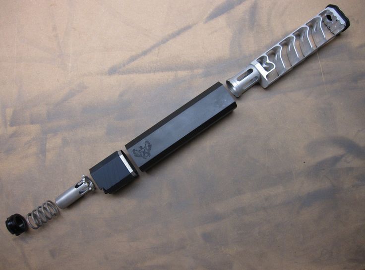

Comparison in height of the Bat and R5M Standard moderator:
...and just showing off:

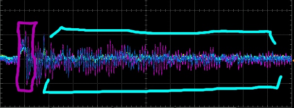

I did a bit of searching to understand the differences in db levels.
This is what I found:
What is a decibel? Zero decibels (0 dB) is the quietest sound audible to a healthy human ear. From there, every increase of 3 dB represents a doubling of sound intensity, or acoustic power.
Yeah, wrapping your head around dB and sound is a bit of a trick, as it is a logarithmic scale. Were you to be put in an anecohic chamber with anything close to a 0dB sound level, you'd actually start to vividly hallucinate because (apparently) the human mind can't process the absence of sound. Fun stuff.
The other thing about capturing the peaks off these moderators is that very very few sound meters can do it. Even the meter AEAC uses isn't actually fast enough. So what you end up doing is comparing, not the peak (highlighted in purple), but some average of the post-peak-sound (highlighted in teal).
This probably unfairly disadvantages the Edgun Bat design, as it is purely an air-handling design, it has no sound damping. The blast baffle symmetrically strips air, and then the subsequent baffles use cross-flow to drive air up and over to the offset side of the shroud. The design is almost identical to the Silencerco Osprey actually, which is a reasonably effective and very popular firearm suppressor. (the stuff on the left hand side of the Osprey is a recoil booster to help a browning tilting action pistol cycle with the extra muzzle weight of the suppressor, it isn't meant to improve suppression)
Either way, good report and GREAT photography! You really make the Edgun look fantastic. :D
