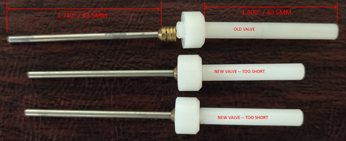

I bought the last 2 R3 valves that Brian at Edgun West had in stock, but they do not fit—the metal rod and plastic spring guide portion of the new valves are too short and do not fit in the regulator properly. While the plastic spring guide portion is barely long enough to engage the valve guide in the middle of the regulator body, the steel rod of the new valves only protrude 2mm from the regulator and I have not even trimmed the valve rod yet. They should protrude 3 to 3.5mm after trimming.
The old valve has a steel rod that measures approximately 43.5mm, and the plastic spring guide portion measures approximately 40.5mm. See the attached picture.

I was able to make the new valves from Brian work by transferring the longer steel rod and brass piece from the old valve over to the new delrin portion of the new valves. It's a simple press fit, with the ribs on the brass portion biting into the delrin. With the old longer steel rod transferred to one of the new delrin pieces I had the necessary 3mm to 3.5mm of rod protrusion from the back of the regulator, and the shorter spring guide of the delrin portion of the new valves was still long enough to engage into the valve guide in the regulator body. Rifle is back up and running and shooting great.
Brian also said that Ed isn't going to make any more R3 valves (yikes!) -- but Brian also said he was going to start modifying R5 valves to work in the R3s, which wouldn't be a bad idea. The longer tapered shape behind the sealing face of the delrin portion of the R5 valves is much less prone to breakage than the R3 valve design, but because the tapered portion of the delrin is longer the R5 style valve will need a shorter valve return spring to work in an R3.
