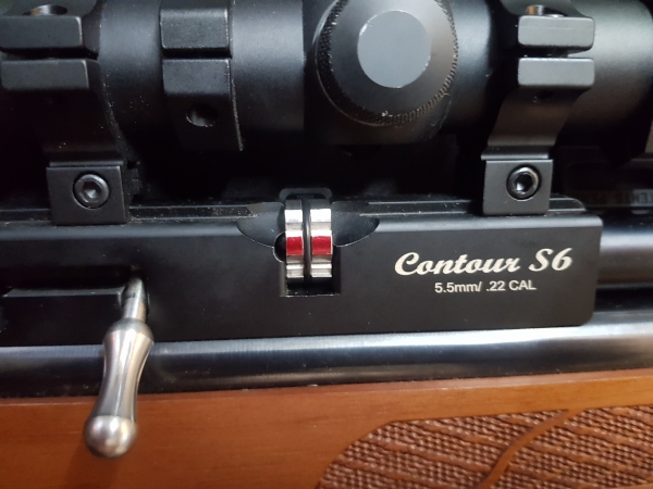

The EdGun clips are similar to the Taipan Mutant/Veteran, Wildcat, Sumatra, and the older Brocock airguns like the Concept and Contour models. I used a red Sharpie marker on one of my Brocock Contour Elite S6 to mark an area of the clip so I would know when the last shot is coming up. I guess you could use a silver Sharpie on the black EdGun clips to stand out. You would then have to index the clip when placing it in the breach area and time it for your last shot. Works well on my Brocock Contour.
