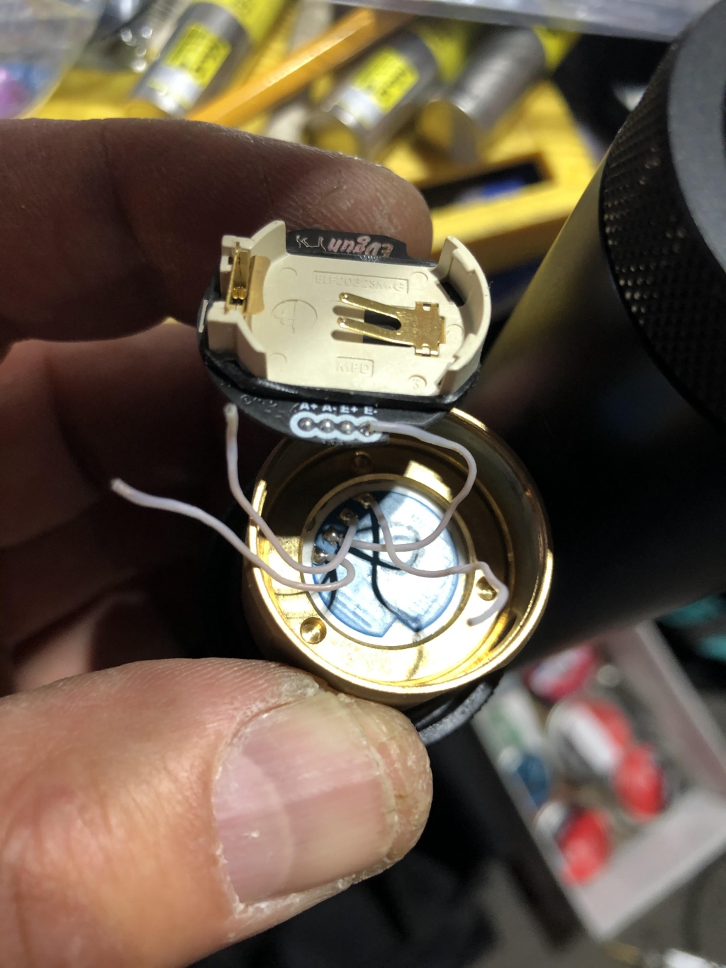

Had to pop the top off my fancy electronic gauge to replace the battery today. As gentle as I was a wire broke off, started looking at the other wires and 2 more broke off. After looking at the soldering job it was very poorly done. Actually, the solder job was ok, it was the wire itself that failed at the solder joint. It looked like only a couple of strands were in the solder. Now to repair it and solder this up correctly. You would think that a limited edition (one of 700) would have had some special care during the build.
