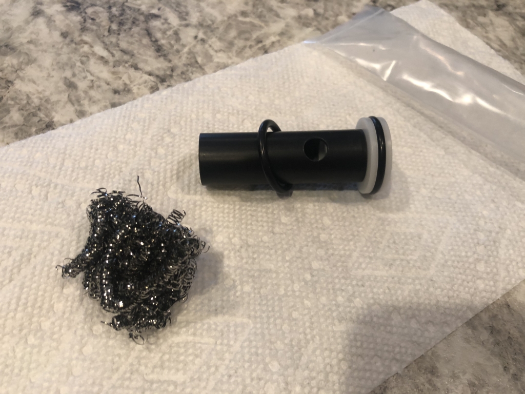

I picked up this Edgun Leyla depinger from Edgunwest but have been unable to figure out how to install as it did not come with any instructions. Anyone seen one of these and familiar with setup and install? See pic attached of the depinger....
Thanks Art, but I was unable to get that link to work. I believe there may be a few people who installed this depinger and got it to work great. Like most Leyla’s, mine is super accurate but does have an annoying “ping”. The install should be easy but I don’t want to mess anything up so I’d like to see some sort of install instructions.

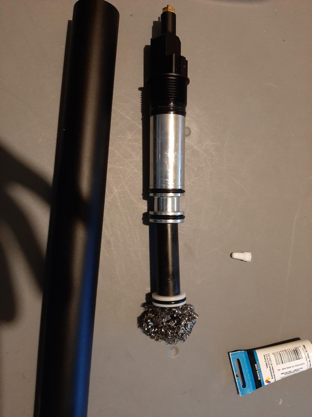

I asked Brain and he said the wool goes in first then the depinger. I've never taken apart an Edgun and had mine installed in about 5min. These guns are really simple!
AirgunnerPCP - thanks for the pic...that’s helps. I agree these guns are simple and super easy to take apart. Let us know how well the depinger is working for you?

The wire bundle goes in loose and the oring is just an extra.

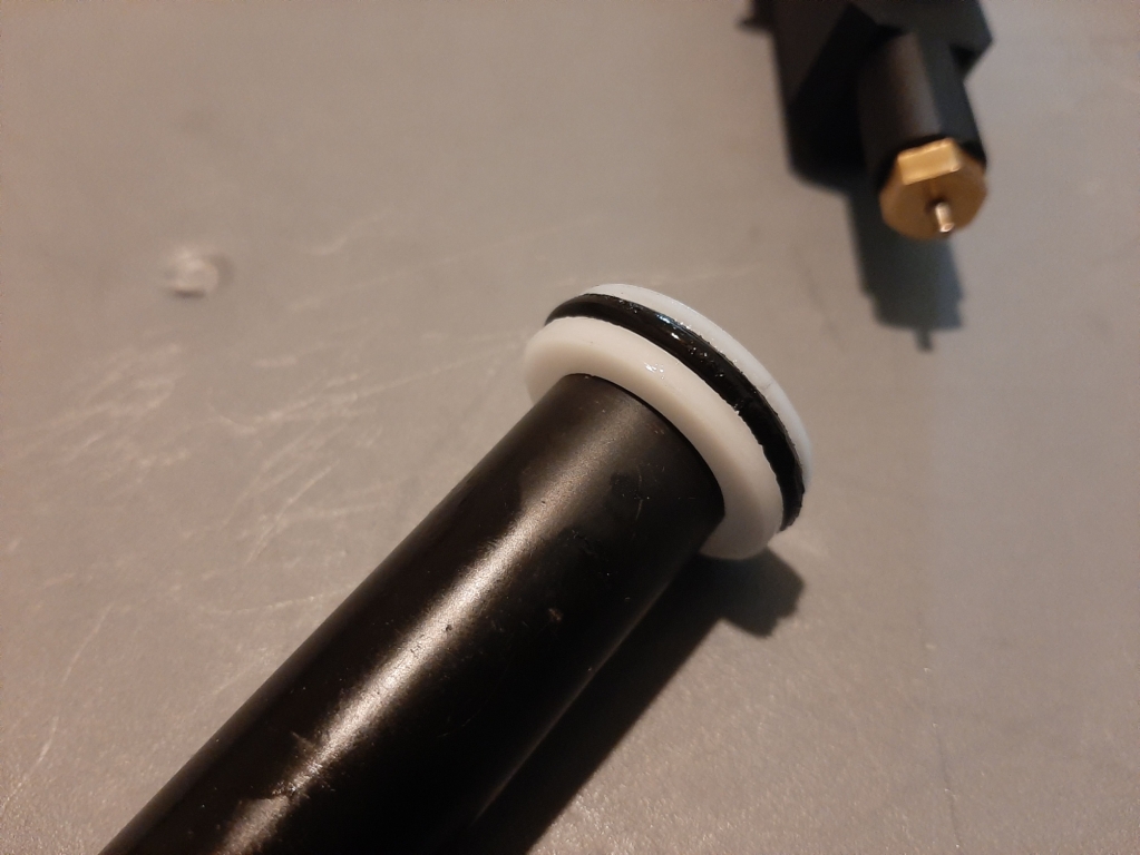

As far as getting it installed, mine popped right past the lip in the air tube. I just pulled mine apart again and can't find any evidence of an interference fit on the depinger. Below you can see how it fits in the tube. When sliding it down the tube, once it hits the lip it just takes a little more force to compress the oring and slide it in. Usually I tap valve assemblies to compress the Orings in tubes on airguns just because it's less effort but it's entirely possible to push the depinger in without doing that just pushing with your hands.
