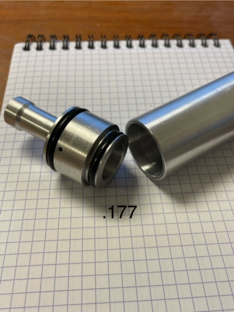

EDgun Edgun Leyla 2.0 .177 Huma reg question
While never having a Lelya, I've been inside a R5M Standard .177, .22, Long .22 and Super Long .30. All have had the same regs. Don't see why there would be any difference as I believe the Lelya 2.0 uses the same reg as them in all calibers. Unless im misreading what you mean.
No, you read it correctly. I’ve just heard recently that it wasn’t as simple in the 177 as it was in the 22 and 25, which made zero sense to me seeing as how they are all the same regulators.

I was thinking about picking up a Leyla in .177 and like all my rifles, dropping a Huma regulator in it. From doing a bit of research, all I’ve found is that this isn’t a straight drop in like it is in .22 and .25. Can anyone confirm or deny this?

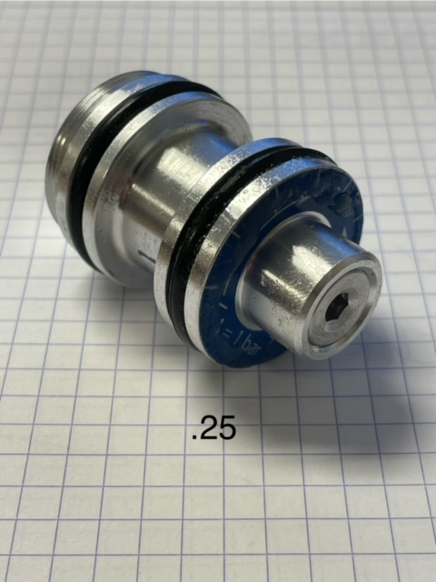

Here is the reg in question. .177 lelya purchased in january of this year. The .25 cal is older. The newer reg is not threaded, just a press fit into the plenum/spacer with an o ring. The threads on the valve housing (to accept the plenum/spacer) are different as well. I assumed that new regs were rolled out somewhere along the line.
Reactions: SMH and Ezana4CE

The reg that came out of my gun looks exactly like the the reg in the picture marked .25. The reg and plenum in the picture marked .177 looks more like a first gen Lelya reg. Just take your gun apart and see what’s in there. The tube has a degass screw and the whole job only takes a few minutes.
Yeah, I’ve got a 25 and it’s super easy. I don’t have the 177 to take apart, which is the reason for the question.
