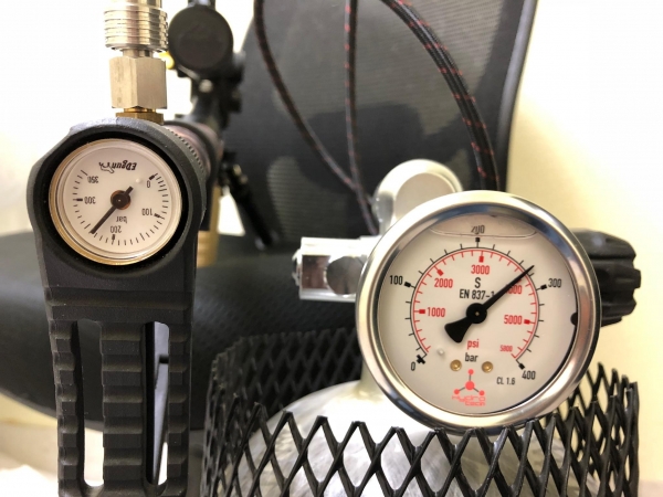

The gauge on my Wildcat and Cricket have same pressure with my Omega gauge when filling. However, the gauge on Leshiy doesn’t ... I just got this Leshiy a few days ago brand new. Is there a problem with the gauge on Leshiy??? I also tried use Hill hand pump and I have to hand pump up to 300 bar to get 250 bar on Leshiy ...
If i remember correctly Wika specifies a 4% tolerance on the mini gauges. This means that the spread at 250 bar should be within 240 and 260 bar. I have no idea what other manufacturers specify for accuracy but I guess it is the same or worse.
You can't expect the mini gauges to be as accurate as for example the 2.5" gauges. Especially over time the mini gauges will start to be less accurate.
I think it's a good idea to add a little sticker next to the pressure gauge and write down the correction on there for your own convenience. Or as mentioned above try to have it swapped for a digital gauge. These appear to be way more accurate at this time.

"broekzwans"If i remember correctly Wika specifies a 4% tolerance on the mini gauges. This means that the spread at 250 bar should be within 240 and 260 bar. I have no idea what other manufacturers specify for accuracy but I guess it is the same or worse.
Great tip - When I have a gauge that is "off" based on my fill gauge (3" Wika) I use a sharpie and write on it. Like +100 or -50 depending on how the gauge reads different. Since I use the 3" gauge when tuning I can get the same fill even without that gauge. (I have a 2nd fill bottle that does not have a gauge)
