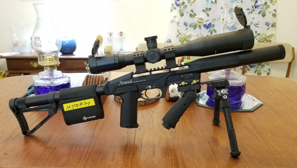

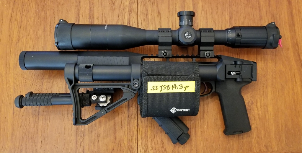

After trying three different calibers, my favorite configuration is the 350 mm 22 caliber barrel, shooting the jsb 14.3 around 825 feet per second. I have a few attachments that add mass to the frame and it is very smooth.

There is no sound that is heavily transferred down the air tube. Unless you really crank down the HST there's nothing much to the hammer and valve sound. I have noticed that the Huma reg in my Leshiy recently developed a refresh sound after each shot. I definitely didn't recall hearing it for the 3-4 months I've had it and reg was set and installed the day I got it. I may check it out at some point and put it in the reg tester but the refresh woooosh sound is quick, maybe 1.5 seconds. It would never hinder your next shot - just a bit annoying.
Anyways, I wouldn't be concerned about it. And for the noise of the Leshiy firing I'd offer two routes depending on barrel length:
  • 250mm Barrel - get the DonnyFL v2 Extended tube with felt. Install that with the tube extension (like the picture above) and you'll have a backyard friendly 20fpe gun or a pretty quiet 30fpe. (This is with the .22 250mm barrel - for reference).
  • 350mm Barrel - Get the DonnyFL Adapter for 350mm Barrel. Install this with the barrel and then use any 1/2x20UNF moderator. For reference I use a Tatsu and with .22 16gr JSB @ 20fpe it's very indoor quiet. With .177 10.34gr JSB @ 900-950 fps there's a small pop, but nothing obnoxious.
edit: since I was fixing a typo, I thought I would add that the worst part is the sound of the pellet hitting the paper target. My trap behind is a mix of sliced up ballistic fabric and some loosely bunched old towels - super quiet - if you shoot straight into it you don't hear a thing.
