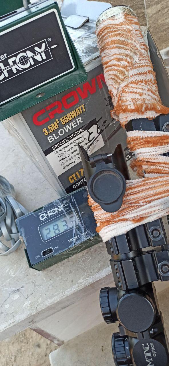

it is very easy to reach high speed with leshiy 1.250mm & huma reg.
300 m/s possible with 18 grains

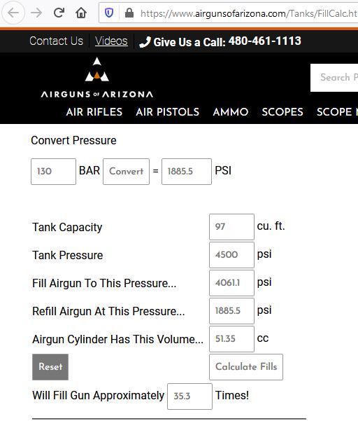

If you want to use it the air cylinder volume on the Leshiy is around 41 cc with the original regulator. With the newer Edgun regulator or the standard Huma or the sub-12 Huma the amount of air it can hold is greater.

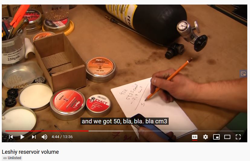

According to Ed the reservoir volume is actually 50 bla bla bla cm3 :)
inner length from regulator to end cap 120 mm - inner diameter 24 mm, total volume 54,25 cm3
minus protruding part of regulator - length 26 mm diameter 12 mm (average), total volume 2,9 cm3

Good for you but its not about you - its about Liontracks asking how many fill from a given tank volume and in that sense your sh%t load is not very useful - but 51.35 compared to 41 cm3 makes a difference

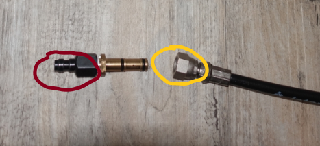

If I'm understanding your question correctly you need to slide the collar circled in yellow back and then insert the back of the probe adapter (circled in red). Then release the collar.
Is that not working?
I'm going to say that the piece circled in yellow is not a Foster QD, but rather a 1/8" BSP. If so you'll need to screw off the black piece circled in red from the brass probe and screw the brass probe directly into the 1/8" BSP fitting.
If I am wrong, what Scouty said is perfectly accurate.
There is a scuba shop close by that fills up to 4500. If I get the great white, how many fills will it give on the leshiey ?
To finish this with the correct leshiy tank volume number, I put in fill to max 280 bar, refill at the factory regulator setting of 130 bar - if your hammer spring setting is spot on you will get more useful unregulated shots down to 120-115 bar or so
..and likewise more fills if you fill to factory max at 300 bar but may be harder on the o-rings

I removed the black nipple and now the brass probe screwd into the pump fitting.

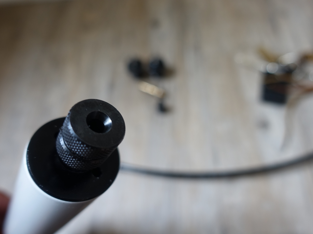

When I insert the filling probe into the filling port, it goes in and out loosely, does not click in place. Is this how it supposed to be?
Yes, the pressure builds up between the two o-rings and holds the adapter in place, just be sure to put it all the way in

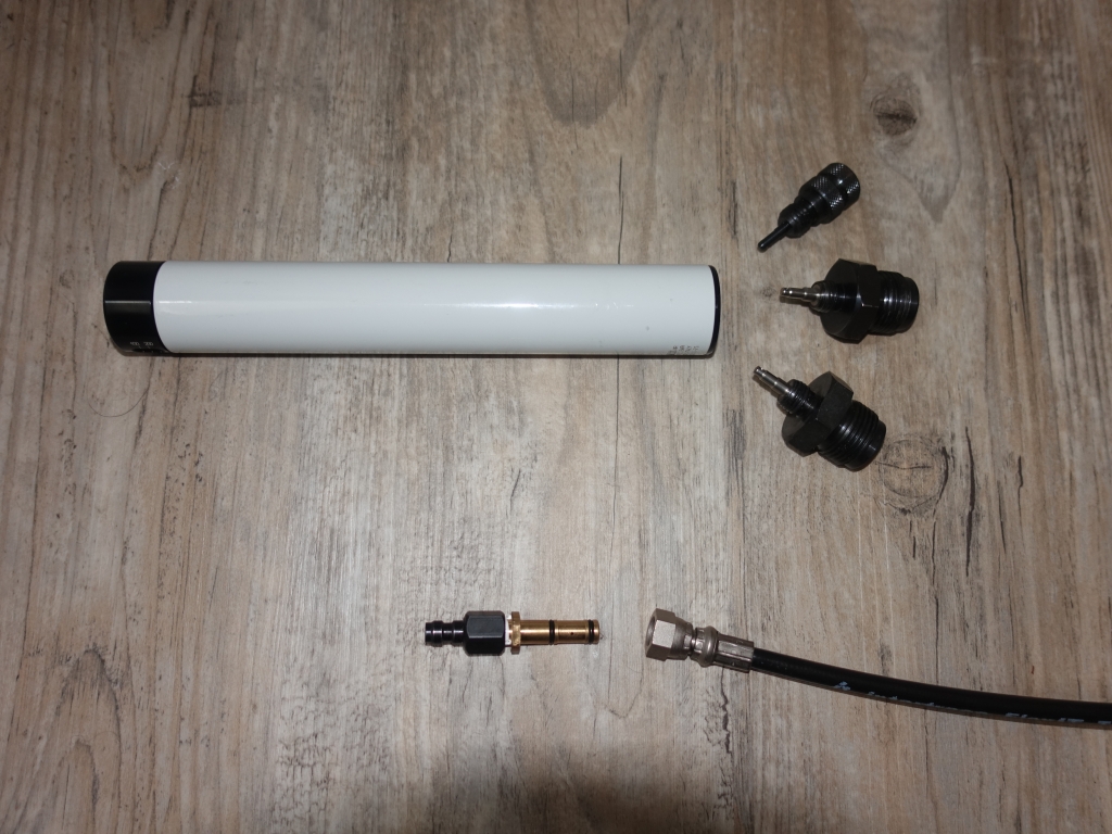

Please look at the photo. At the bottom there are the hose from the MK4 pump and the connector that came with Leshiy.
What part do I need to connect the two?

Liontracks - looking at those Pardini adapters it looks like either the middle or bottom on is a DIN300 adapter. Assuming you have the Great White with Joe's valve you just unscrew the DIN300 to Foster QD from the valve, screw in the Pardini adapter and then screw the Pardini tank into that.
Note - if the output on your air tanks valve is different than DIN300, please post a picture.

So now the question is, if the adapter is a DIN300 and the fitting on the pump is a 1/8" BSP how do you connect the two?
Dang - it looks like you are in for a bunch of adapters to make this work. First thing I would do is get a 1/8" BSP to Foster QD and install it on the pump.

Then you will be able to use the Leshiy fill probe with the QD adapter as it came pictured.
For the Pardini you will then need the two following parts to build an adapter with a QD fitting:
http://www.northshorecompressor.com/products/17B477D422-F-NPT-x-DIN-300-F.html
http://www.northshorecompressor.com/copy-of-1-4-quick-connect-nipple/
