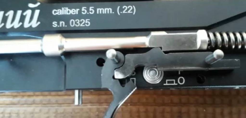

Are you quite sure that the trigger releases the sear completely and not dragging (slowing down) the hammer?
