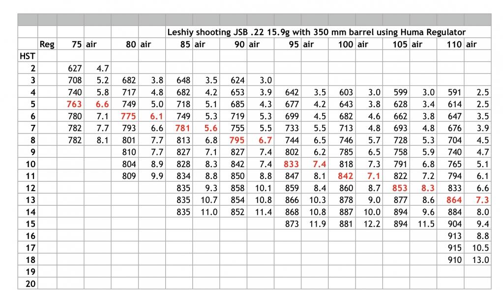

To explain this take a look at this snippet of Jack.K's tuning chart. Don't worry about the reg setting as that was specific to the caliber, barrel length and pellet that he was using. It's just the concept here that matters.
Each number under HST is a click counter clockwise from zero. At clicks 6, 7 & 8 there is no significant increase in FPS so 782 is the first velocity peak for this regulator setting. From there the HST is turned back down to five clicks, which is 97% of the first velocity peak.
At 97% or so of that first velocity peak one tends to get less energy spread and can take a shot or two off the regulator with no velocity spikes..

Yes. Now look at Jack.K's chart in full and notice that as the reg setting increases the number of HST clicks needs to increase as well. Red number indicates the FPE where the hammer spring it tuned to ~95% to 97% of the first velocity peak.
Also, note that the with that pellet and barrel the least bar per shot is at 85 bar reg setting. But at 110 bar it produces more energy per bar used with the same pellet and barrel.
Two ways of thinking about efficiency.
