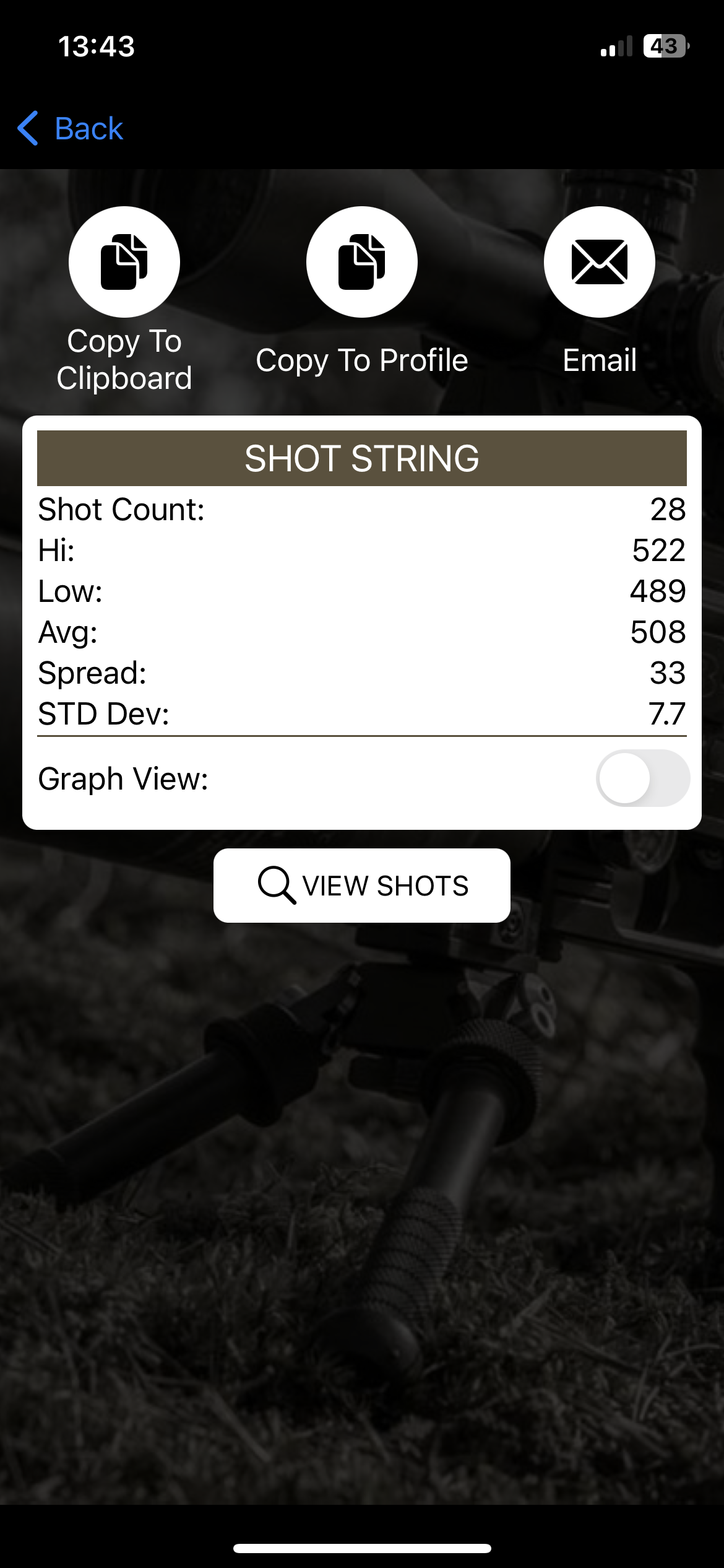

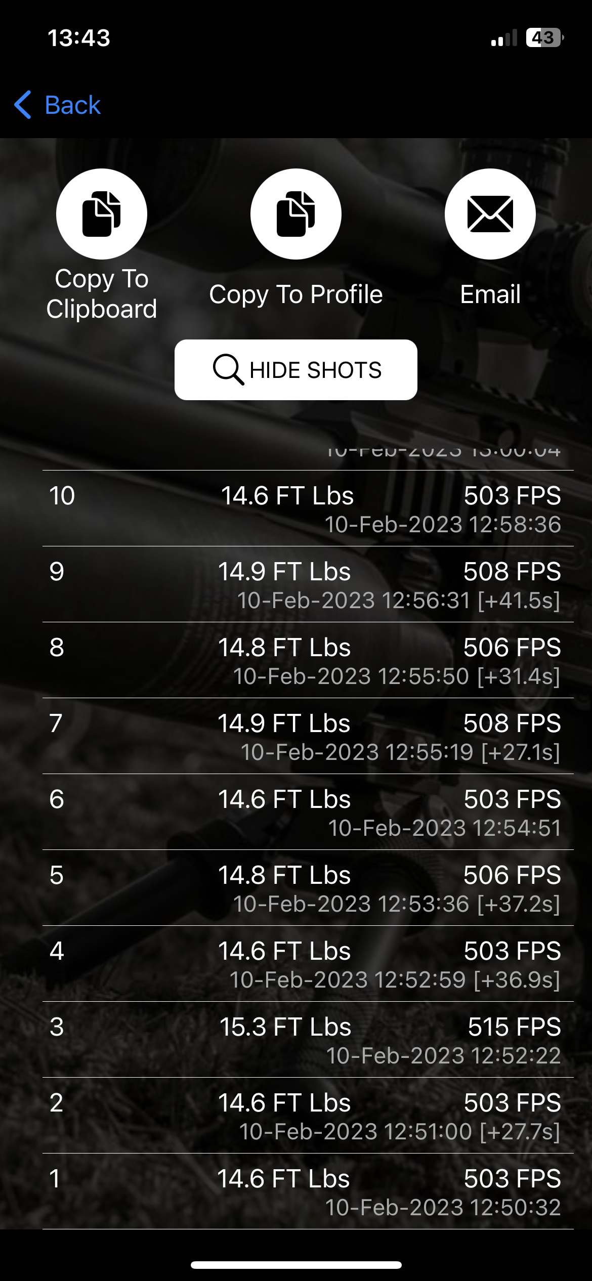

With the 250mm 25cal I have polymags running at 508fps. Reg set to 110bar.

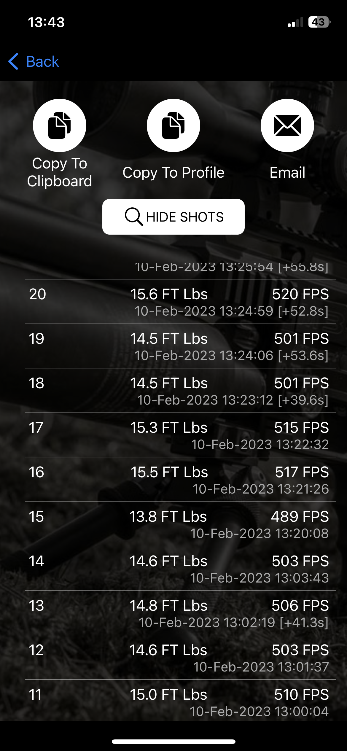

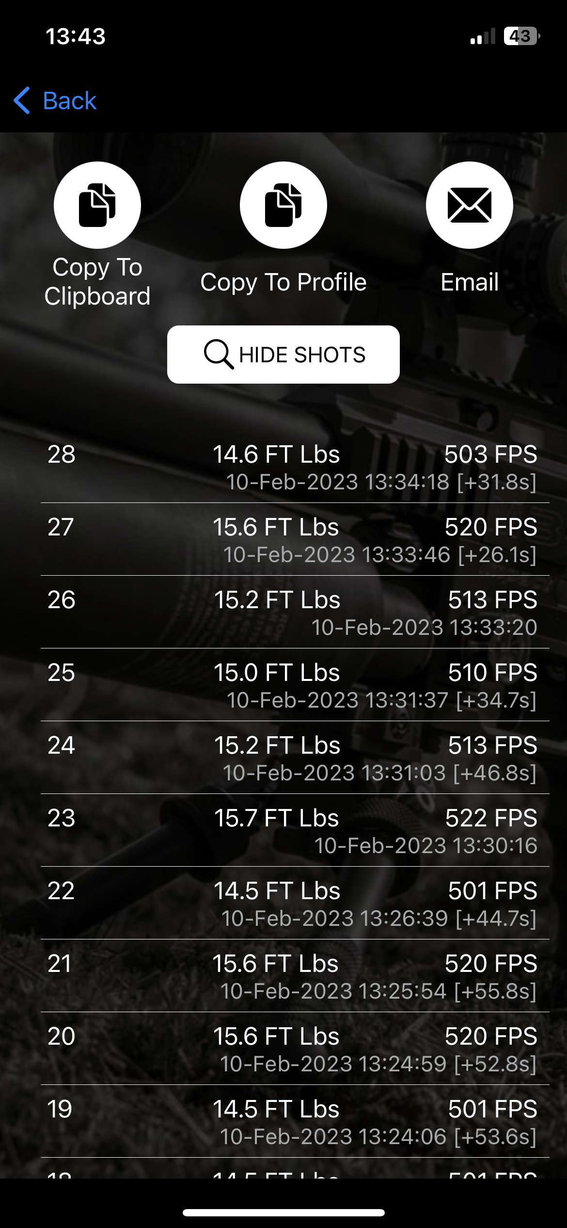

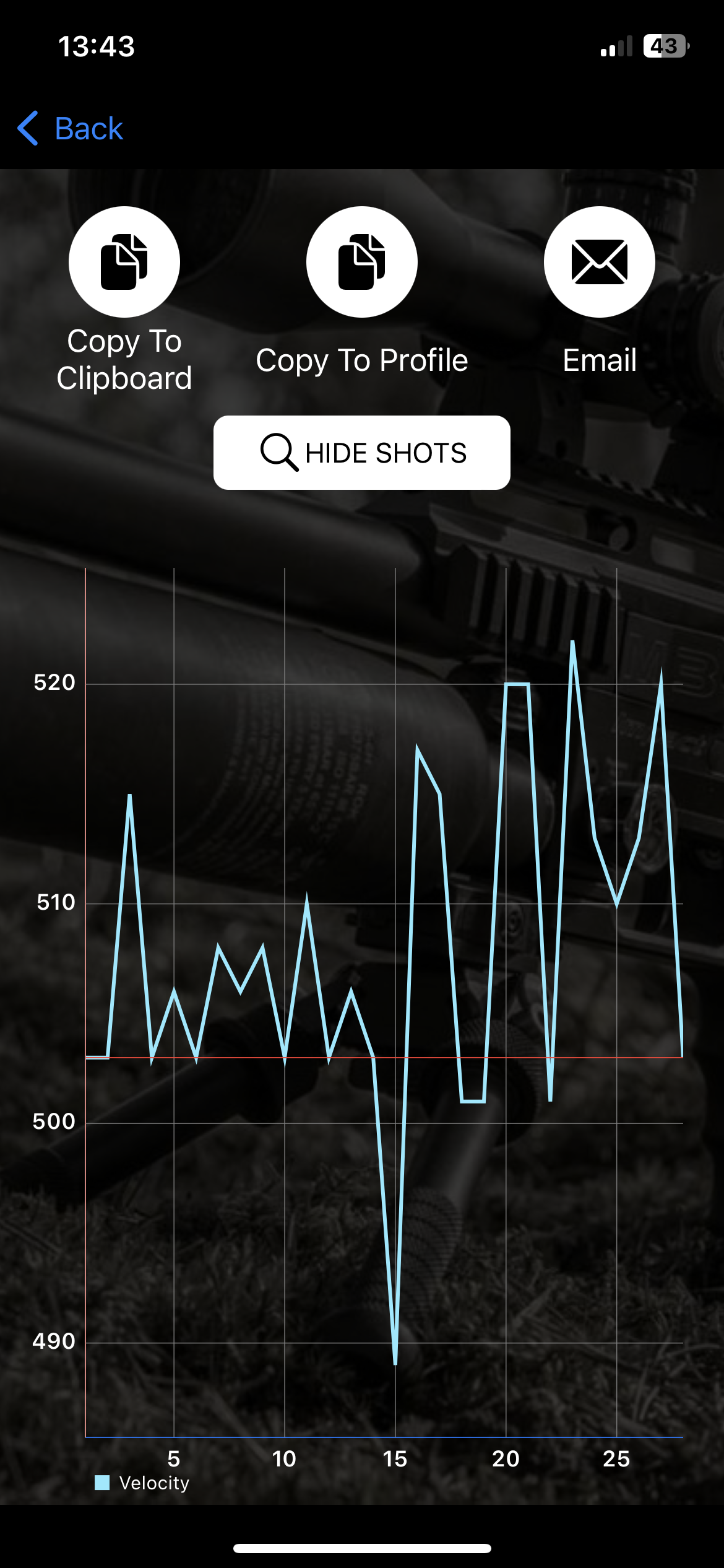

Once I hit 12 shots the accuracy opens up and goes wild, I’m not sure what is wrong?
Please see shot string guys!
Any help of this would be awesome 😎

You could have too much hammer. The valve is possibly being overpowered. The higher pressure in the tank may help the reg refresh faster, and close the valve quicker, but as air pressure gets lower, and the reg refreshes slower, it may change dwell time and give you those readings. I’d try raising reg pressure or lowering hammer and re testing.

Yes, 110 does seem low. Dwell time is the amount of time the valve is open before the air pressure behind it closes it again. The higher the reg pressure, the faster the valve will close. If it is overpowered by too much hammer, the valve will be open for longer than it needs to, and the gun will lose efficiency, accuracy, and the spread will increase. The reg and hammer need to be in harmony to create a smooth shooting gun, but a cheat is to make sure reg pressure is higher than you would normally use. This will help close the valve faster and give you a snappier shot cycle. Less wasted air behind the pellet, equals better accuracy and higher efficiency.
