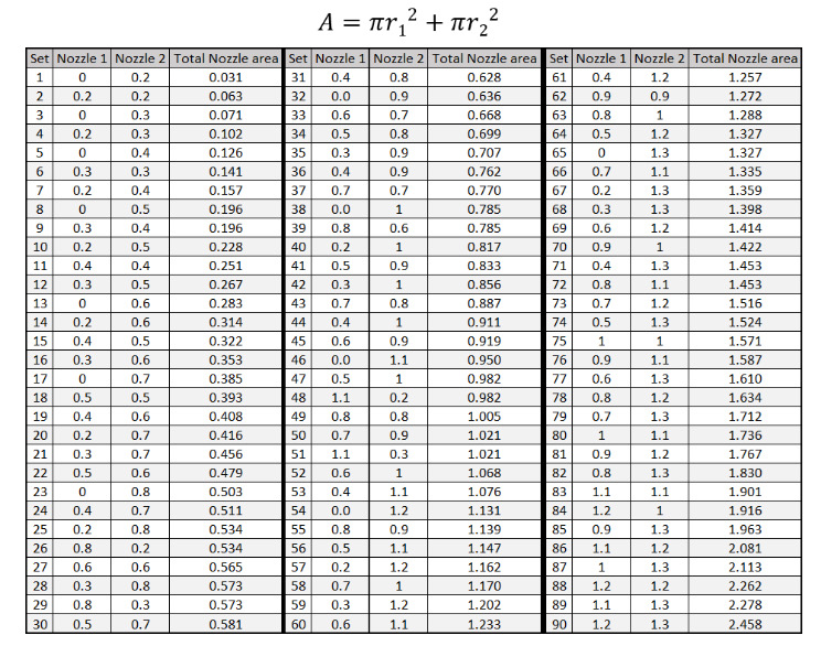

Joe, can you post the nozzle table again or what page it's on in this long ass thread lol? Thanks.

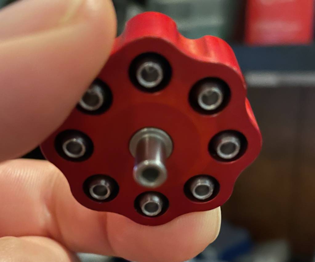

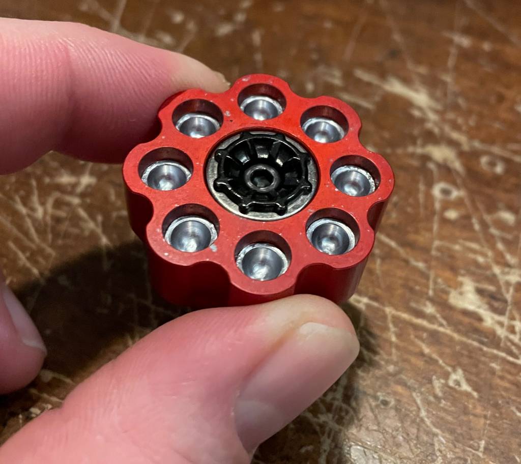

I found a .25 slug that fits the magazine without sliding through. More to follow once I re-install the .25 barrel and test them out.
Well no point in hiding in any magic here. These were the AVS .2513 hollow base slugs. They were staying pretty tight indoors at 13 yards so I had some hope for them. Took them outside to 46 yards and not so great. The 32 grain (910fps) held together within an inch or so group but threw one flier 2" out. The 34 grain (900fps) was slinging them all over the 4" target. It wasn't pretty. Just to make sure it wasn't me I put through a round of JSB .25 34gr MkII @900fps and once re-sighted they were holding really tight.
I'm now on the fence of trying the cup, dish or flat base .2513. Also considering trying the .254 which the AVS website FAQ says works well in the Cricket which I believe is an un-choked .25 barrel.
When you posted you found .25 slugs it didn’t fall out of the magazine my guess was they were the AVS slugs. I tested them in my Vulcan and cricket. They are really tight fitting in the breach. I did not find them very accurate at all. The guy that makes them has a modified Cricket barrel. The standard Cricket CZ barrel is choked.

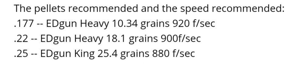

Does not every Edgun post speeds with a pellet weight?
Isn't max power derived from projectile weight and velocity? Isn't the latter a matter of air flow and barrel length in a PCP?
How many jets are we talking about per caliber/barrel? How much cost in currency or in documentation/labor or whatever else got mentioned is incurred for how many number of jets?
Who gets off feeling like he's entitled to put people down...and why?
Let's keep the conversation real. 2 jets or less. Not 12 or 20 or the tweaker's 100.

@ctshooter— Thank you for the jet combination different tunes. Once I get that second set of spring/valve I will be able use the jets I have to save some air on my .22 cal tune.
Joe- great chart for the jet sizes
