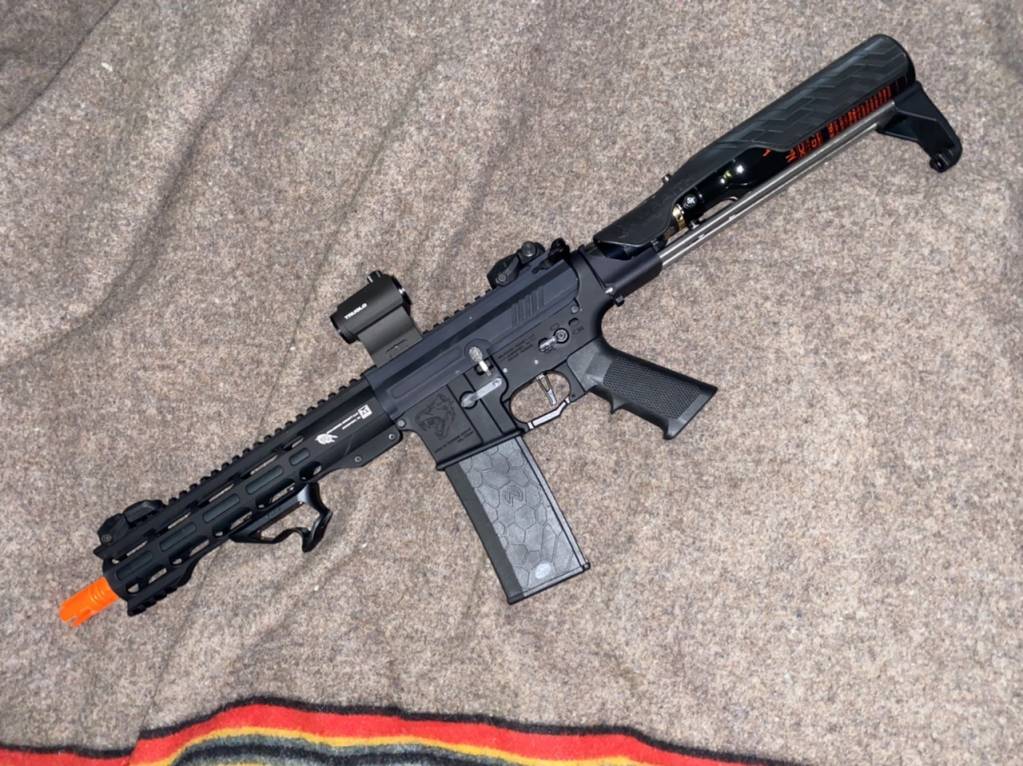

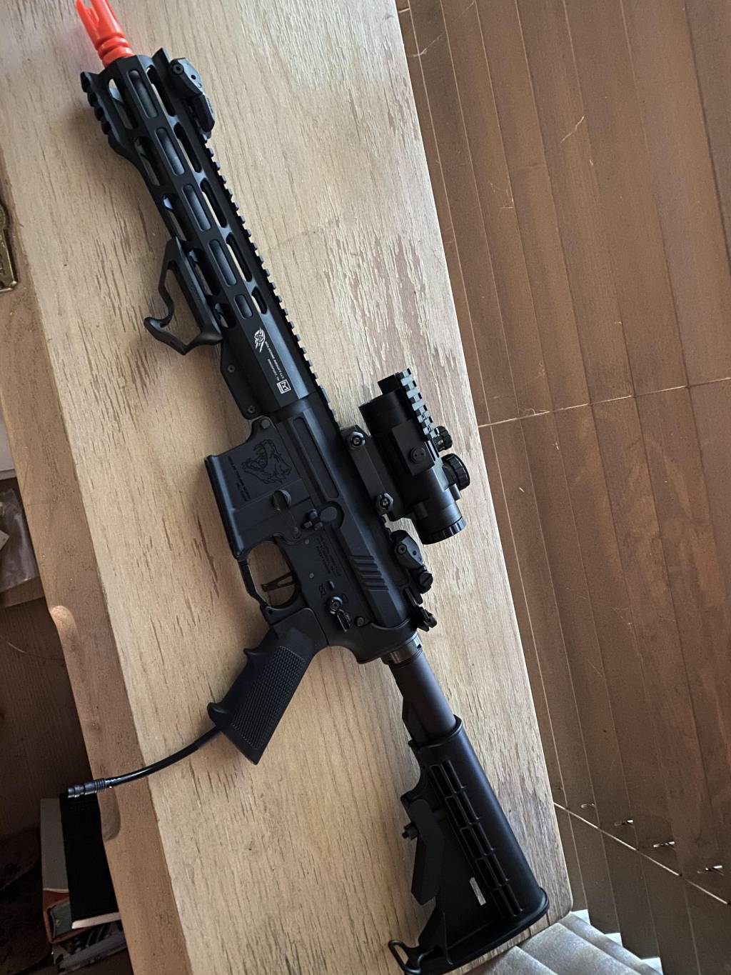

You might be right on that! I’m holding out hope that it works more like an HPA system for airsoft rifles. I know those are dealing with much lower pressure than a pcp rifle, but it is cool as hell to be able to shoot from a tank with those guns, even more so with full auto. 😁 If it is just your standard pcp tether option for an L2 I’ll probably be less interested in getting one.
Tethered hpa airsoft rifle:
Same gun, untethered using a 13ci tank in the stock:
