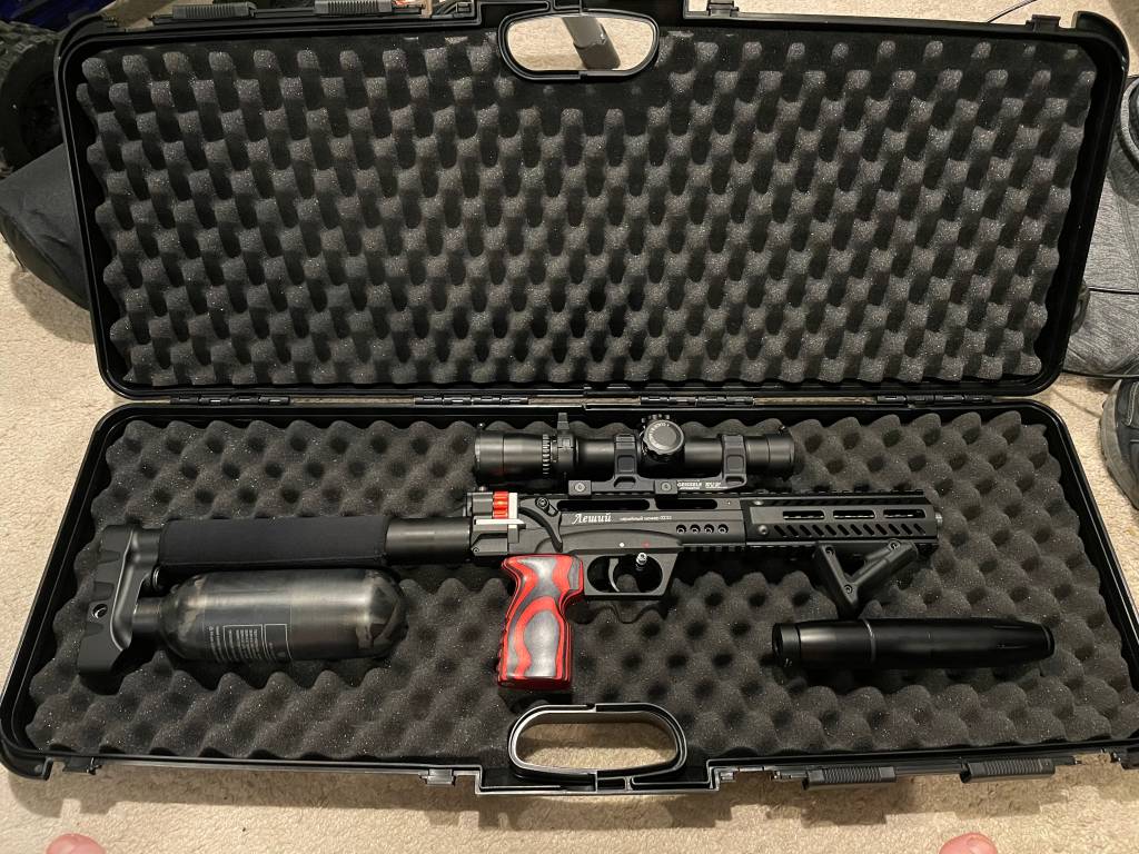

I picked up a used FX case on the classifieds earlier this week. Perfect size for the L2 in 350 and 450 barrel configurations.
That's sacrilege! 🤣

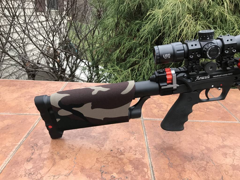

Thought I would show you some tinkering I have been doing on my rifle. I had some of this camo neoprene material laying around and I thought I would put it to some use. There are other prints available but you have to buy a 60” sheet of the stuff so it can get expensive unless you sell the items and use up the material. I looked and couldn’t find any prints with red in it for you guys that like the red and black theme of the Leshiy 2. This is reversible to solid black too. I like how it protects the top and bottom tubes and moderator from getting scratched. Stretches right over the butt tightly and doesn’t move . Also Gives some more cushion for the cheek as the neoprene is 1/8” thick.

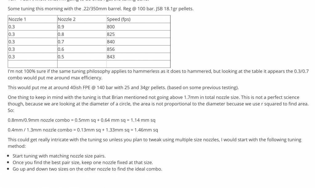

Though I was going to wait until pressure tester and jets arrived from Brian before adjusting the regulator pressure down a little further, but I didn’t and here is approximately are the results.
Based off Brian’s and Francisco’s instructional videos I have, in total, lowered the regulator pressure of the regulator “20 minish” of angle, thus 20ish bar. Original pressure was 130 bar, so in theory, the regulator pressure should be around 110 bar.
Here are some original specs for JSB Heavy 10.34 gr:
- Original 130 bar - 960 fps & 22 ft/lbs
- First adjustment 120-125ish bar - 935 fps & 19 ft/lbs
- Second adjustment: 110ish bar - 840-845 fps & 16 ft/lbs.
I don’t need the power right now, but I do want things a little more “backyard” friendly. So thus one reason I lowered the pressure and it seems to be around 5 decibels slower than the previous setting. I am a safety professional and my ears are pretty tuned to accurate noise level, and there is a bit less high end bark.
The groups opened up some, sort of, but I cleaned the barrel too, and my barrel seems to need 50-75 shots for it to settle down. But I still need to bore paste my barrel per previously suggested, maybe this help the barrel settle down faster. And I know the regulator needs a few shots too before it “tunes” itself to the new power setting, I think. (Or am I wrong?)
When the pressure tester and jets arrive I will confirm the pressure, and start to optimize adjustments with the jets to tighten things up, then report back on results.
