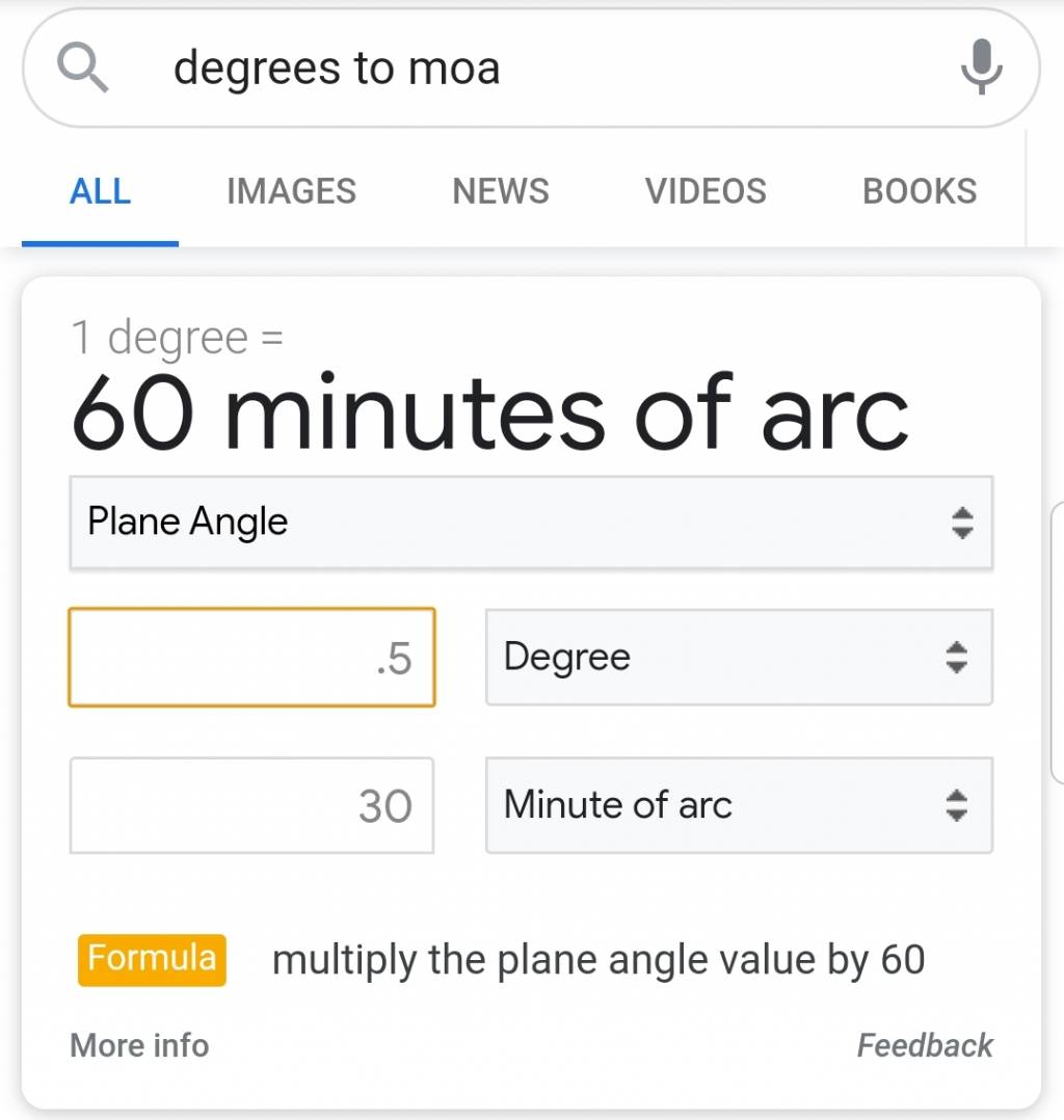

There's a calculator for that...

Thanks for the reference on MOA. It turns out I was led astray by various optics owners manuals (from Weaver, Burris, Aimpoint) that define MOA as 1” at 100 yards. My math was based on that definition, and would be correct if that definition were correct, but with some googling, I now find that that definition (widely quoted and used in optics manuals) is, in fact, factually incorrect, as it is merely an approximation (though none of the optics owners manuals I have mention this). 1 MOA is actually 1.047197581” at 100 yards, not 1”. The 100-yard elevation delta (vertical component) of 0.5 degree is indeed 31.4”, but I stand corrected that this is actually 30 MOA, not 31.4 MOA.
So I guess the lesson I learned here is not to trust everything I read in optics owners manuals, or as someone once said, trust but verify.
There are different "MOA" and Mil formats used in different scopes; most of the higher end scopes use "true" MOA or true Mil. Some "MOA" scopes are actually calibrated for inches per hundred yards instead of true MOA, For mil scopes, some scopes use NATO mils, which use 6400 "mils" for 360 degrees, while true mils are 6283.x (or actually 2 pi x 1000). The end math is all the same, but the variations are said to make it "easier" to do the math in your head for quick estimates. There are other variations, too, but those are the most common.
