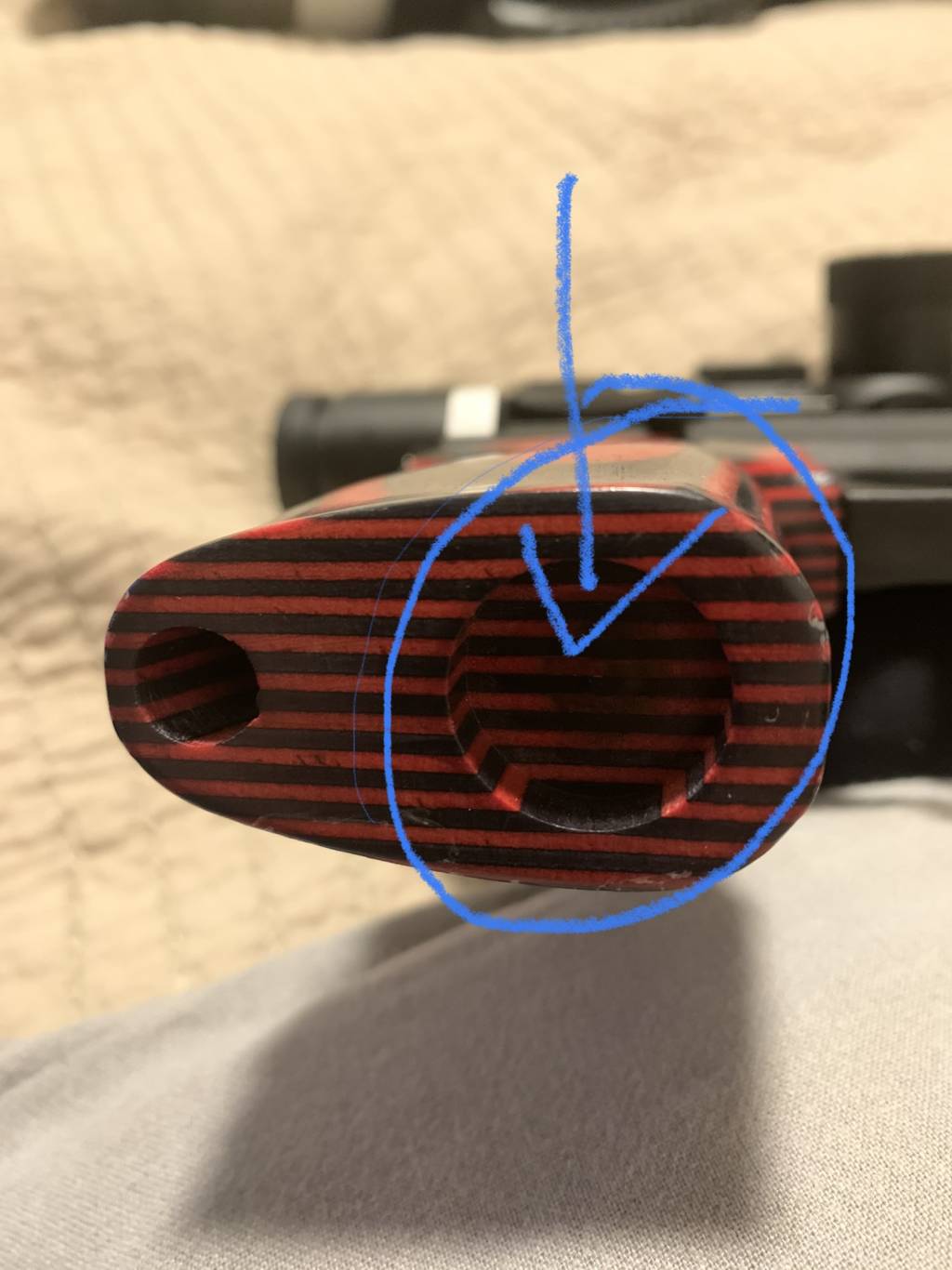

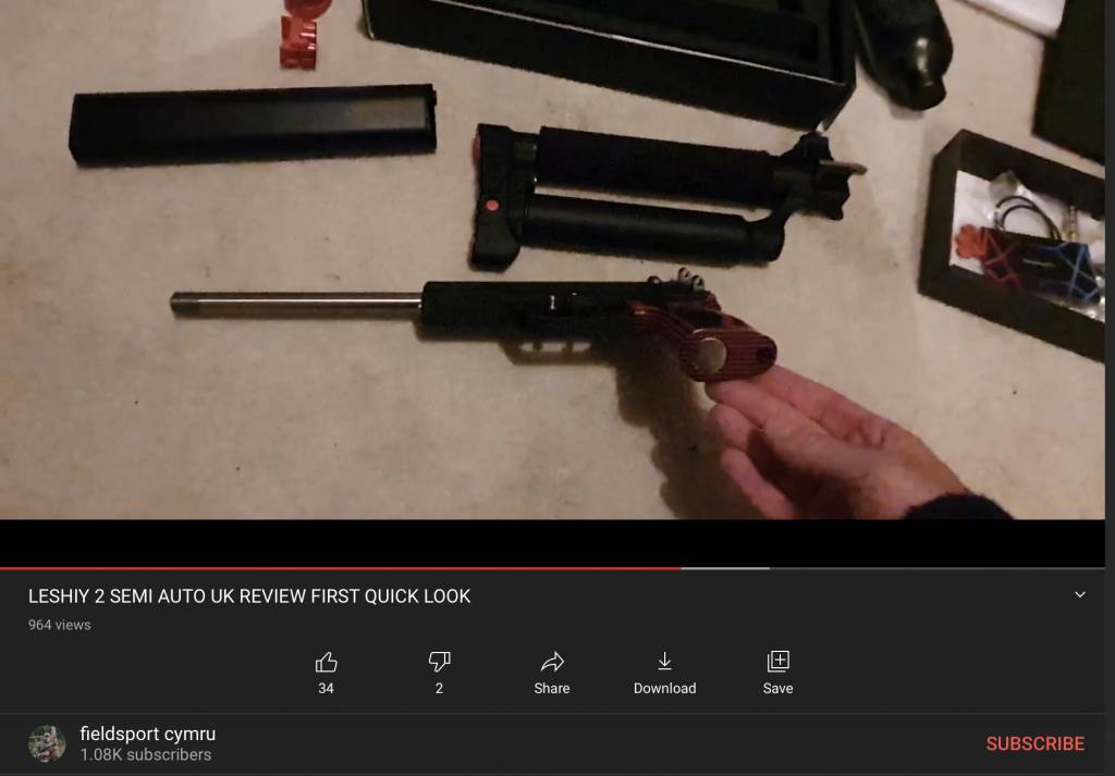

Yes, these are all kinks not deal breakers, but these have to be acknowledged and if someone doesn’t have the right spring for their safety, the dealer should get them one out the next day, not say just stretch it. When it comes to something like a safety then dealers should bend over backwards to get the issue solved. Also, there is a hole on my grip at the bottom where it looks like there should be something inserted. What is supposed to be in this slot? In other photos it looked like something silver is supposed to be there. If there is supposed to be something there that is TWO things that were missed in the quality control inspections before my gun left the factory.

The hole is definitely for a magnet to hold your mag plate when reloading instead of buying the modified mag holder they sell to do the same. My grip didn't come with the cutout, strange!
While it should have had a magnet installed if it has a cutout, at least you don't have to mount an additional "mag holder" to do the same job.
Amazon sells these pretty cheaply.
In a way you're lucky it has it if keeping the standard grip as if you don't fit a handguard the platform can run out of space quickly depending on what you mount to it.

My guess is that they prepared that for a magnet and then they thought: "Hey, we can sell it as an option, more money for us". It seems that magnet is a must have so you pay for that anyway. What a nice economy!
