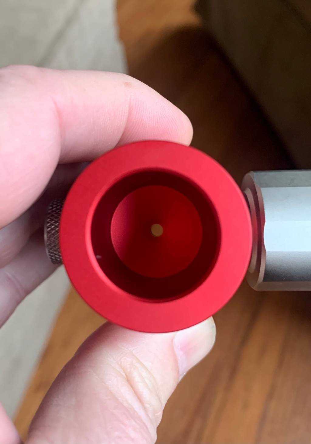

Just in case folks get confused by seeing a picture of a rifle with a reg tester installed followed by a video that does not showcase the reg tester... It is not the intent of the platform to shoot the gun with the reg tester installed. Results will vary significantly with and without reg tester installed. Plenum volume and air transfer are not optimized at all with the reg tester installed. It is intended only to document regulator output pressure.
Joe
@blackpaw I have one for sure. It belongs on a bench as a set up tool though. Not in the shooting fields. The end of the tester has an orifice that is smaller than the transfer port. It is not intended to be shot with the tester installed... that was my only point.

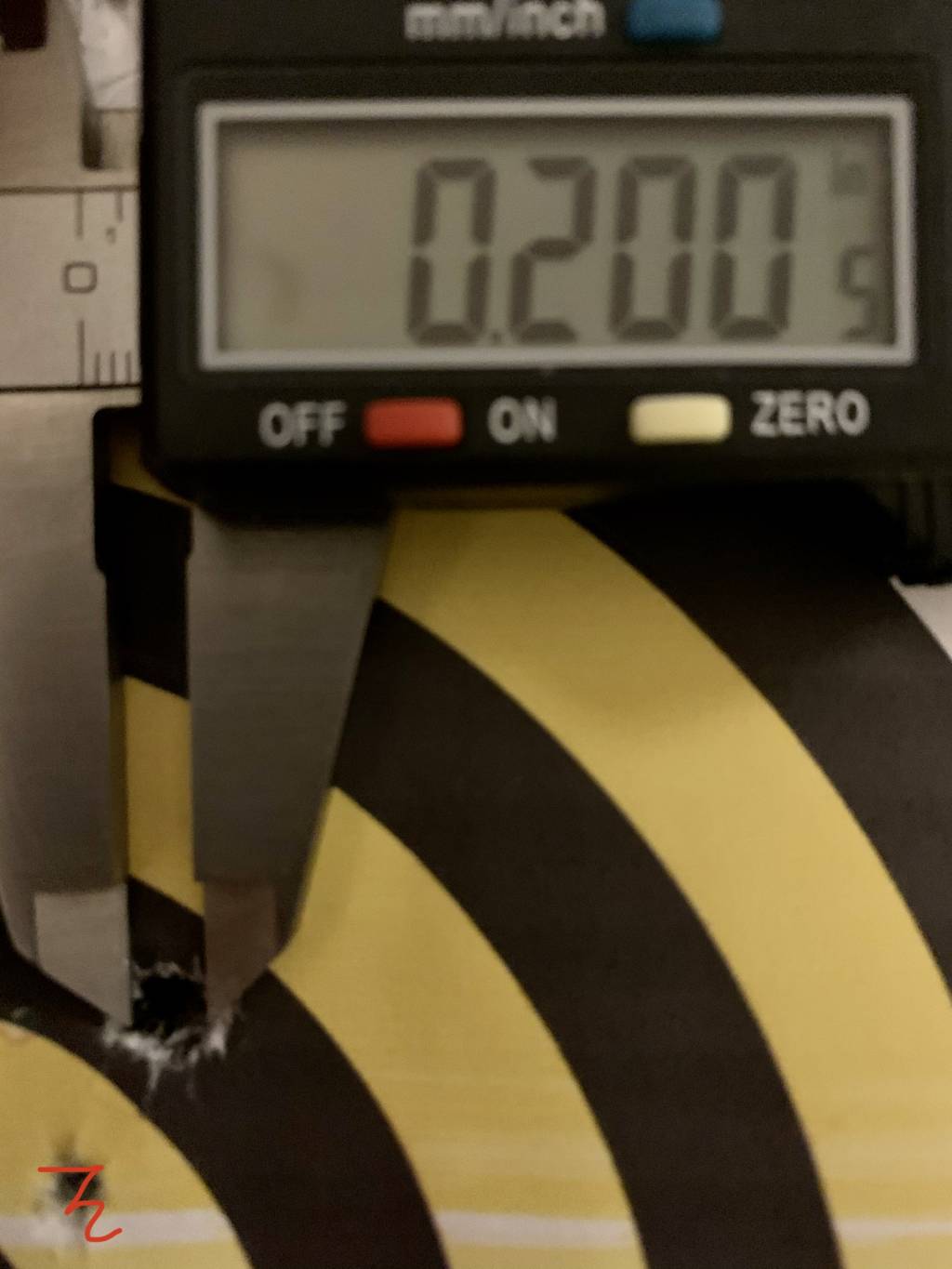

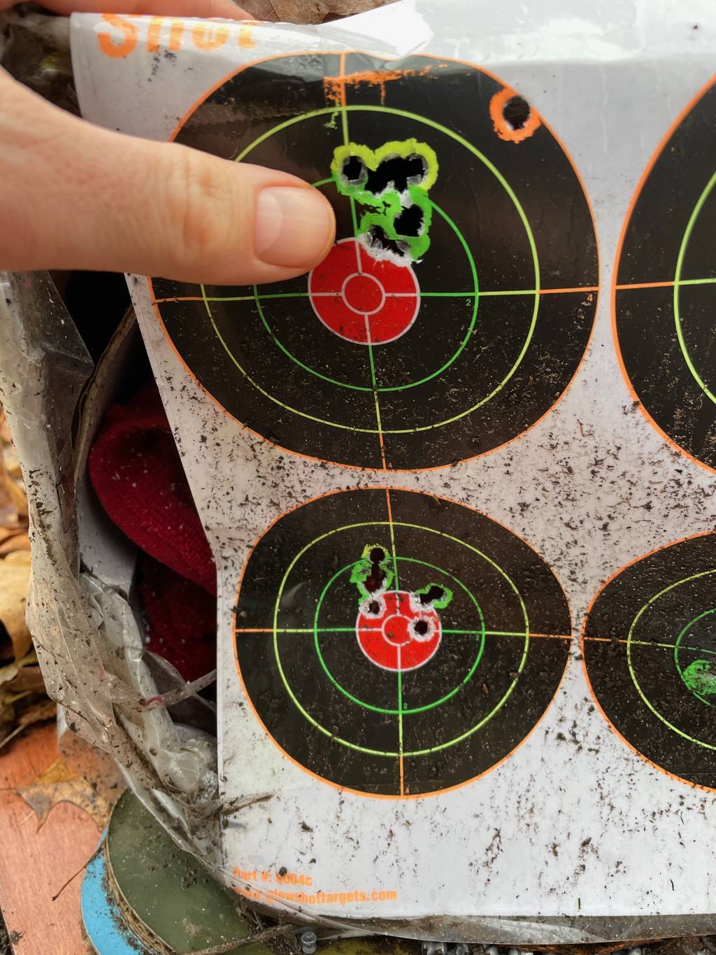

Accuracy post:
Weather in the northeast has been getting cold. Today it's 45, damp, rainy and just nasty out. Shot these from my kitchen. A little larger than minute of thumbnail.
Top target - 50 yards, .25/450mm barrel, FX 34gr pellets @ 770fps, 8 shots with one flier. Each outer ring is 1/2" so I'd say 7 shot ~.75" group.
Bottom target - 46 yards, .25/450mm barrel, JSB 25.39 @ 870 fps. I'd say a little over 1 inch on the group of 8 shots.
I just want to call out bull dinky on those videos showing the L2 with popcorn accuracy. It's just not true. I don't know about getting MOA from an airgun that shoots the pellets from the magazine. Shooting with 8X scope but I'm sure on a nice day I could tighten these up, and these were shot right out of the tin.

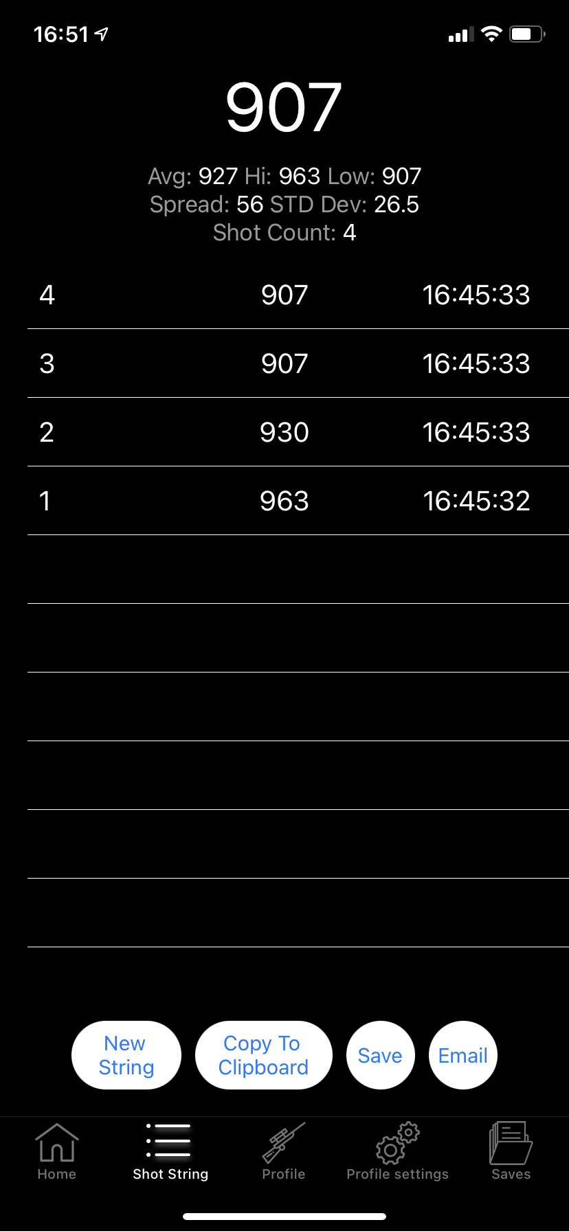

Thanks @ctshooter, I just did a 10 yard shoot (yes means nothing literally as fast as I could shoot, I did a 5 shot group, and the FX Chrony got 4 of the 5. You always have to use an odd number in trials if less than five for standard deviations. 5 shots in 1 secondish, ignore one shot, and this is LITERALLY pellet on pellet and a screenshot of chrony data.
@leatherman based off your comments about your Leshiy 2 not being adjusted correctly when you received it, I ordered a regulator tester today from EdGun West. I am a person who always wishes to know, vs wonder, I don’t like surprises, including surprised birthday parties.
In regard to my post, 10.34 grain JSB Heavies / unsorted out of tin which I dropped today on the floor (I will probably be finding pellets for the next year) all still at out of the box settings (which I am 85% aren’t what they are supposed to be.)
Though a very limited scope, what I thought was interesting is there was only a 6% drop in velocity between shot 1 to 4. I can’t fake the numbers from the Chrony because I no where near those hacking skills, if I did have them, I would be in a different profession. 🤣

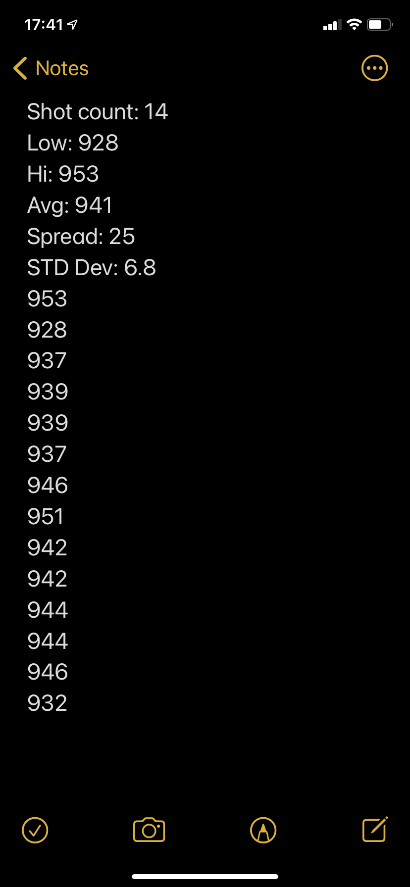

@ctshooter, here is another two strings, and maybe you are right on shots 4 and 5 in the previous readings. Here are two strings with a top off between the shots, and as fast as I could pull the trigger and it is even better data. I copied and pasted to Notes so I could get it all in one screenshot.
The difference in fps 0.722% for 14 shots, so the little regulator is doing its job to be consistent (yes with a top off).
Edited PS. I haven’t cleaned the barrel, and have shot 4 different types of pellets through it since the last cleaning, but all different JSB. Heavy, Hades, Monster and Beast.

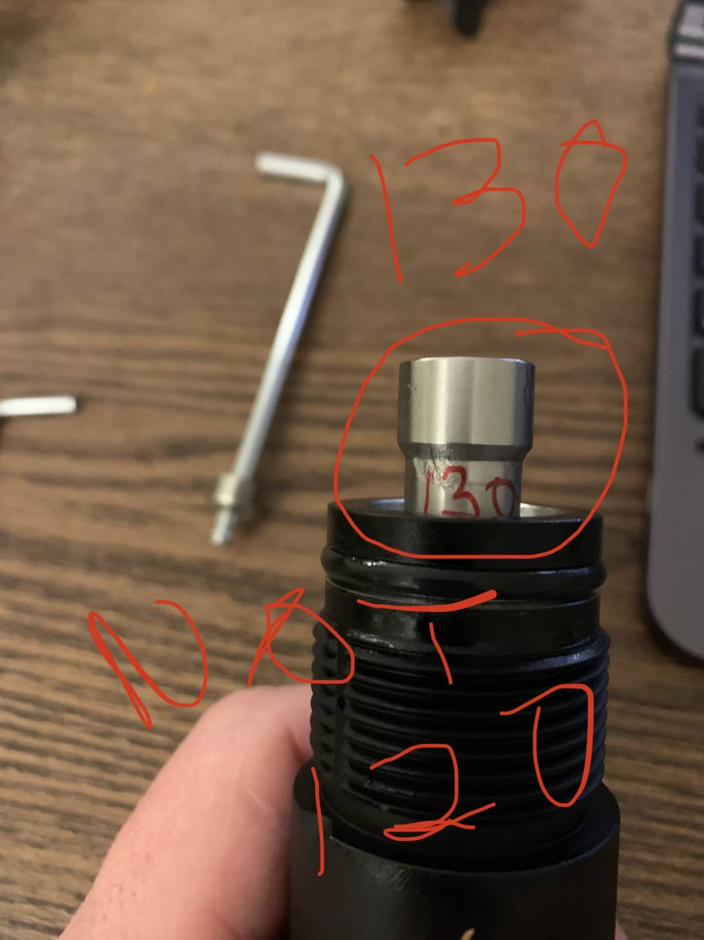

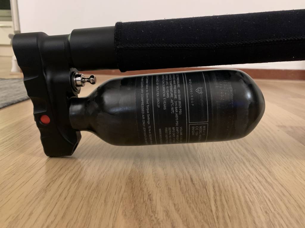

Okay after pulling the shroud and cleaning the barrel I had a some jump around, more than I think i should after just a barrel cleaning. So I went ahead and pulled the restock apart and did a adjustment of the regulator 5 mins of angle. AND while I was doing it went the rest of the way and put the 300 cc bottle on. Tomorrow / Wednesday, I will give some data, but here is the package.
Photo shows the regulator was set to 130 Bar, (I did not write the and was told it should be 120 bar for a .177, see previous post and if @edgun or @edgunwest want to chime in feel free.
Yes, mistakes made no big deal, but it makes sense to me on why the 10.34 gr pellets are running so hot. If I am wrong please correct me.
I am going to let the rifle sit overnight with the new bottle on and check for leakage, hopefully I did it right. And no the 300 cc bottle does NOT interfere with the closing of the rifle.
