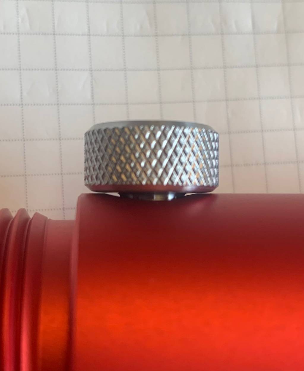

BTW, I talked with Brian last night about the reg tester and having to crank on the air release knob to get it to seal...and it my case it not sealing. He advised to swap the gauge and knob with each other (move the ball bearing with the knob to the other side), as they're threaded the same. We spoke last night, so I haven't tried it but he did it with success. I'll give it a shot over the next few days. There were plenty of threads left on the knob when I moved it...
Or chuck up the knob and shave the shoulder of the knob just a hair. That little ball will form the seat on its own with some encouragement.

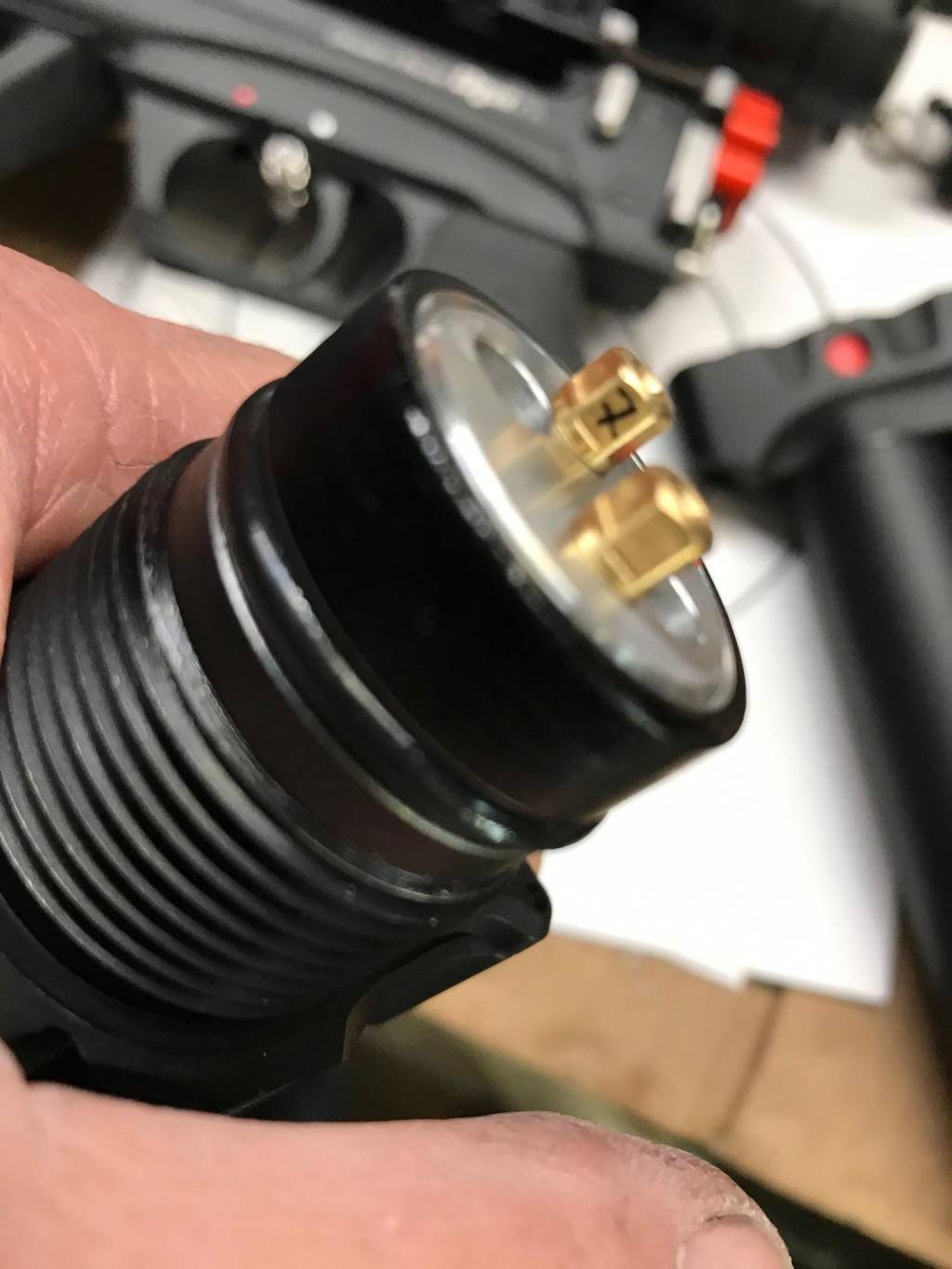

you might want to purchase a 5mm hex socket to remove and install the tuning nozzles. I took my valve assembly off to measure the nozzles and one of them has #7 written on it so I'm assuming it is .7 mm? This is a .22 x 350mm from the factory. Id be interested in what size your .25 and .30 guns have from the factory.
I'm pretty sure that the .25/.30's come with #4's (0.4mm).
