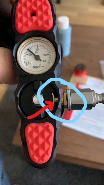

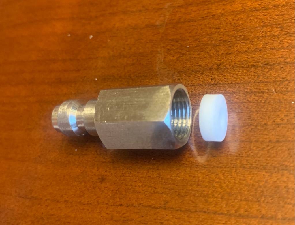

To start, I had a seal between the foster fitting and probe (do this always) and I still had the leaking.
Photo from my original string trying to solve the problem....Arrow is the location coming out...it is not between the probe and foster fitting.
I have pushed the probe in as far as I can and as I mentioned replaced both o-rings with the extras that came with the gun. And i have tried filling from both sides, same issue. In my string @jwilson showed me a part/s I didn’t get with the gun, but I think Francisco is getting them to me, and I will confirm in morning. Parts are below what @jwilson showed me I didn’t and don’t have.

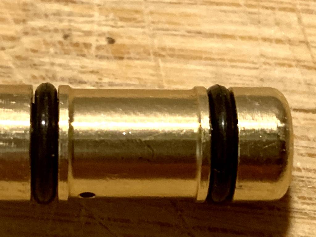

@ctshooter, here is a close up of the o-rings on the probe and these are the ones that are the replacements for the original ones. Remember the gun arrived new in the box less than 24 hours ago, and the issue started as soon as I started tryin to fill the gun. It is like air IS getting into the air reservoir but the rest is bleeding out like mad.

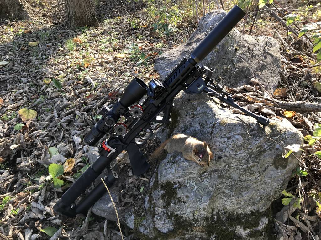

Finally got this little guy. Been chewing on my T111 plywood on my shed this summer. The walnut tree beside the shed was too much for him and he was distracted. Shot him from the garage about 45 yards. Missed him on the first shot and got him on the follow up shot when he turned to see where the shot came from. I am still figuring out this trigger. My experience so far is to as Brian explained , pull the trigger rapidly and not squeeze it until it goes off. There is a definite difference in the way the shot sounds and the gun is more consistent accuracy wise with a consistent quick trigger pull. Anyone else experiencing this?
Very nice looking setup Leatherman!

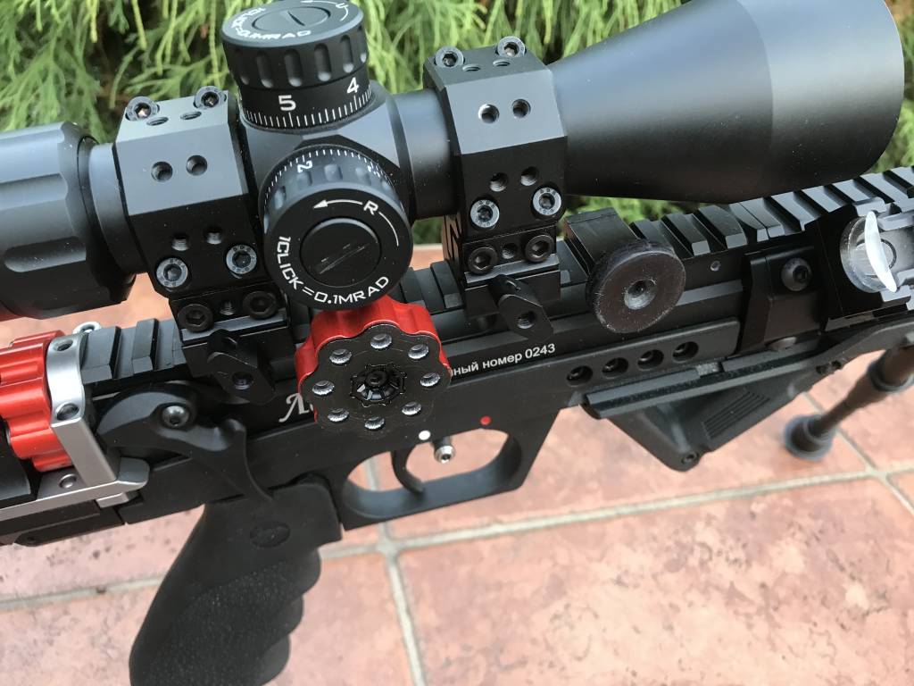

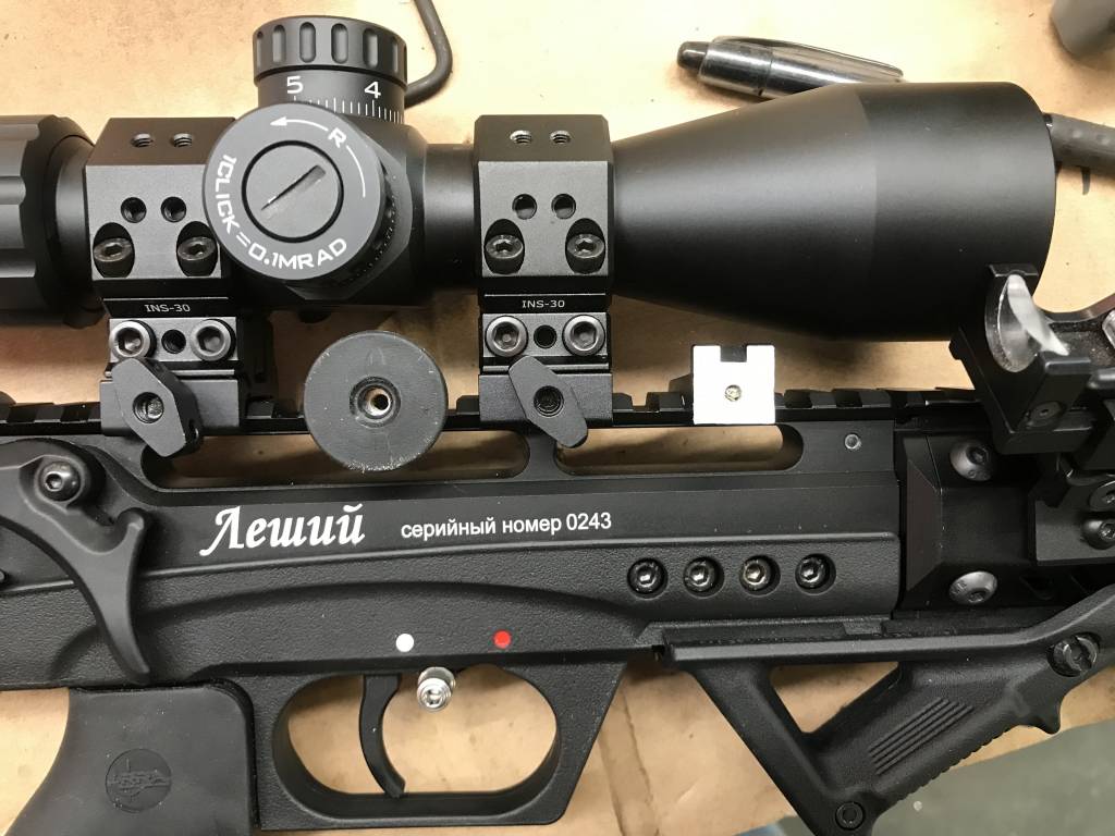

May I ask, how have you attached your spare magazines to the side of the Leshiy as shown in your picture?
Very interested in this, so any advice, tips would be greatly appreciated!
I am looking into tubular magnets with a hole in the centre to somehow attach to the rifle in a similar location…
I bought two 90 degree picatinny rails off amazon and two washer magnets from K&J magnets that have a hole in the center and they are covered in a black plastic. I milled the picatinny rail off the 90 degree and left a little less than 1/8” of material so I could get the mags in as close as I could. The magnets are 1/4” thick but the post on the magazines are around 5/16” so I had to drill a hole for the post to be able to go in and the magazine would bottom out on the magnet. Then I just super glued the magnet to the rail mount. The magnets hold the magazines tight so they won’t fall off. I use the magnet to remove the disc when I reload too. These magnets could be mounted along the side of the tactical hand guard as well with super glue.
