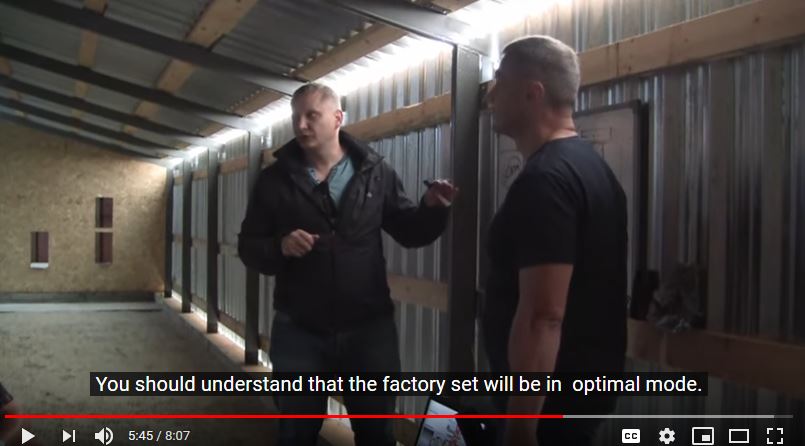

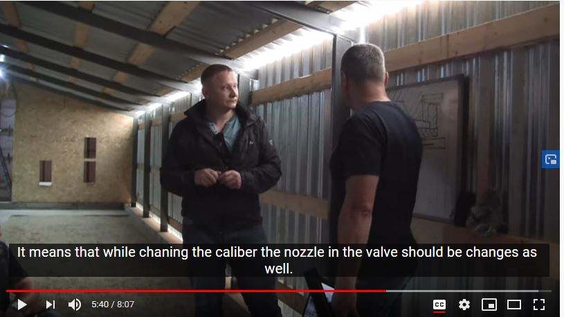

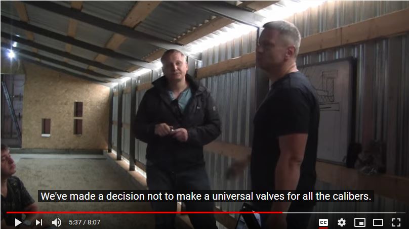

You know, we are still running a lot of tests and most likely we will stay at the first idea, the universal valve for all caliber. Yes, in small caliber the air consumption will be not as effective as in big calibers, but it will allow to speed up the gun in a very wide range. Taking into consideration the trend for using slugs, that is not the bad idea, I suppose....
..slugs and the possibility to get more power with very heavy pellets in 177 for countries with airgun caliber restrictions
