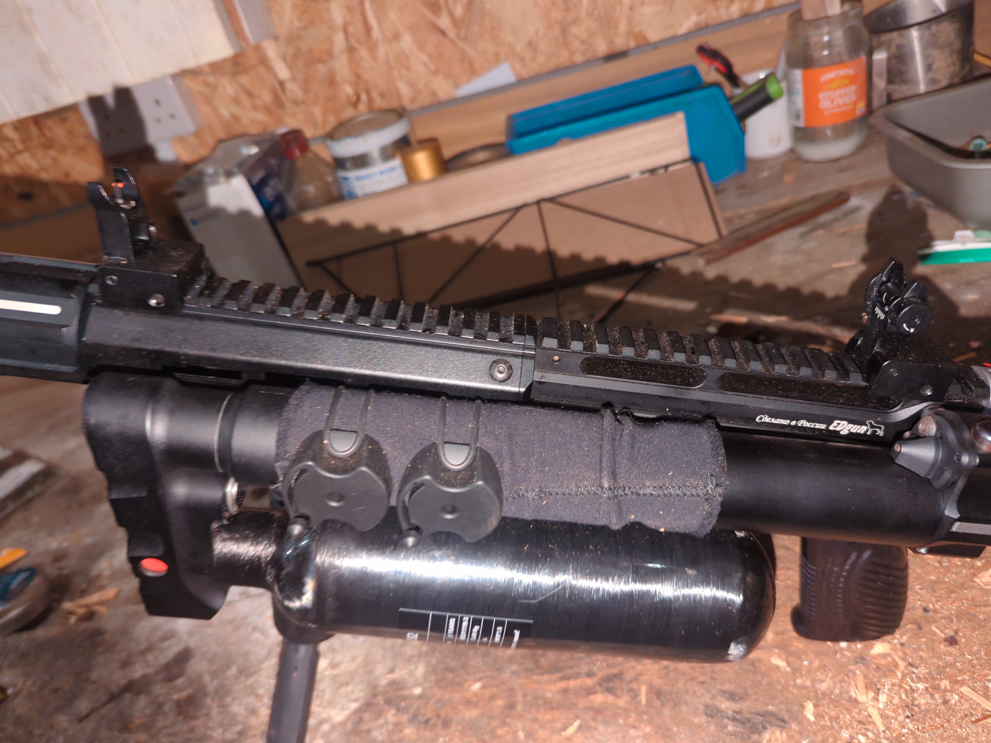

Hello all, and haply new year! I'm a bit of a novice, need a little more advice, I'm shooting 21.14gr barracuda match pellets in 22 out of my L2 at about 880 fps I'm currently waiting for a holosun red dot to go with a 3x Bushnell magnifier ive got ( I bought this model as I heard it has very good eye relief, I'm awaiting delivery of the red dot, as a temporary solution I bought a cheap pair of flip up iron sights off Amazon which appear to have no elevation adjustment and its shooting way to the right so have had to wind the windage adjustment way off centre - the gun seems to be grouping fairly ok but just quite low since I can't adjust elevation on the front sight, I'm only shooting at 20 yards or so, is it normal to have to just aim above your target when this close with iron sights? And Will I be able to zero the red dot and magnifier for 20 yards? Or will I have to zero for more like 50 and just aim high on closer range targets?
Can you include a picture of your iron sights, as they're mounted?
Excuse the messy bench, I dont work on it here!

Are you sure that front sight isn't altitude-adjustable?
It looks like the centre pin may rotate. But the picture is a little blurry and at a distance.
I agree, the front sight pin does appear (blurry) to be adjusted. The pin also appears to be unscrewed quite a ways. There should be a pin you can push down that will allow pin to turn to the next notch (1/4 turn).

Looks like you have both your front & rear sites installed backwards. Flip them around and start over. Also, just looking at your front site and from what I can see, you should be able to adjust for elevation. It looks like a standard AR-15 front post. Can you post a better pic close up of your front site?
I think the front and rear sights are in roughly the right location.
Do you mean they're oriented the wrong direction? i.e. the rear sight is at the rear, but the adjustment markers are facing forward rather than backward?
Yes, I agree with that, although it probably won't matter much as there don't ?seem? to be any kind of illuminated markers on the rear sight.
They are in the correct location. They just need to be rotated.

Well I turned the iron sights around and the thread stripped off the front one trying to tighten it slightly over FINGER tight ah well cheap Amazon crap! I have my red dot in a few days, ive temporarily mounted the last thing I had to hand which had compatible mounts, a green laser, zeroed at 15 yards, atleast I can actually shoot it finally! Ive just been may dumping stuff at point blank for the hell of it with no sights until now! 🤣
