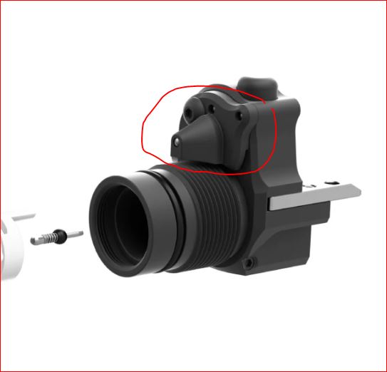

How can you make it mouse fart if the muffler is blowing right into your face?
Maybe something like this can help:
The work is still in progress, the form and function is correct, just to define the cosmetics a bit more....
That is cool. I bought a similar item from Silent Thunder Ordinance. It will be interesting to see how it turns out.

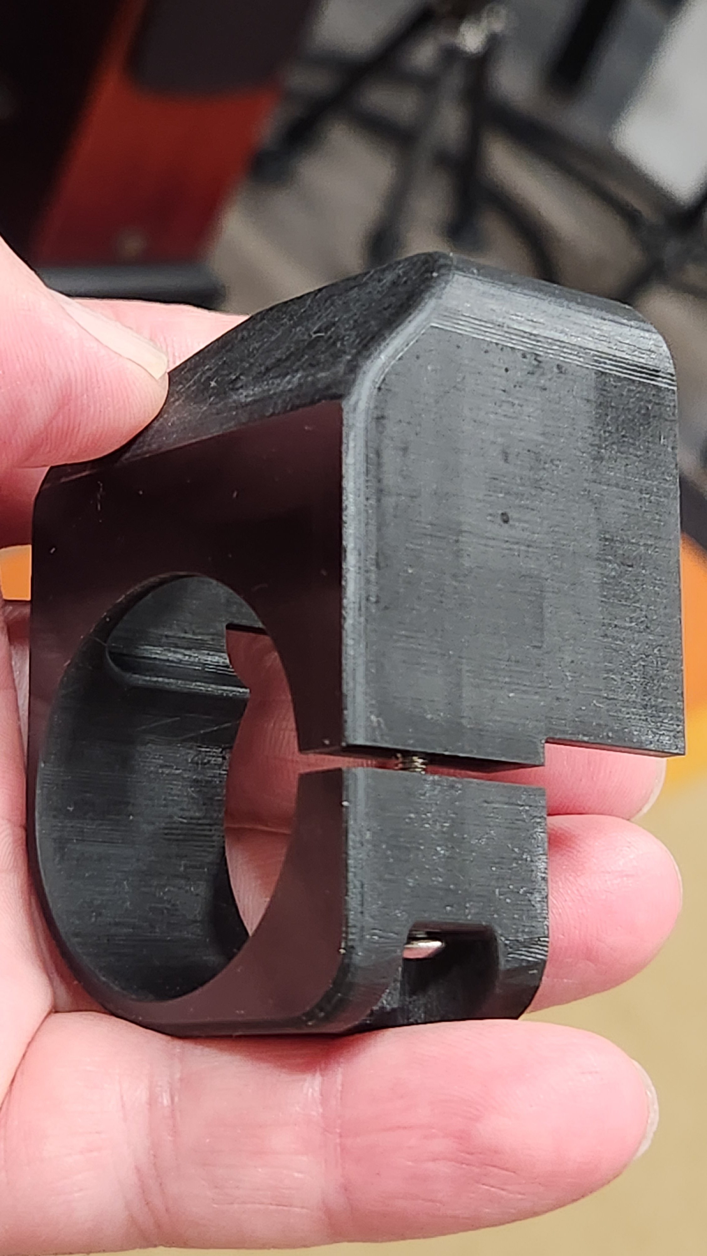

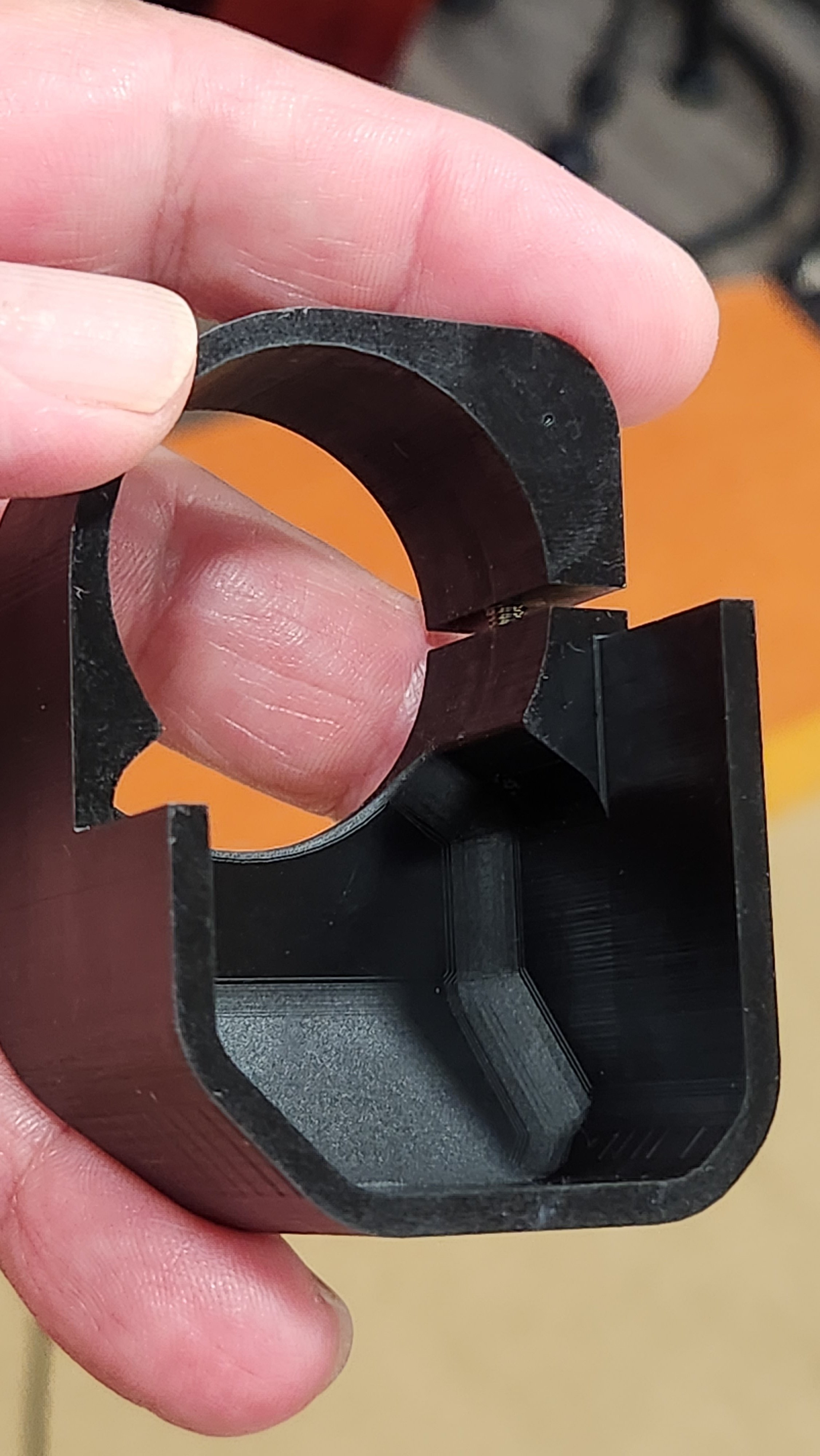

This rev.03 was a quick and dirty design with 50 micron tolerances for resin printers (only). I don't own any filament printer so I don't know what dimensions I shall change to make the part fit.
Initially I wanted to make a new cover piece only, but could not "borrow" a 3d scanner on time. I would need the position of the 2 dowels to the indexing barrel relation correct, the rest of the shape is easy. I would just make that plug "thicker"
This my box is a little big to my liking, but works well. Next all rain day season I will minimize the shape a bit in a rev.04 but that time must wait for now busy with outdoors.
Here is a stp file to anyone want to try. I am usually using eSun Hard Tough + Shiraya Tenacious in ratio 3:1, my current print is in black.

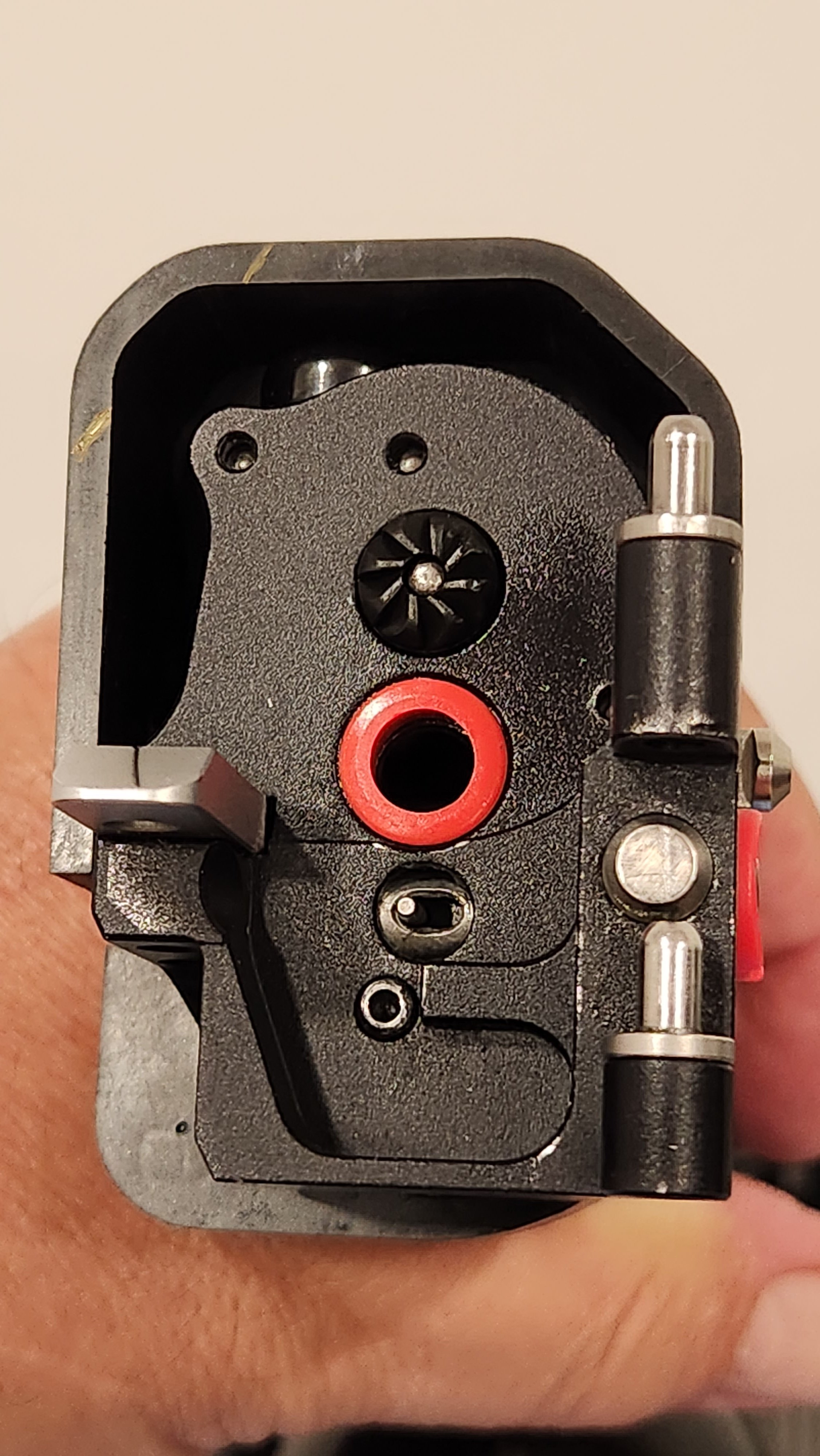

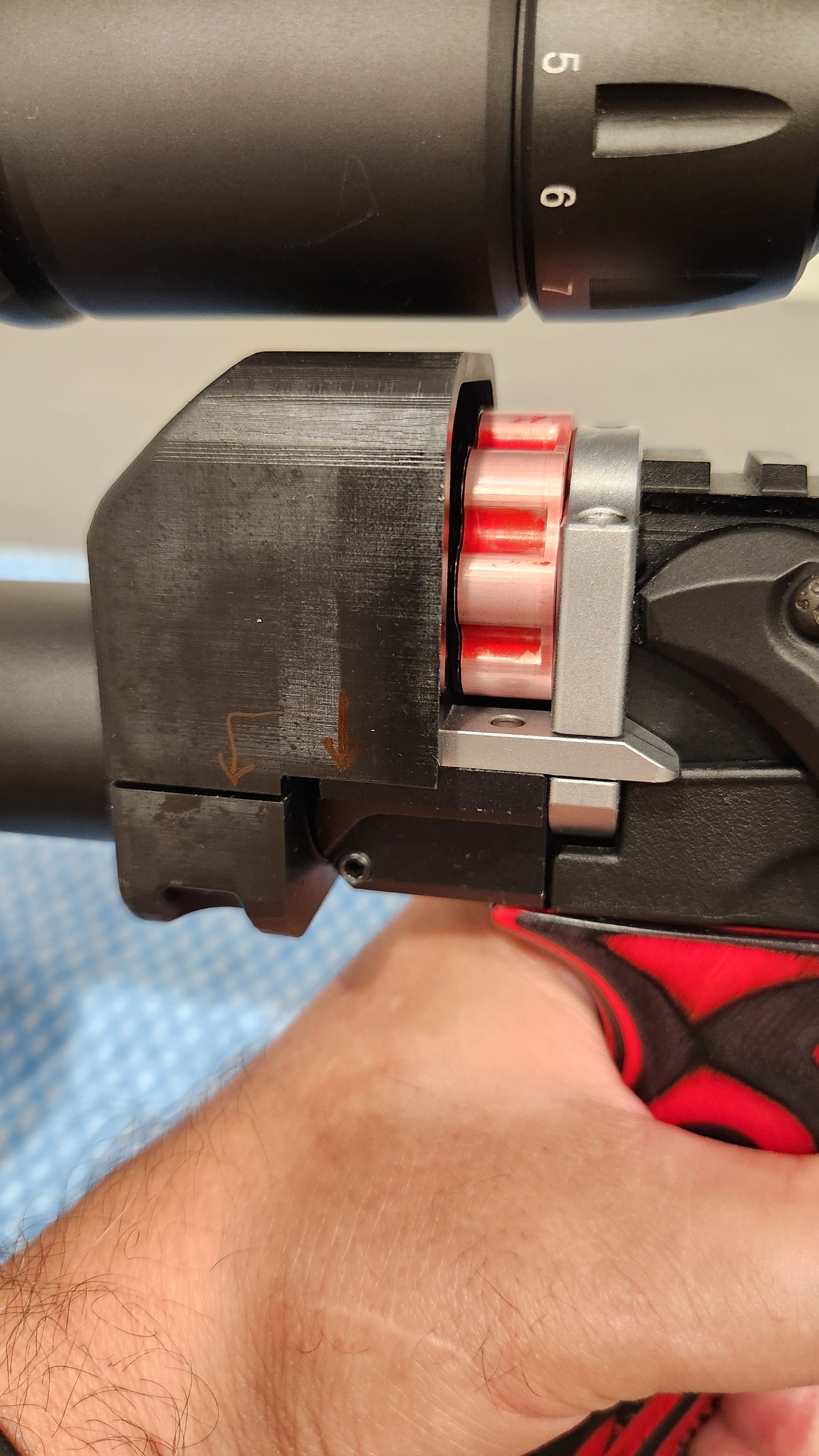

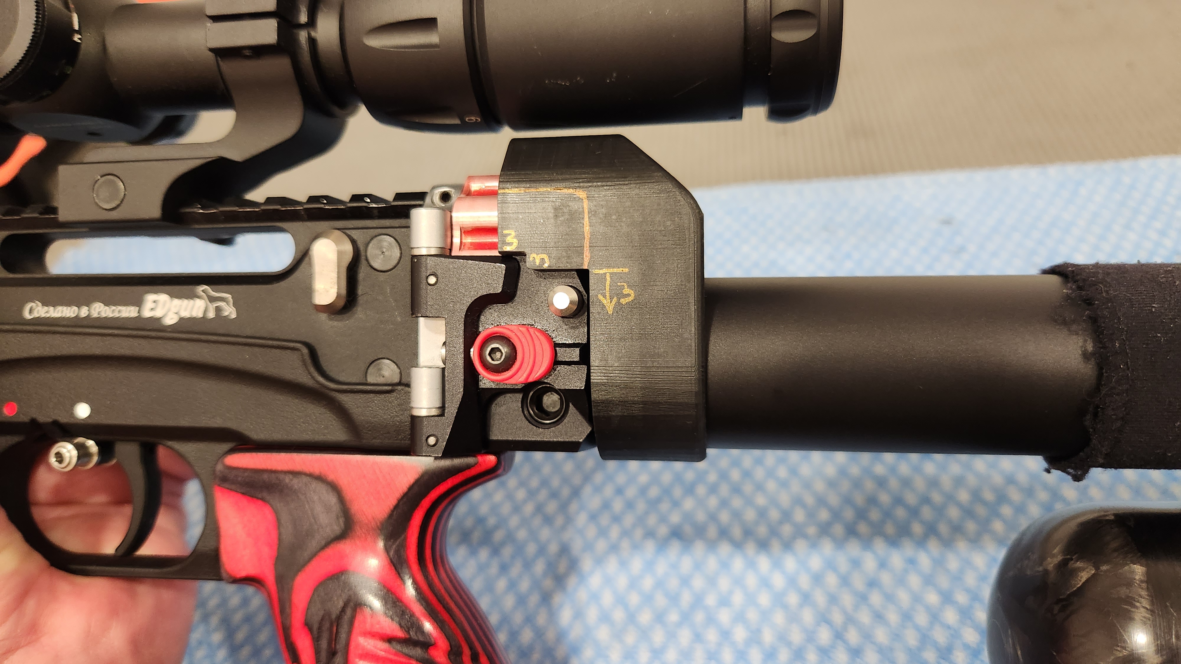

Can you post a close up picture from front-right side, how much gap you have between the FV plug?
My
My scope mount is kinda in the way at the moment, but I will put it on and post soon.

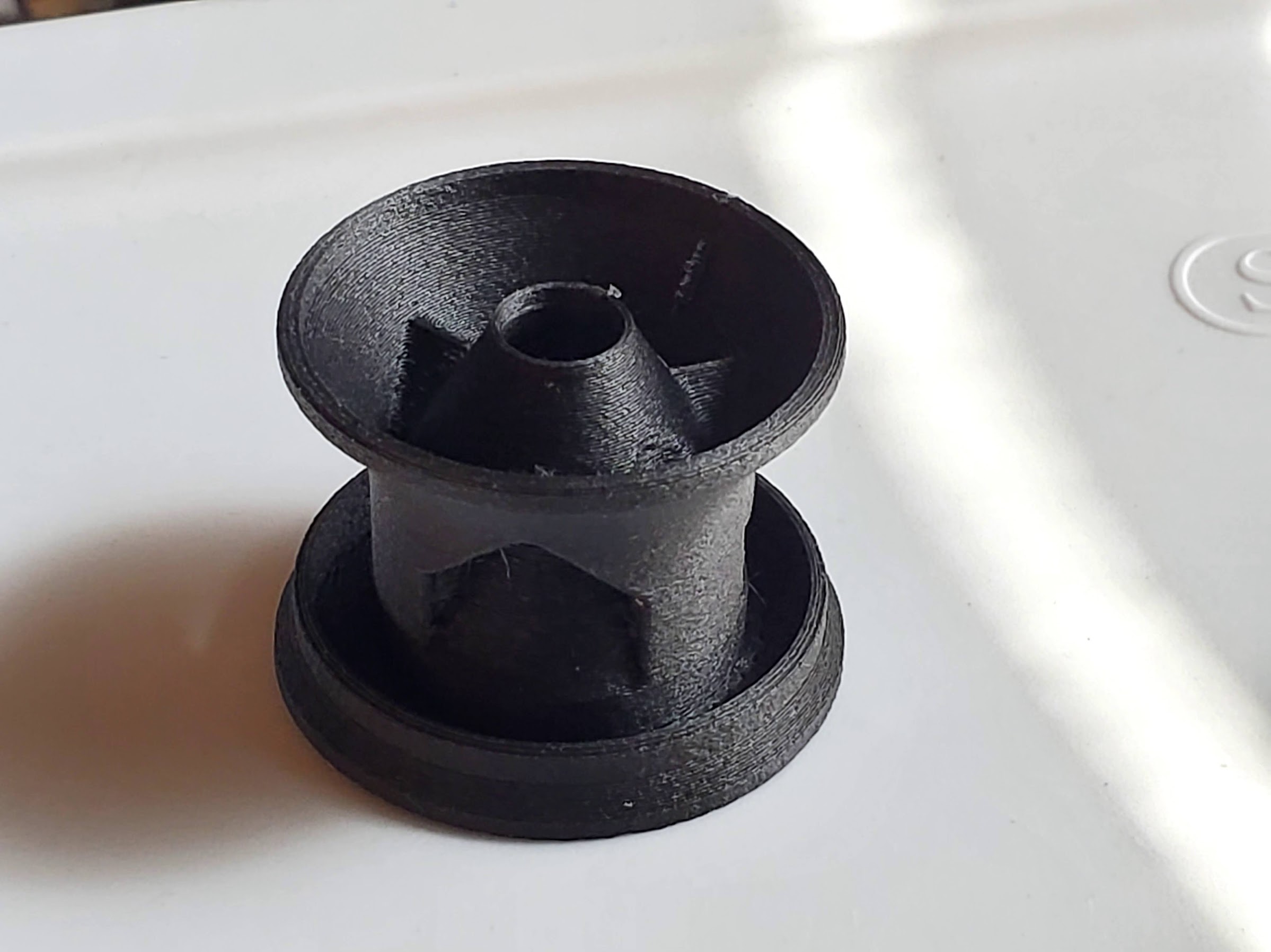

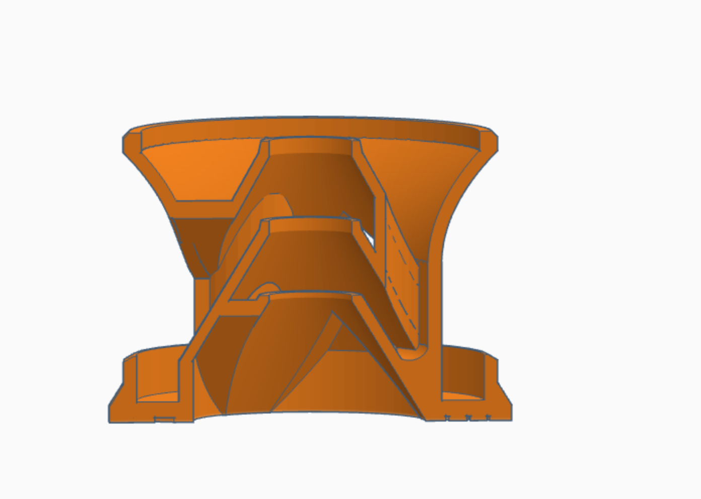

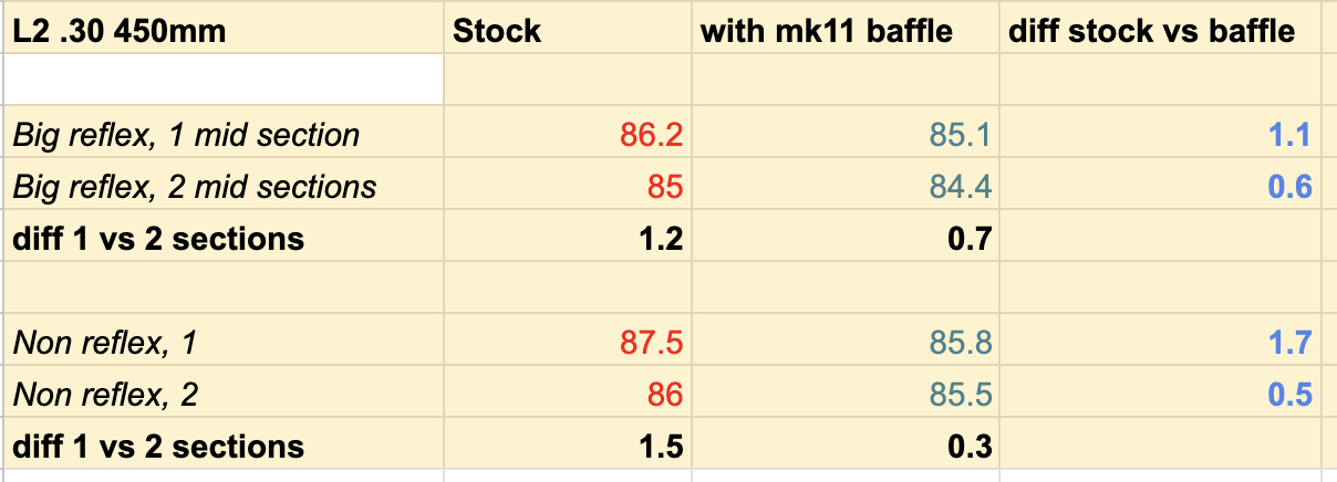

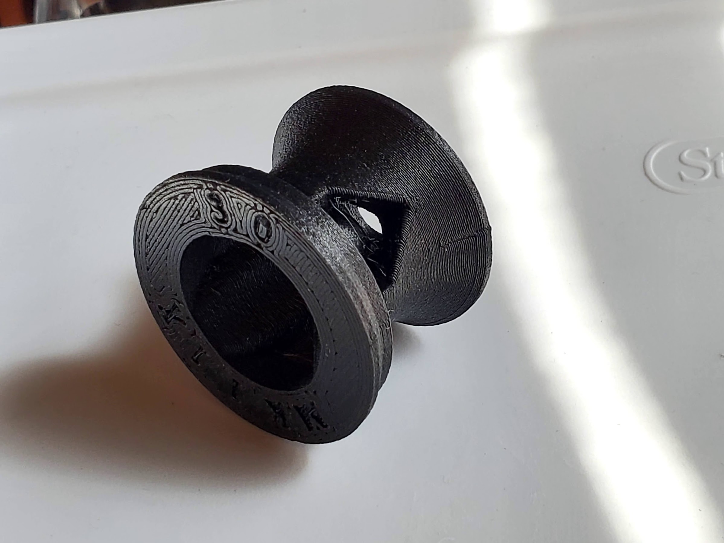

In other news... I continue my experimentation with Behemoth blast baffles, this time with the 30 caliber. I must say the Behemoth performance in 30 cal has been hard to improve compared to .22 and .25. I went though a few different baffle designs and little tweaks, lots of pellets and air, had moderate successes and total failures (where with my baffles the damn thing actually became LOUDER than in the factory configuration). This is my take on the Tesla baffle which seems to work the best.
I've tested this on a 450mm 30 cal barrel using both non-reflex Behemoth and a reflex model with my big reflex tube, using both 1 and 2 middle sections. Numbers below.
Again, ignore the absolute dB numbers, this is not a good indicator of how loud it actually is, but it provides a good relative comparison of different setups and my ears agree.
So basically, there is a smaller improvement than what I've observed with .22 and .25. Short non-reflex models clearly benefit more. Here, I measured a 1.1 .. 1.7 dB improvement on short Behemoth setups with only 1 middle sections, and only a 0.5..0.6 db improvement with 2 middle sections. There is, however, also a change to the tone of sound noticeable on the non-reflex model: it takes away higher frequencies making the sound signature a deeper thud (similar to how the reflex model sounds).
I guess a reflex Behemoth especially with 2 mid sections and a bigger reflex volume is pretty efficient in this caliber already, and there are diminishing returns from adding additional sections or a baffle from there. Hard to improve on perfection (whereas the .25 caliber round in the same exact can is a bit sub-optimal due to the bore not ideally matched to the projectile, hence bigger gains from a properly sized baffle with a tighter bore).
In any case, it appears that adding my baffle to any Behemoth, either reflex or non-reflex, is approximately as effective as adding another section to it, which helps my goal of keeping things short. I was basically able to lose one suppressor section on my 30/450 setup which makes the while setup a little more manageable without being too loud.
I have a few more ideas so I'll keep playing with it...

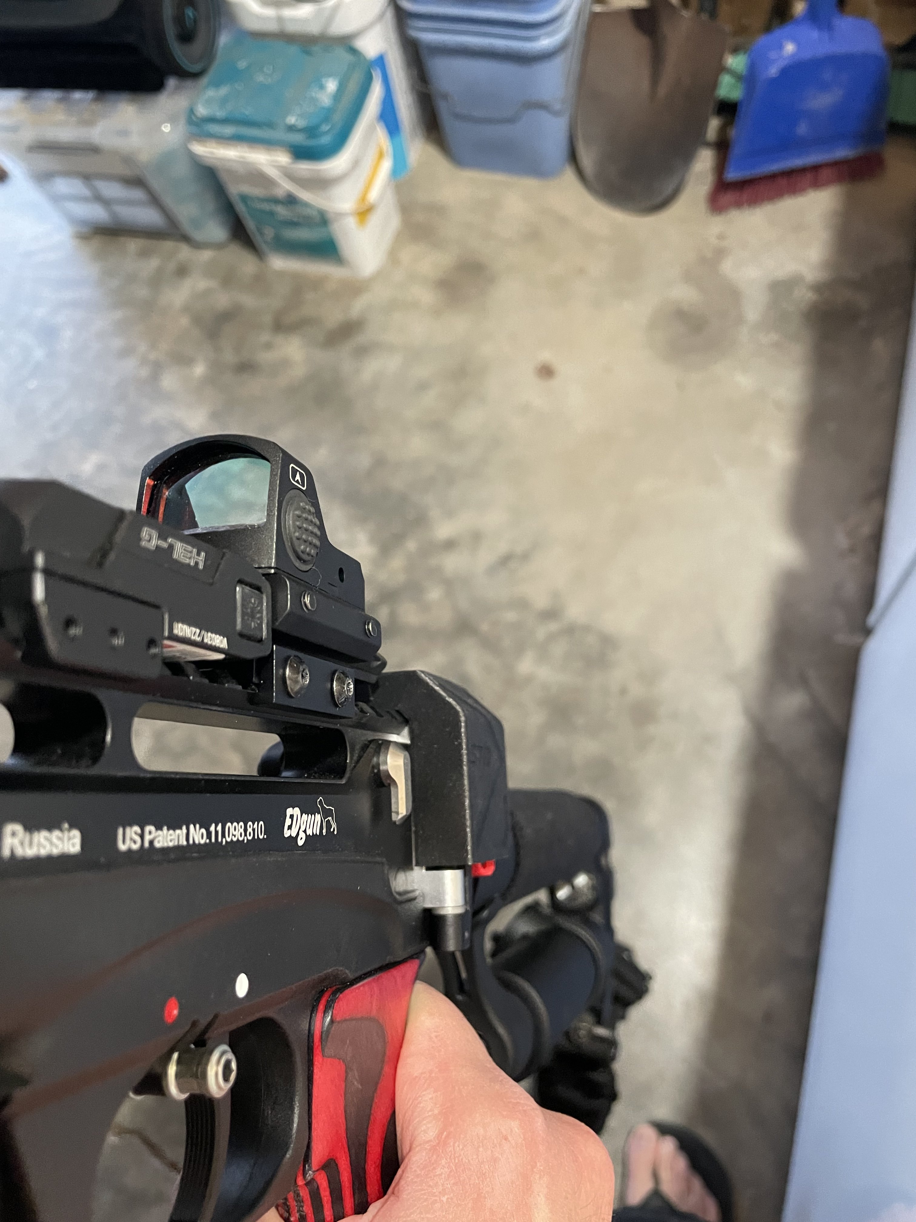

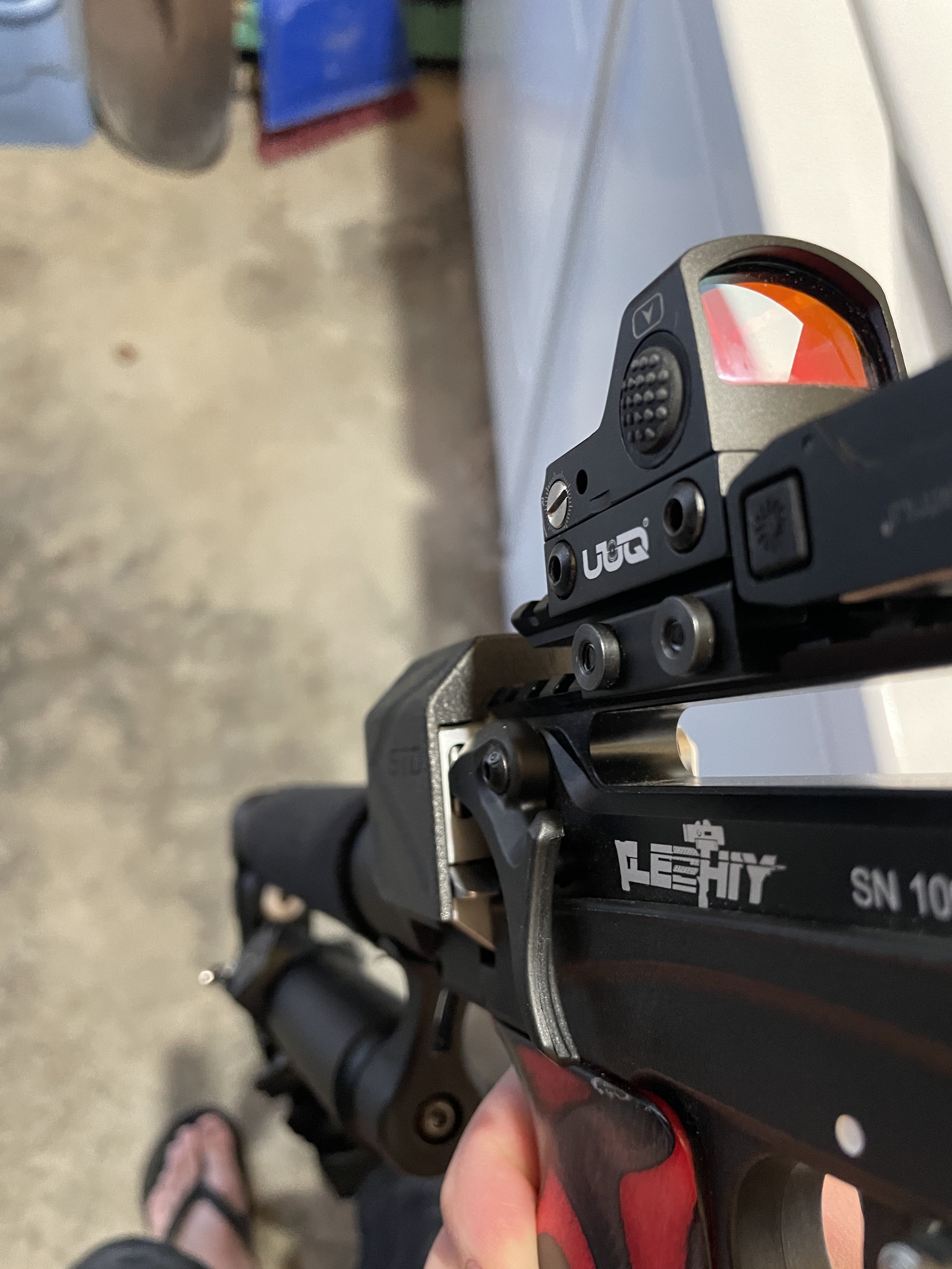

Sorry it took me forever. Hope this helps. For what it’s worth, I don’t think it helps that much. It was sort of a waste of money. The STO internals made a huge difference though.
What is that red dot quality? I just got one tube type feyachi rds-36 from Amazon to try if I like it...this is scary 1x view I got used to 32x and up...
STO internals?
STO internals?
The UUQ red dot was like $54 dollars on Amazon. It is a reliable and clear sight but obviously not the quality of an eotech. It holds zero and adjusts consistently but the dot has a weird shape when you turn up the brightness all the way. I haven’t tried it with a magnifier yet. I bought a new baffle stack/silencer core from Silent Thunder Ordinance. It made my gun noticeably quieter. The plastic piece that fits over the action made no discernible difference to me.
