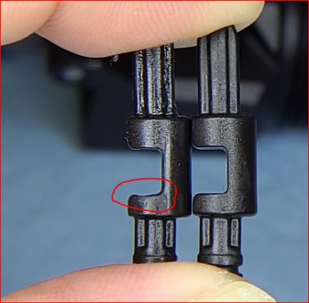

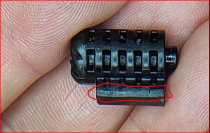

Thanks, this one Is doing my head in a bit now, stretched the new spring out today and exactly the same thing happened, worked fine for about 10 mags then starts playing up…and when it starts playing up it’s regularly failing to index, no point renewing the spring again until I get the bottom of what’s causing it to come out of spec so quickly
Take a closer look with a jewellery higher power lens ;)
(the piece on left side is worn, also the drum below)

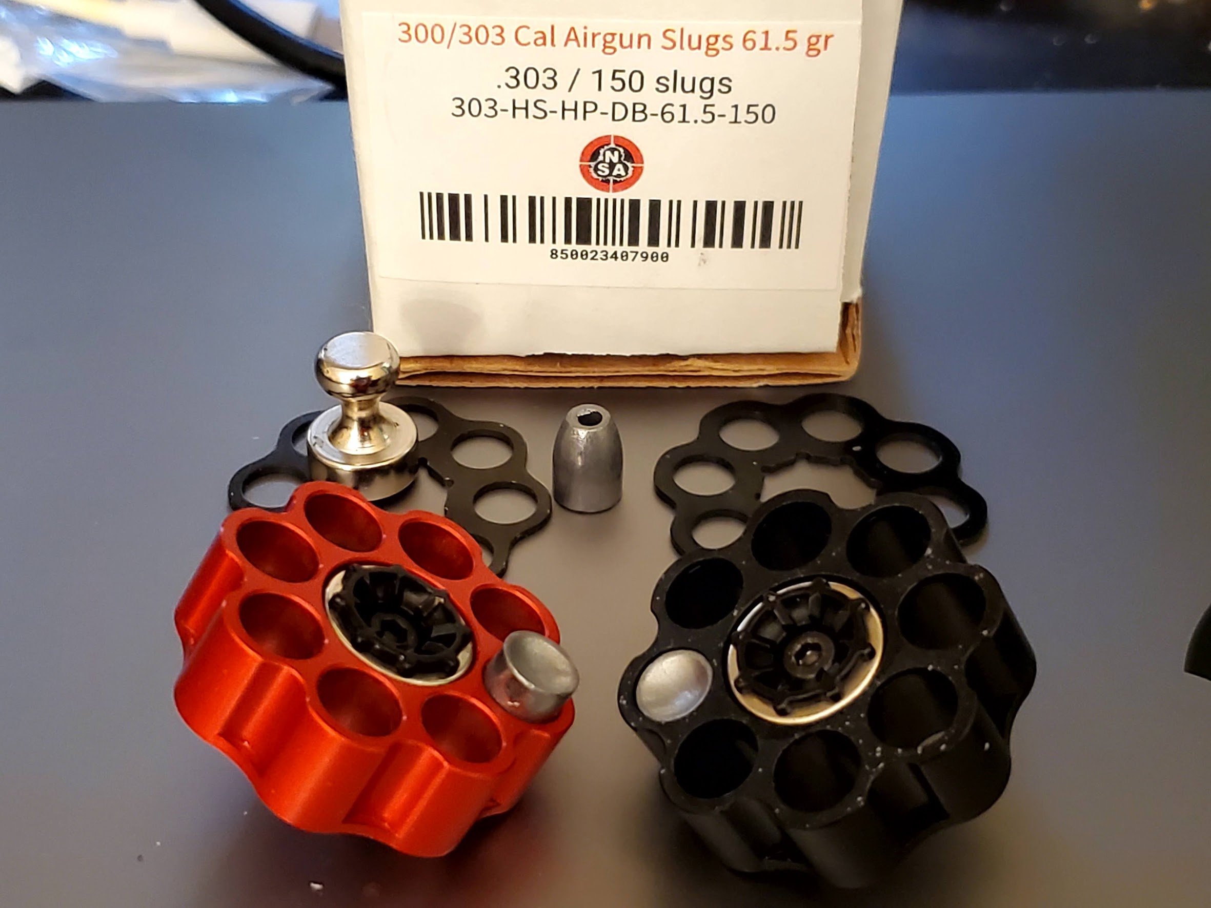

Regarding the slug suggestion, It make sense to size to the L2 bore. So are the poly mags tighter than alloy mags, but not a tight as the slug mags? IOW, would the 0.303 NSA slugs fall through the alloy mag but not with the poly mag?
Thanks for the response.
So would this adaptor not work with original L2 valve section bleeder port?
Right, I don't believe it will.
Poly mags have a larger "mouth" than the poly mags and fit and retain the .303 slugs nicely. Then the bore gets tighter, but since the polymer is somewhat elastic, it allows the slug to go through with little resistance and does not size it down as it pushes through like a metal mag would. The .303 NSA slugs do not fit the aluminum mags unless you hammer them in.
The slug mags are even tighter and are designed for .300 sized slugs that fall through the standard mags.
Original standard aluminum mag on the left, newer standard polymer mag on the right.
Yeah it's a mess. Bottom line, if you shoot NSA slugs, get them in sizes specifically made for the Leshiy 2, which is .219, .254, 303, and use standard polymer mags. With other manufacturers, all bets are off.

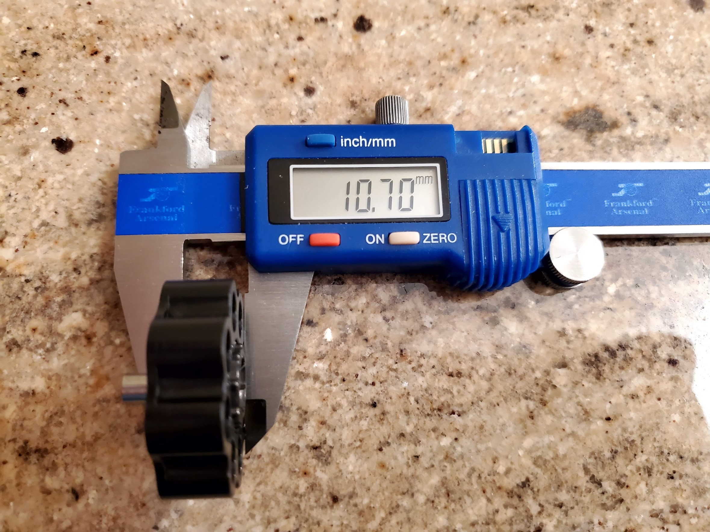

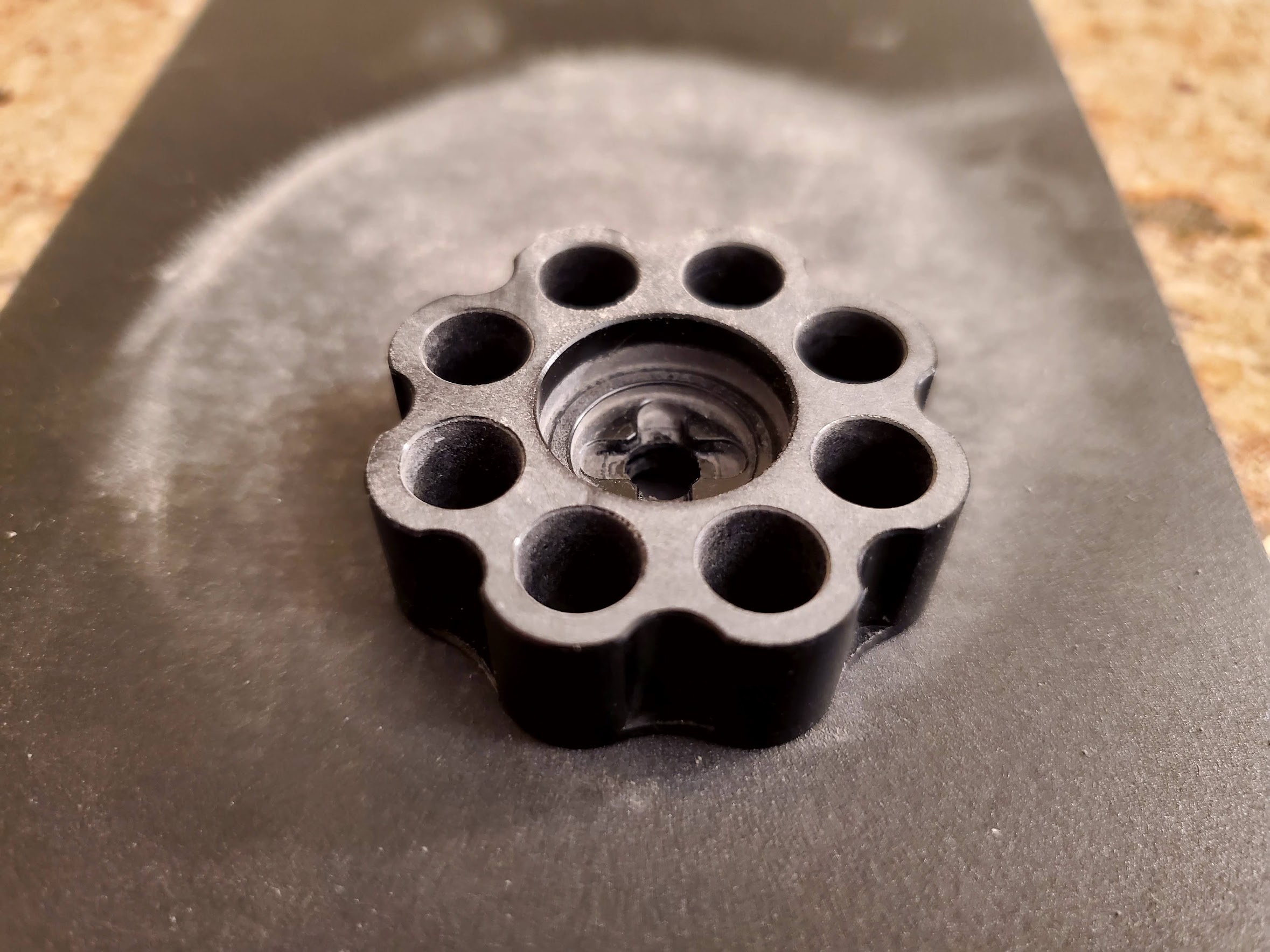

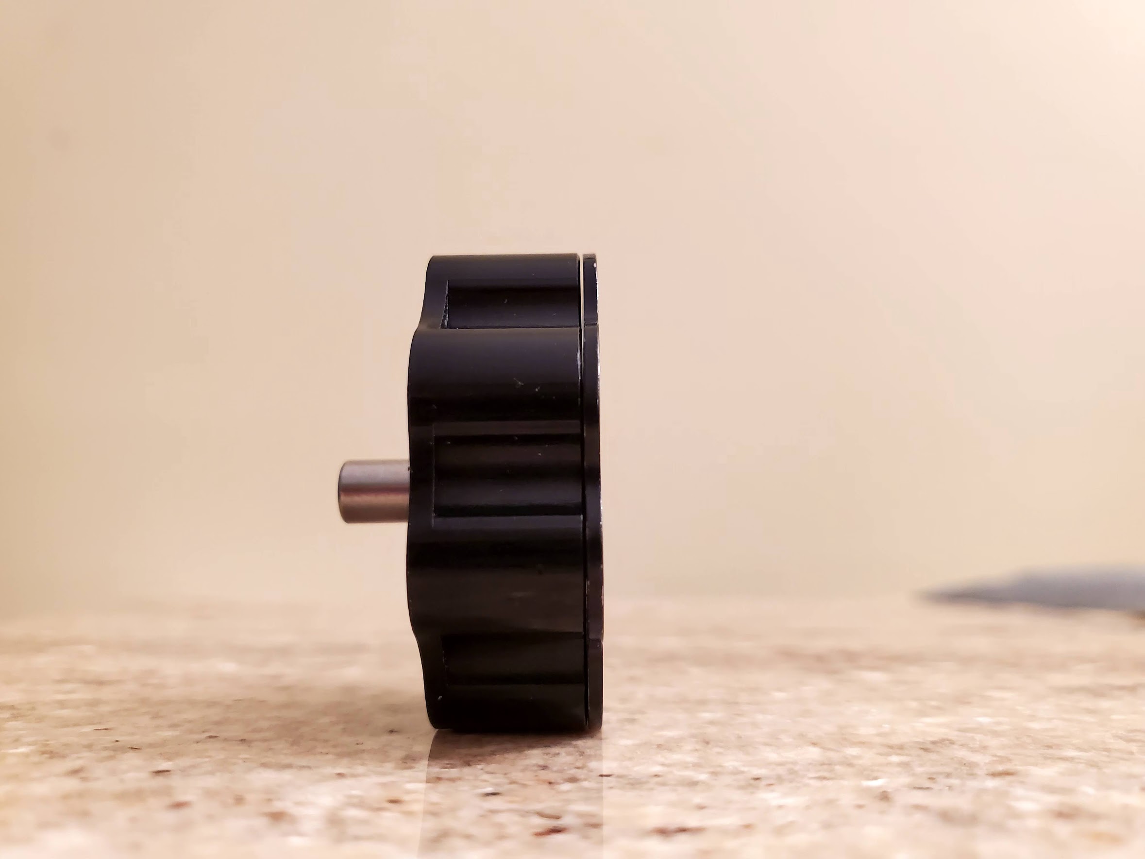

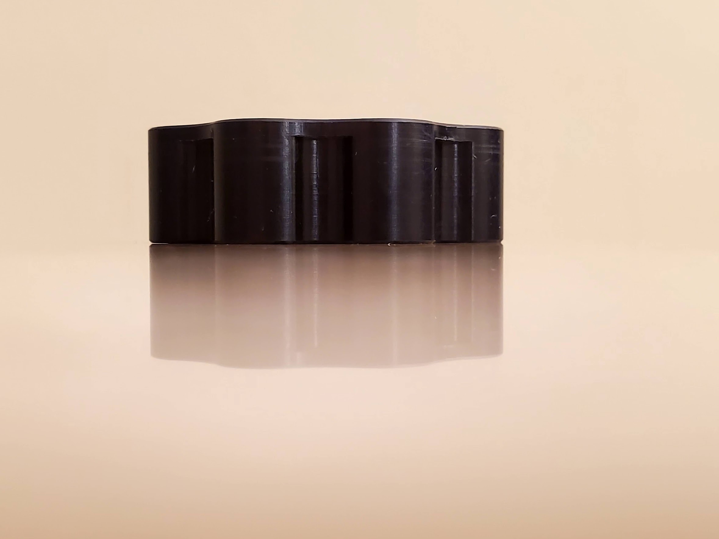

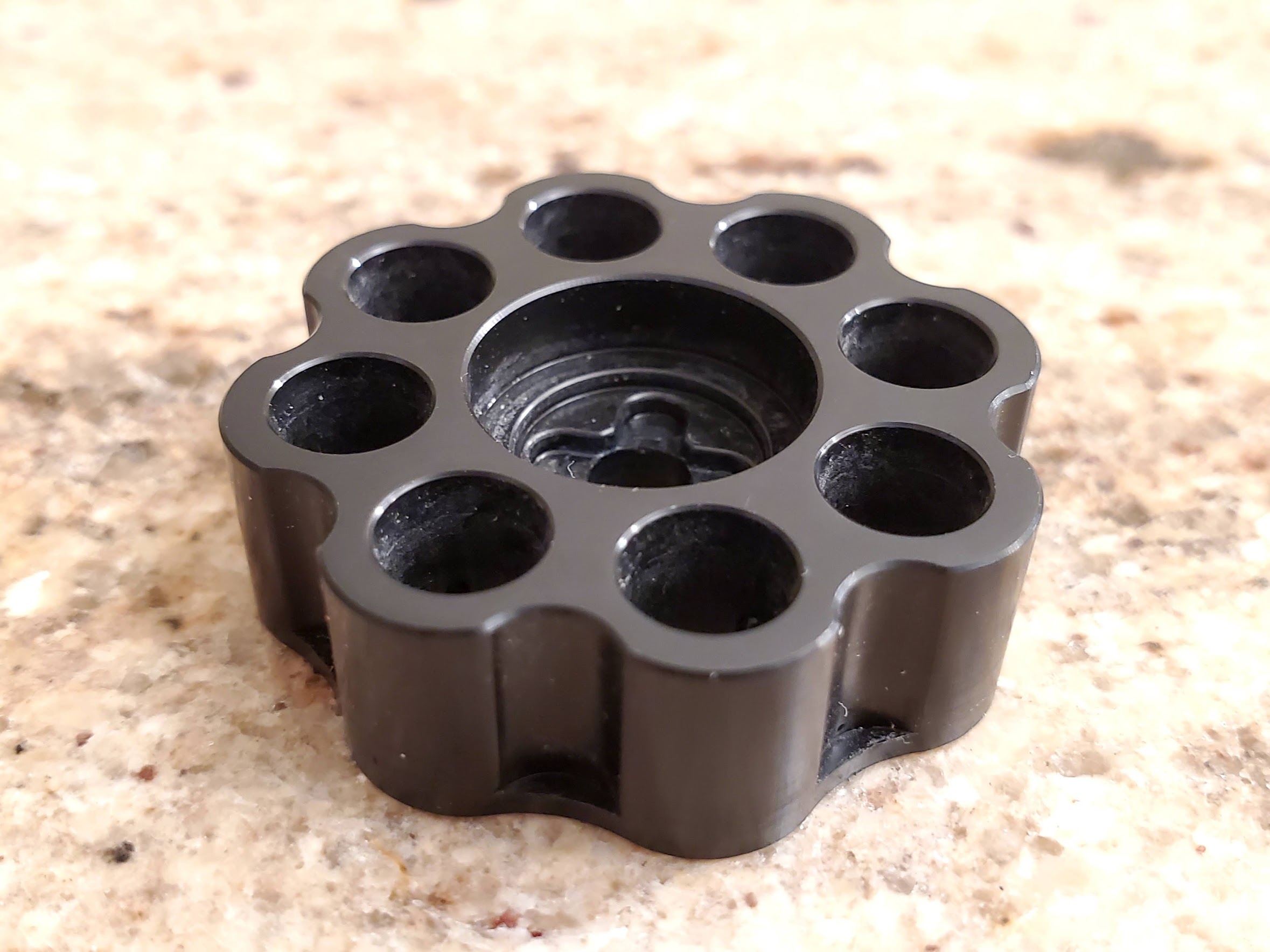

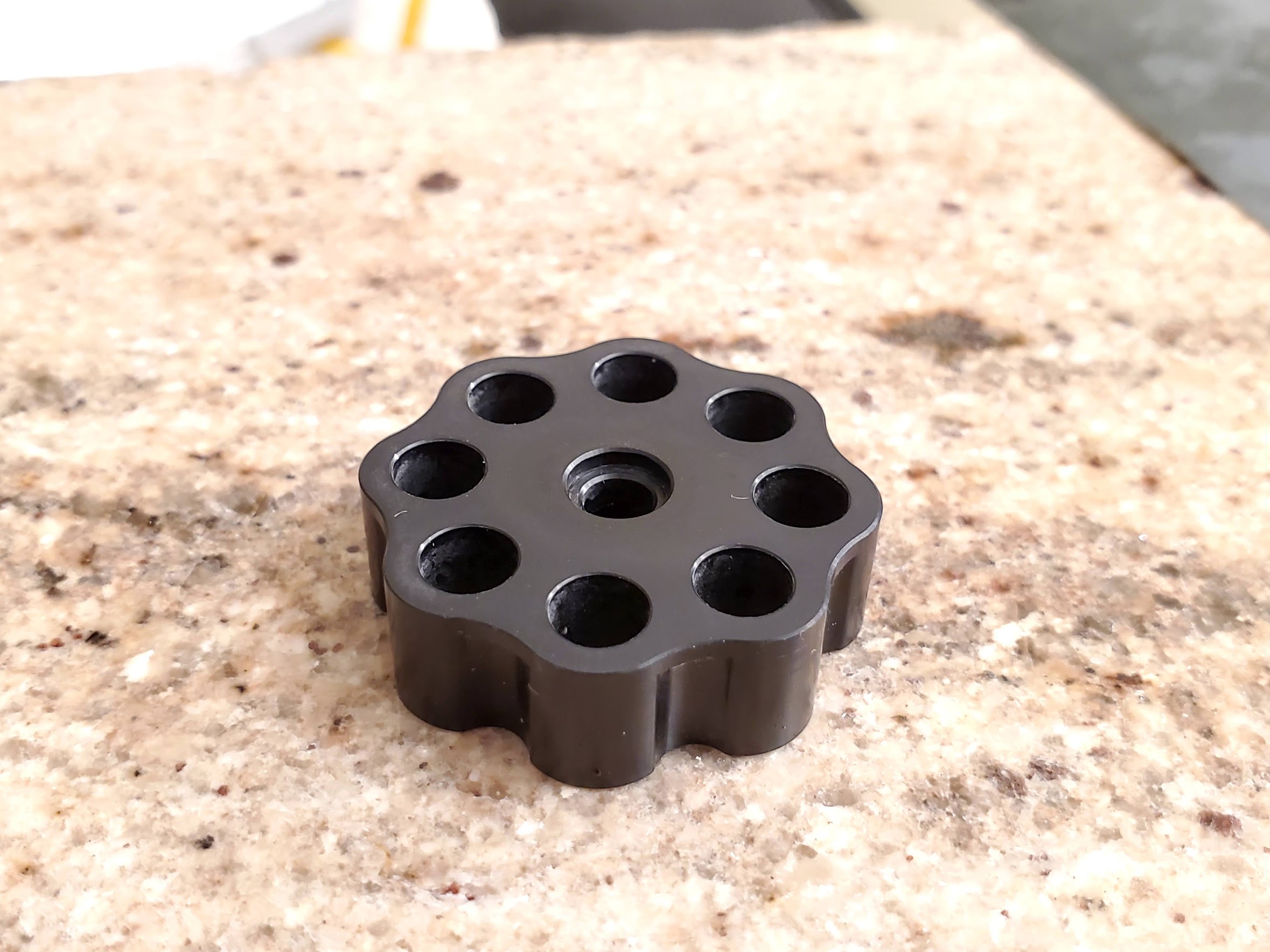

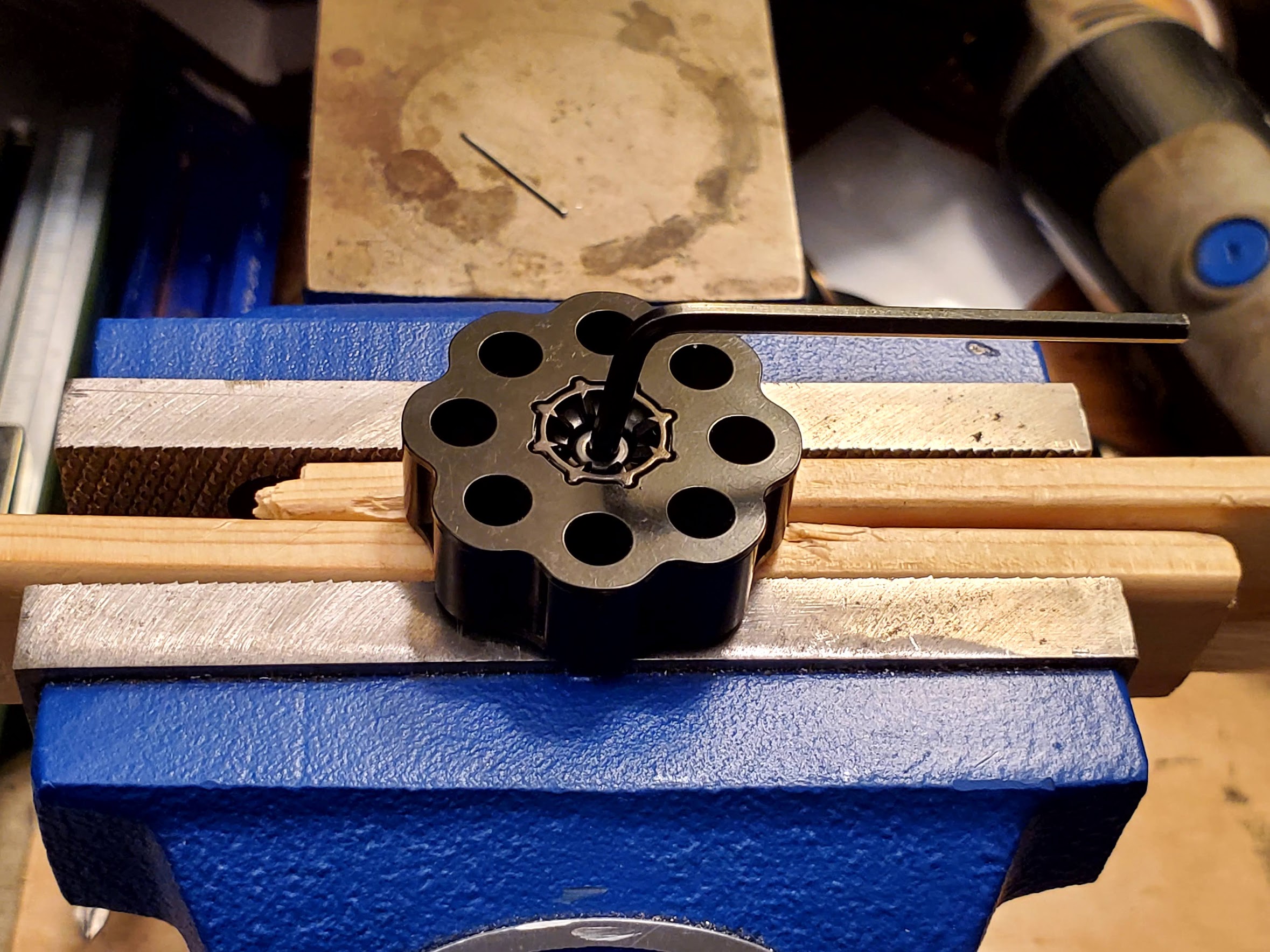

Do you have occasional cycling issues that you can't resolve? Have you checked your mags? With metal mags, a slightly bent back plate may create interference, preventing the mag from rotating freely. With the newer polymer mags, the mag body itself may be warped and cause bad fit even with a good plate and also catch on the face of barrel while rotating. Tolerances are tight, and even a small problem here may cause cycling issues. Obviously the plates are easy to replace, but the mag bodies need a little work to fix.
I've encountered a few problematic mags in different calibers, this is what I do to fix them. All cycle flawlessly now.
Tools needed: a perfectly flat surface, 800 and 1500 grit sandpaper, a 2.5mm allen key, and a vise.
Hope this helps someone.

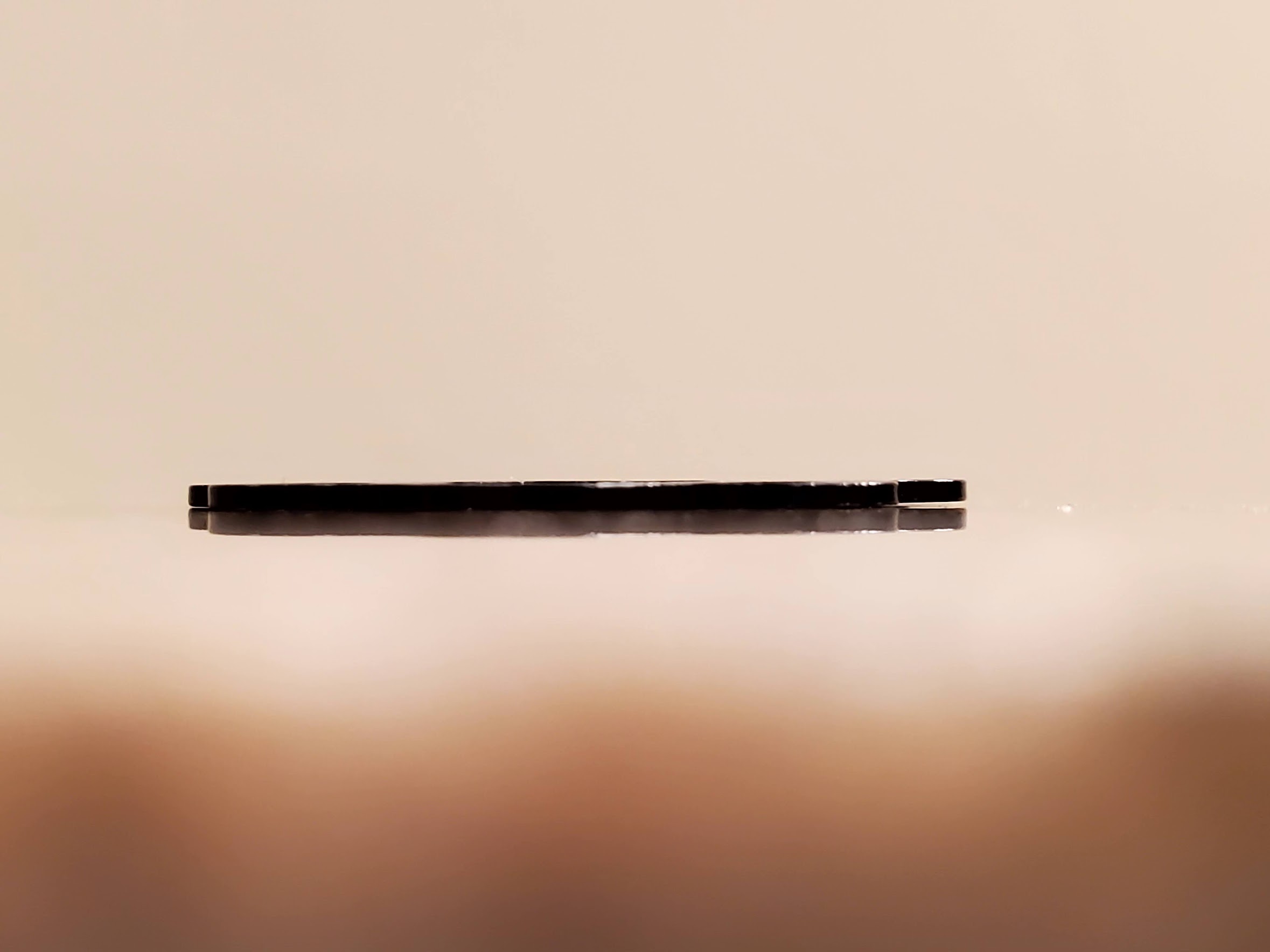

Checking for plate gap
A bent plate

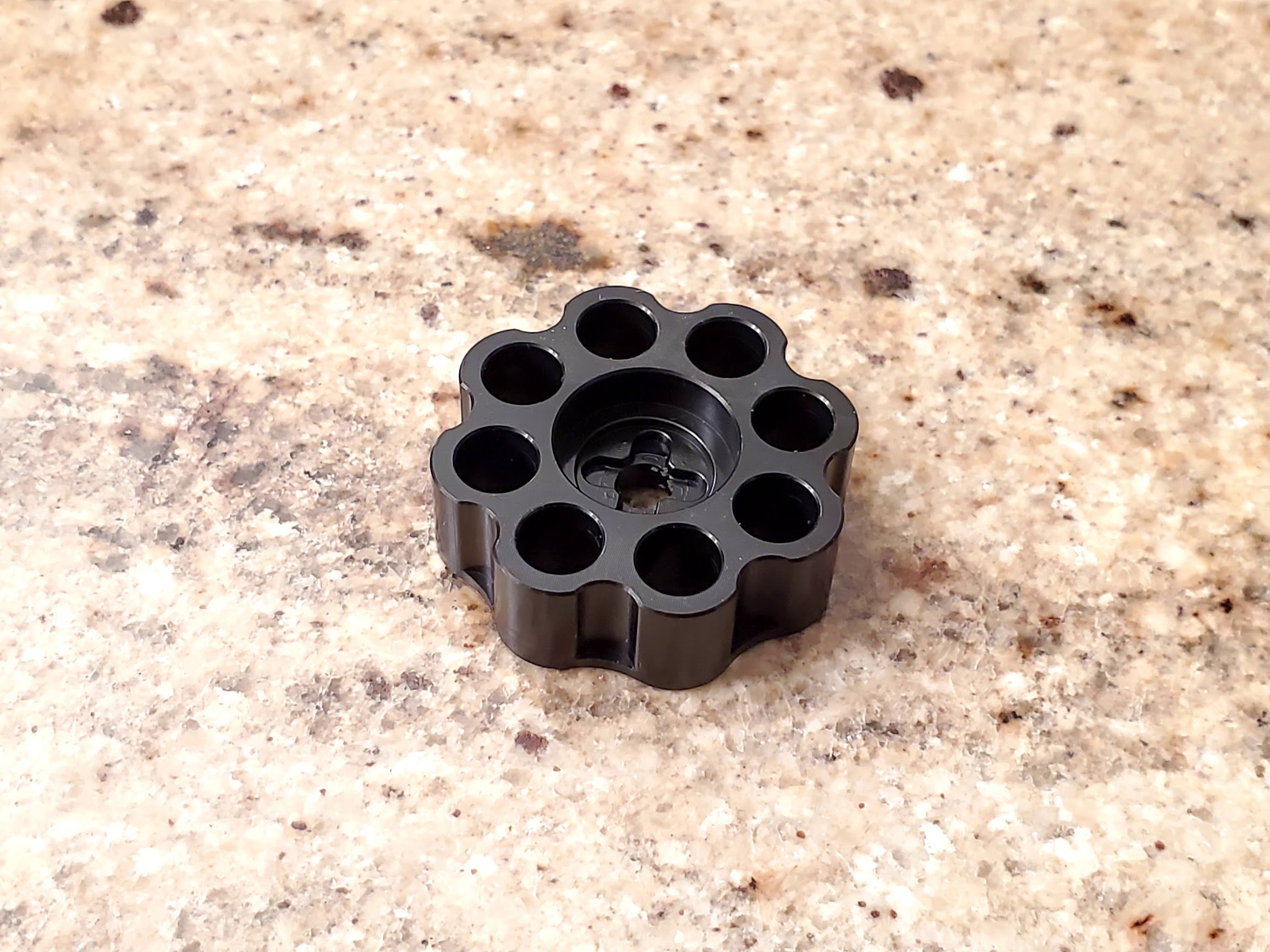

Disassembling for inspection
Mag body
Yep, a warped mag body. This is actually not too bad, I've seen worse.

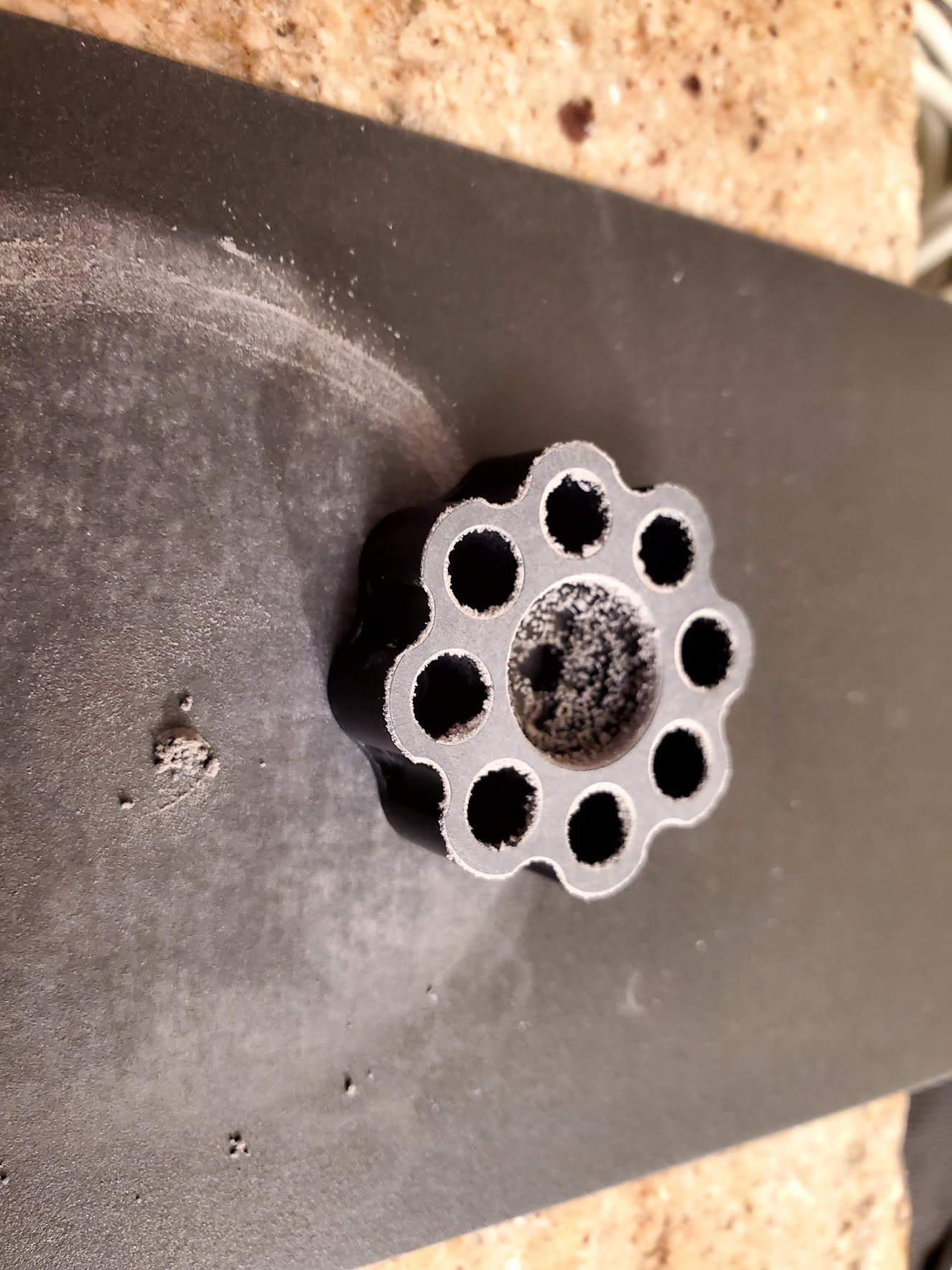

Sandpaper to the rescue...

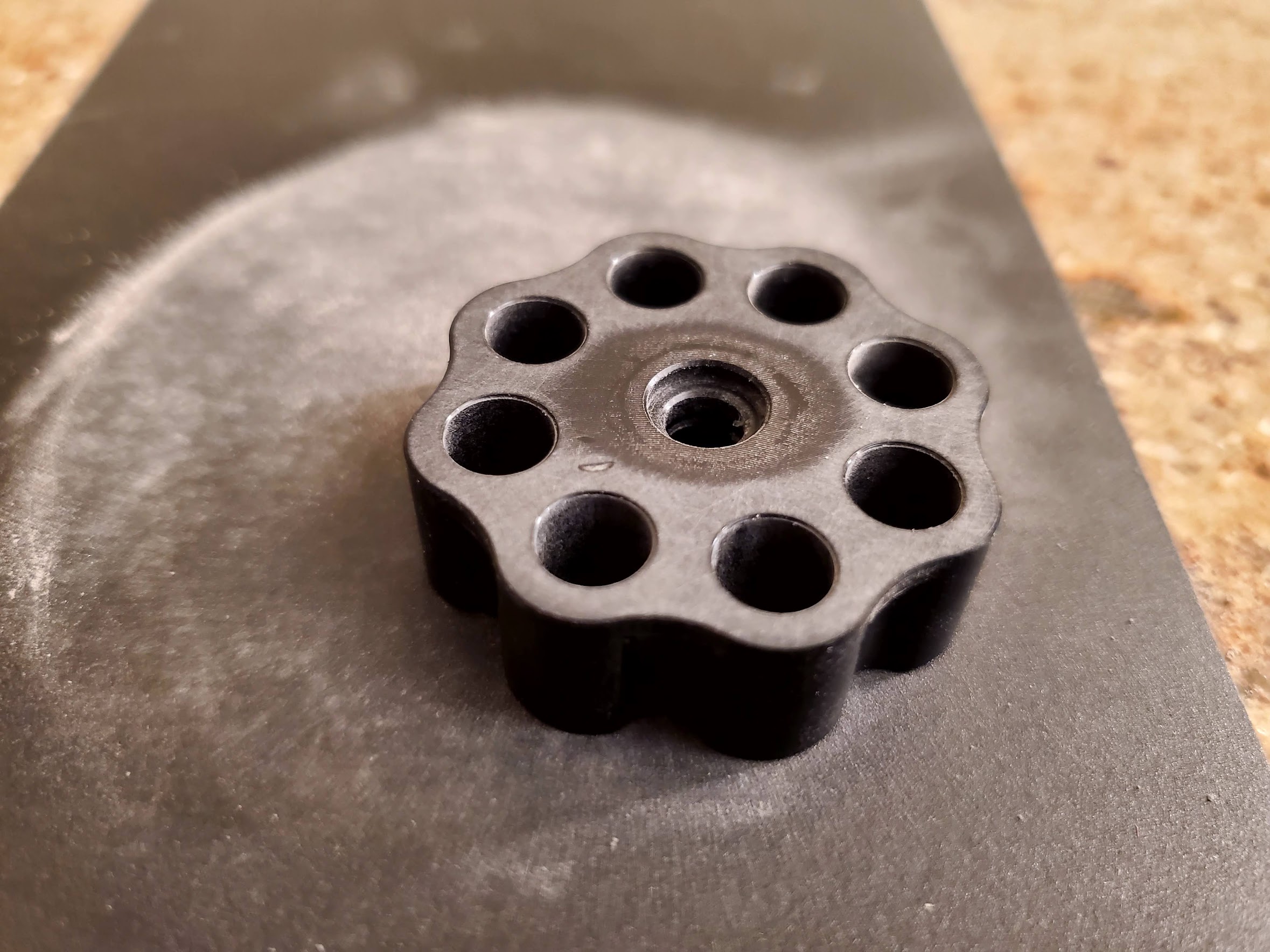

Carefully sanding on a flat surface. You can see the high spots being sanded away as you progress. Finish with 1500 grit sandpaper.
Cleaned up
Perfect fit (with a new plate)

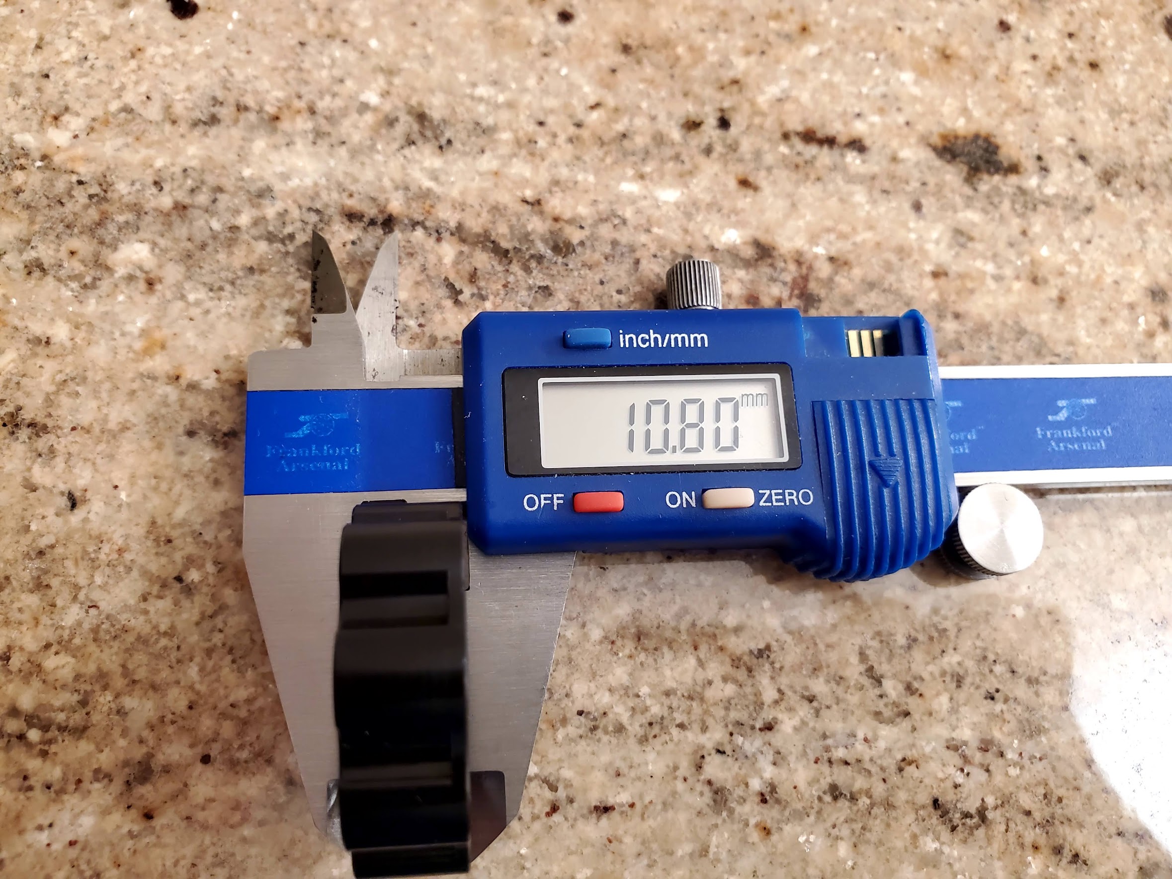

Thickness before:
Thickness after (total 0.1mm of material removed)
I particularly like the before and after micrometer reading. Good job.

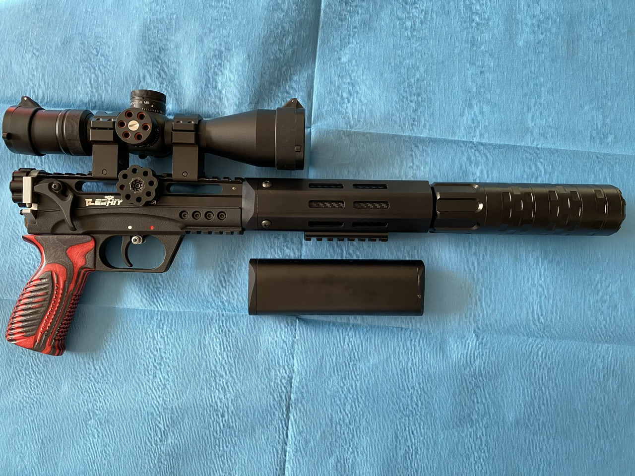

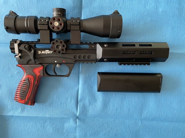

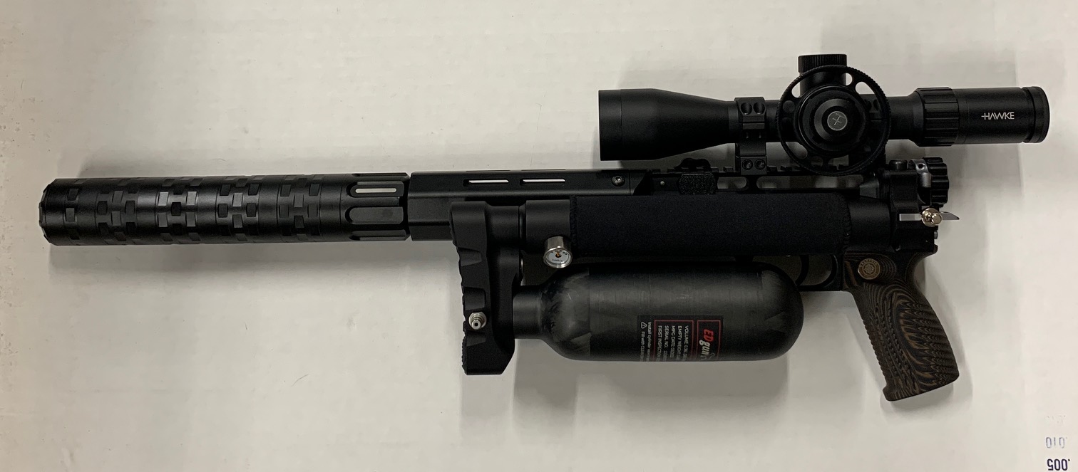

I can't answer all your questions but I recently purchased and L2 in .22 350mm with Behemoth moderator. Full length of the rifle is 38", folded with the moderator 28" and with Behemoth removed it is a mere 18". Now this includes the extension of the scope off the rear when folded. So that is a determining factor in folded length, see top pic. Without the scope the folded length is 15". I was able to get my folded L2 into a Pelican 1605 Case.
I can tell you that with the Behemoth off this rifle is about as loud as a PB .22 LR, with the Behemoth on it is backyard friendly.
I am pretty sure there is a carbon fiber M-Loc handguard that will work with the Behemoth setup. Best bet is to talk to Brian at Edgun West, he is quite knowledgeable in all things Edgun.
View attachment 372678View attachment 372679
That's the reflex Behemoth, correct? Since the reflex part acts like an air stripper, do you sense any sound or air movement from it since it's pushing are back toward the shooter? Thanks.
Reactions: tnbndr
Yes, it is the reflex Behemoth per Edgun ad. I do not perceive any sound or air movement from the Behemoth. I believe that it is pushing air backward but it is all contained within the Behemoth sections.
The only air sound detected is the bit that is used to rotate the magazine.

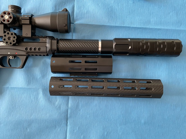

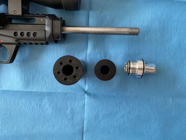

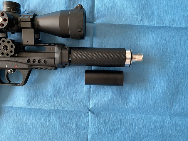

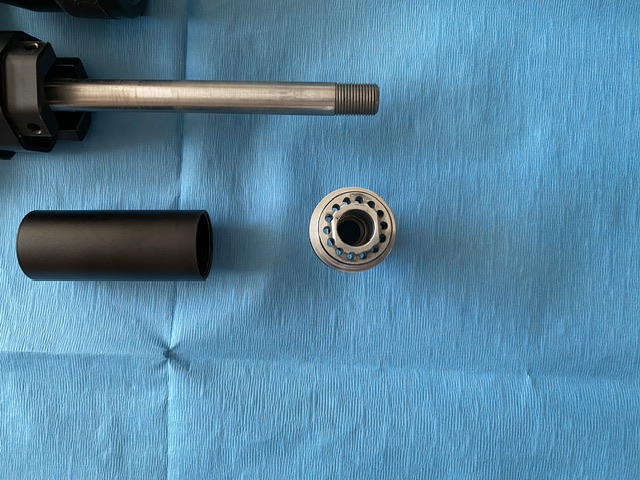

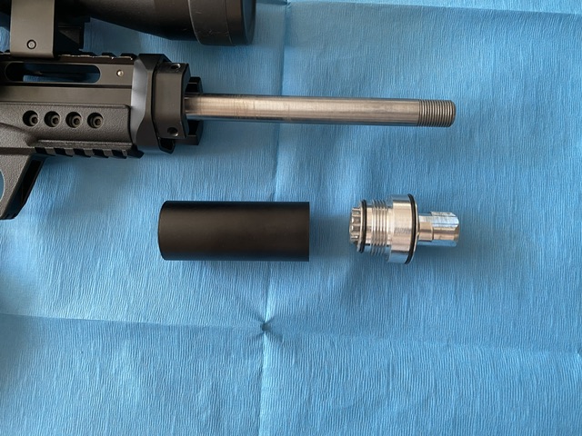

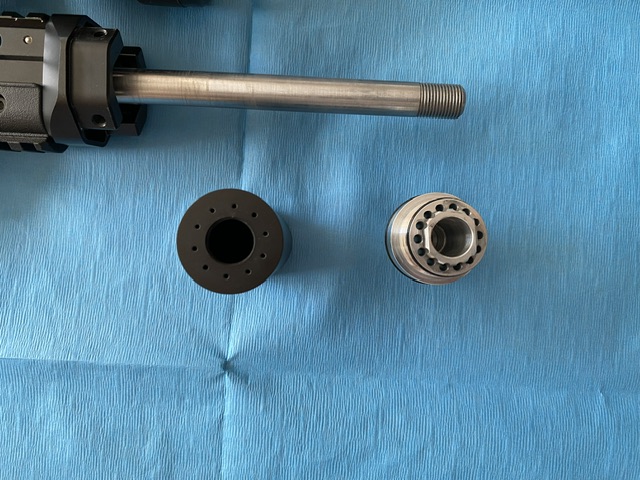

I’ve been thinking for some time now about upgrading my stock L2 250mm setup with STO insert to a 350mm setup, but have so far not been a fan of increasing the length of the gun when folded with the 350mm shroud. Now with the a quick disconnect Behemoth, it might make sense to go with a 350mm barrel with hand guard extension and get the roughly the same folded length as the stock 250mm, when the suppressor is disconnected. Has anyone else gone this way and can share details?
Also, a 350mm barrel would allow going with the reflex option, though it has not been clear if the reflex shroud really adds to suppression. Had anyone baked off tri-lug vs. Reflex that can share details?
Also is there a carbon fiber version of the m-loc handguard extension that can work with the 350mm setup for the Behemoth?
The Behemoth reflex shroud does add suppression as you can see from the photos below when I open up the reflex shroud. Unfortunately the 350mm reflex shroud is kinda short so I made longer and bigger diameter shroud to replace the factory shroud which add to the initial discharge chamber for the Behemoth moderator. This dropped almost an additional 5db on my sound meter during testing with the meter mounted on a tripod 12ft away.
As for the CF handguard at the time of this writing I don’t believe Edgun has a CF handguard for the Behemoth reflex. The Valkyrie CF handguard for the 350/450mm barrel is too long for this setup since the Behemoth moderator can’t fit inside the handguard.
